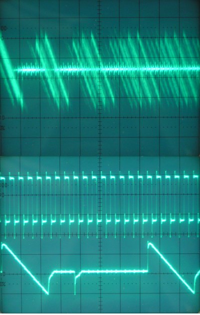

Except one nagging issue remains: Some noise (distortion) on music (audio) when recorded level is low (quiet passages, fade-downs, start of fade-ups). When audio level moderate and above, music is clean ( low-level noise is probably still there, but masked by music. It's almost like "dirty dither").
Most of your troubleshooting suggestions are been-there-done-thats: Freeze-sprayed all ICs, etc. No change. Swapped TDA1541A and SAA7220. No change.
It might be the SAA7310 decoder (or something close to it). Or it might be uP chip. Haven't swapped those. But if those LSI multitasking chips were faulty, many other CDP systems (processes) would be affected. Right?
BTW, the eye pattern looks very good:
Offline 13hm13Topic starter

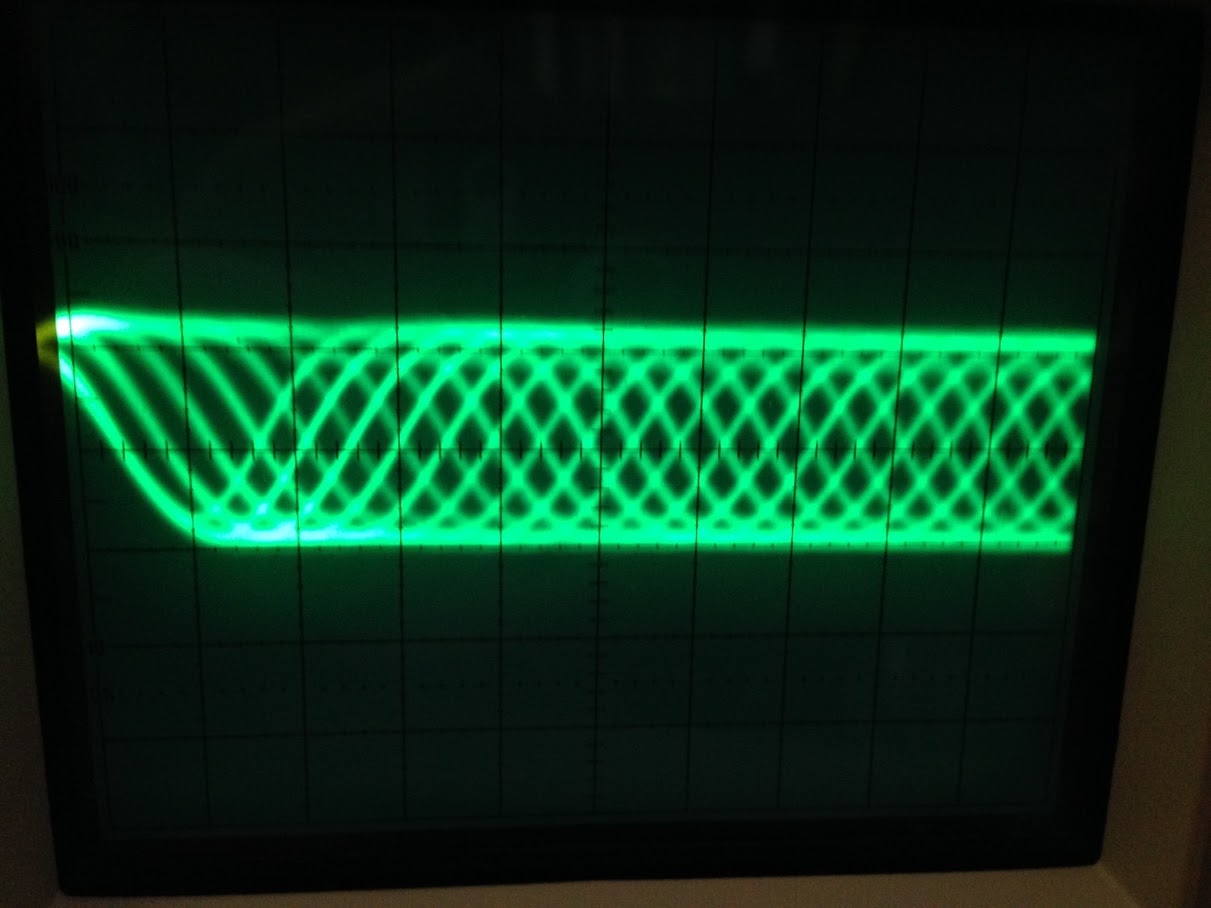

I guess it's possible that there was some damage to the DEM oscillator. It's an emitter coupled multivibrator, biassed by current sources (all of the logic is ECL). Possibly the biassing may have been damaged by an accidental short to one of the supply rails, but not enough to stop the basic oscillator working with the pins just capacitively coupled. I think the TDA1541 was capable of running on an on-chip capacitor, whereas the TDA1541A moved to an external capacitor for greater stability. Philips included the capacitor footprint on all the PCBs for compatibilty, the same way as they did with the connection of the removed the 'System clock' function on Pin 4 between the two versions.
With just the cap, you should be able to scope the DEM pins (use AC coupling) to check for the characteristic multivibrator waveform - hopefully still symmetrical, pictures in the DIY Audio thread irrc. I know from the thread, and personal experience that it is quite tricky to get reliable external override of the DEM clock. From my results it does make a difference, but over the years I've struggled to  decide whether difference is 'better' or just 'different', the problem with all subjective things.
Been there, done that a week ago ;) With just the cap, I 'scoped it:  waveform does look exactly like DIYaudio posts by ecdesigns:
(top image is cap; bottom is outboard DEM)
