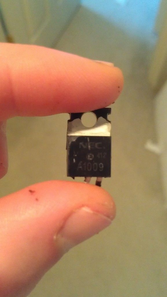

Got a couple of SSRs off of ebay recently, since it was the only place I could find DC SSRs. Fotek, rated for 40A, undoubtedly counterfeit, but I took a chance on it being a quality clone. However, they arrived in extremely poor packaging and one was quite banged up. I tested the other and it burned out in seconds while switching 15A (rated 40) despite being hooked up to a properly sized heat sink.
The seller is offering a replacement. Naturally I wouldn't ever use those without thoroughly testing them first, but I was wondering if it's even worth giving it another try. Thus I took one apart and uncovered the power FET to check its rating, but I can't find anything of the sort online.
It says NEC on the first line, 412 on the second, and the part number on the third line is A1009. Does anyone have any idea what this FET is and where I could get a data sheet?

According to the marking this should be 2SA1009 PNP transistor. However this is strange, SSRs usually are triac based.

Bit of a hunt but it seems to be: 2SJ412, TO-220, P Ch 100V 16A  :-//
If that's it, it's rated at 2A I believe... Pretty unbelievable to use it in a 40A SSR. I believe AC control SSRs are triac based, while DC ones are power FET-based.
Out of curiosity, what on the markings implies that? That would be better than the 2SA1009, but still well under the rating.
« Last Edit: April 18, 2015, 01:16:14 am by anvoice »

2SJ412s don't come in that package.
This is most likely 2SA1009, maybe even a fake version of it as some of them have the "A1009" on the middle row and some on the bottom:
http://www.taobao.com/product/2sa1009.html
http://item.taobao.com/item.htm?id=44824285937
The one in the second link looks identical to mine. I can't find its characteristics since the page is all in Chinese, but the title seems to imply it's supposed to be an equivalent to the 2SA1009. So the verdict is they used a FET rated for 2A in a 40A SSR? I think refund it is.

The device itself was an SSR: I had to take it apart to get the FET (which is a part of an SSR).
Not sure how you came to the conclusion that I was happy with it. I was merely getting straight the facts: the SSR is under specs. Thus, I'm getting a refund.

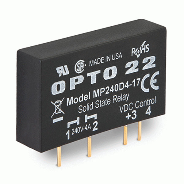

huh? you can dismantle an SSR to get a PNP inside? well thats new! i thought SSR is "solid" like this...
and you keep talking about "FET" but what you showed is PNP. PNP is not FET, so i guess the main driver is the "FET", usually FET is more powerfull than PNP, so i guess the 2A PNP you showed is for driving the FET gate, well, thats an overated 2A gate driving PNP, thats quality! i think its a good idea to post the whole picture.
