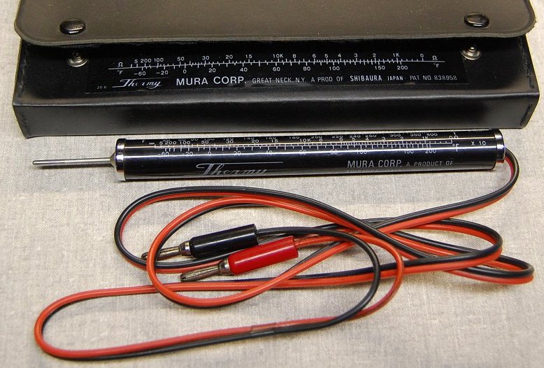

I found this a few months ago.  You don't need a temp option on your DMM or analog meter.  Just convert the ohms reading on your meter to the temp (F or C) listed on the conversion chart on the side of the probe.  It does work and it's pretty close.  Cost in 1973 was $12.50 U.S..

SLJ, I think what you have there is "just" a Thermistor - a temperature dependant resistor element. It produces a change in resistance, not a voltage difference, when heated. the relationship between the resistance and temperature is either non-linear, or certainly not "convenient" (i.e 1 ohm per volt or similar), so it needs a scale to cross-refer the resistance to a temperature.

Yes,  as I stated there is a conversion chart on the side of the probe (ohms to F or C) and a larger paper chart in the case.  Not as accurate as my 87V and it does not have the temp range but I found it to be an interesting item.
Here's the chart:  http://www.stevenjohnson.com/data/thermy.pdf
