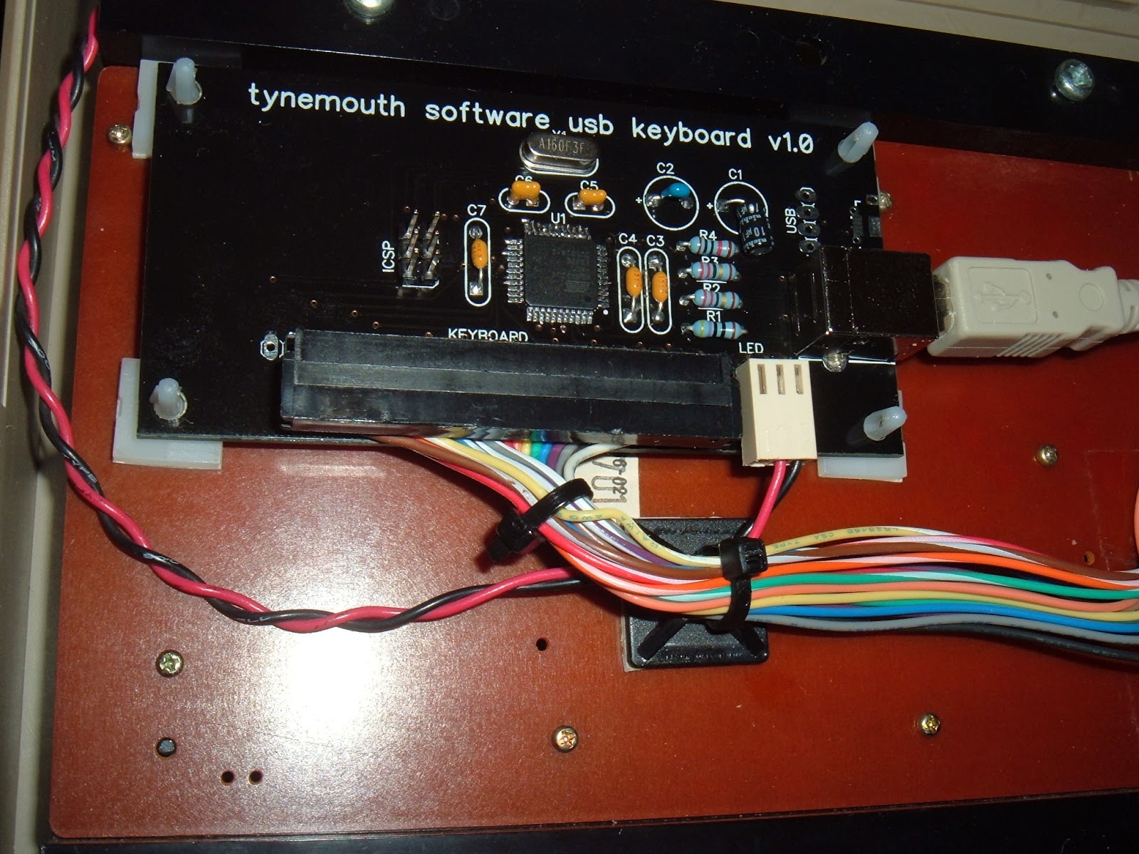

I love these old computers, so when I get one like that which is not going to work again, I convert them to USB keyboards. I've done many of these, details on my blog. I initially used ATMega328P microcontrollers (ala Arduino UNO), then moved onto Arduino Lenoardos
http://blog.tynemouthsoftware.co.uk/2013/05/zx-spectrum-usb-keyboard.html
Lately, I've designed a PCB for this for some of the larger keyboards (such as the Commodore 64), which is basically an ATmegs32U4 breakout board.
http://blog.tynemouthsoftware.co.uk/2013/12/usb-keyboard-pcbs.html
There is also just about enough space to stick a Raspberry Pi in there as well, if you're that way inclined.
http://blog.tynemouthsoftware.co.uk/2013/11/zx-spectrum-raspberry-pi-case-mode-usb.html
I can stick a PCB in the post to the EEVBlog lab if you're interested in converting that spectrum.
I also have some for sale on Etsy, if you don't want to do it yourself.
https://www.etsy.com/uk/shop/TynemouthSoftware
