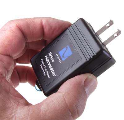

BTW ... the "audiophile" world has been using these types of products for decades. E.g., PS Audio calls 'em Noise Harvesters...
Similar "audiophile" devices include stuff on the right-hand side of this page under "Other Items of Interest":
http://www.musicdirect.com/p-7419-ps-audio-noise-harvester-in-black-ea.aspx
Including the $200 SHUNYATA - VENOM DEFENDER, and the $40.00 AUDIOPRISM - QUIETLINE FILTER MK3, and the $350 QUANTUM - QV2 AC LINE HARMONIZER.
Save your pennies, audio-fanboyz.
