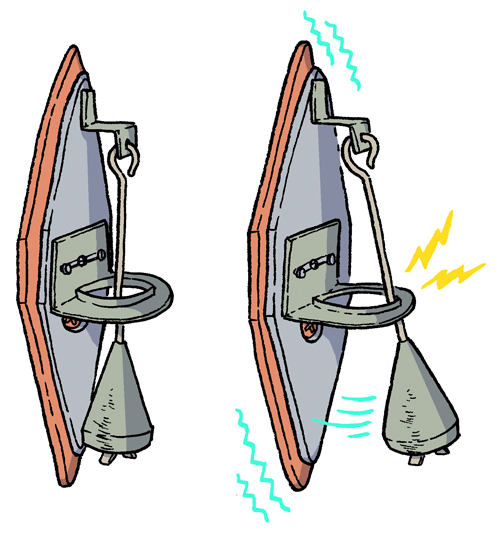

equally yes the article specifically mentions tilting the device, so it would probably be something like a low pass filtered gyro, and when it has been tilted past a certain amount from static (when the code was entered) for a certain amount of time it locks
Could it be something as simple as a tilt bob on a pinball machine?  Although those don't exactly work when the device is unpowered.
Just add a battery and cover it with epoxy.
