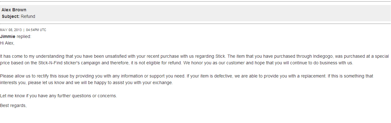

Asked for a refund for their shoddy product, got this reply:
pic.twitter.com/nZrkkg0Emw

This mob are a pack of crooks.
I doubt they intended to rip you off. The design looks viable, but it seems like they chose a manufacturing house that was incapable of building the devices with a reasonable yield. Bluetooth requires a fairly high degree of precision (e.g., a 20 ppm oscillator) and shoddy manufacturing throws that out the window. They probably didn't use any assembly line tests to see what was being built and just hoped that what they got back from the factory was ready to sell.
They probably didn't have enough cash to fix the manufacturing problems and do another run.
