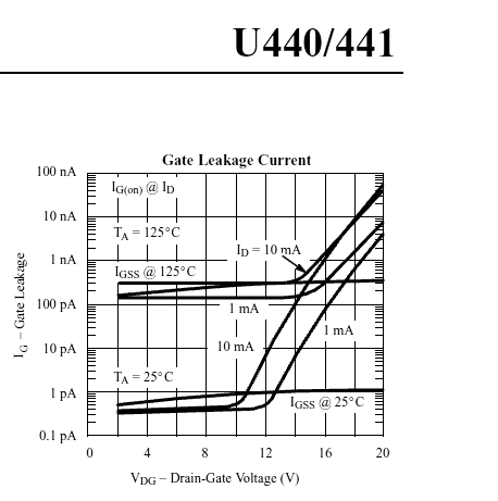

By a coincidence i just went through "The art of electronics" 3rd edition reading on JFETs. The autors do not recommend using JFETs at high source-drain voltage (which your circuit is) because above a few volts gate current raises dramatically, by several orders of magnitude. I'd imagine this may have effect on this circuit out V drift, and make it dependent on the primary regulator output voltage which is the JFET input. But im not good enough with JFETs yet to say for sure. Anyway, something you may need to have a look at and perhaps to test.
By a coincidence, I knew about that nuance of JFETs probably before the first edition of "The Art of Electronics" was published (was it what, 1980? - yes, I am that ancient  :( ). Also (not by a coincidence this time, but as a normal design practice), I tend to look at datasheets of devices I plan to use before actually using them. And in the datasheet for the U440 you may find the following diagram:
And I also have in my library an old catalogue from Siliconix where one can find the same graph for the J112 device (and the gate current for it  starts to increase substantially only for Vds over 15V .
Cheers
Alex
P.S. for 1ppm effect you would need the gate current at about 1-3nA ( for 1-3mA drain current), by the way. Look at the graphs. Even at 125C and 10V the gate current does not reach that level.
« Last Edit: October 06, 2015, 05:11:47 pm by Alex Nikitin »

Supposedly zero tempco for a JFET is near the pinch off voltage plus 0.63V.
There is a 1973 US patent (long expired now)  3,760,199  that details a manner for determining a compensating voltage for biasing any JFET into it's 0-tempco region.  The goal of the design in the patent was to determine Vp, the pinchoff voltage, at any temperature, and a compensating voltage Vc, such that Vgsz, the gate-source voltage needed to bias the JFET at its 0-tempco region was Vgsz = Vp + Vc.  Since Vp, the pinchoff voltage is temperature dependent, then he develops Vc = 0.64 + a temperature dependent part opposing the tempco of Vp. With proper placement of some PN junctions and some BJTs and resistors, and a little bit of KVL, the inventor develops a voltage loop involving Vp, Vc and 0.64 and places the second JFET's gate-source across the point where those voltages are summed, yielding Vgs = Vp + Vc + 0.64, without ever knowing what Vp was (so it can vary with the standard process variations).  The second JFET will now have this temperature compensated bias voltage applied to it's gate wrt source and develop a nearly constant drain current that is, for the most part, temperature independent.  Very Cool!
It's an easy patent to read and a good one too. I think it was intended for use at chip scale, so that all the elements are matched and isothermic.  It might not work with discrete parts if someone were to try it out.

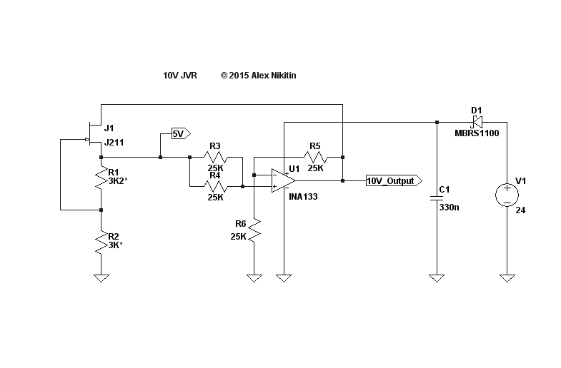

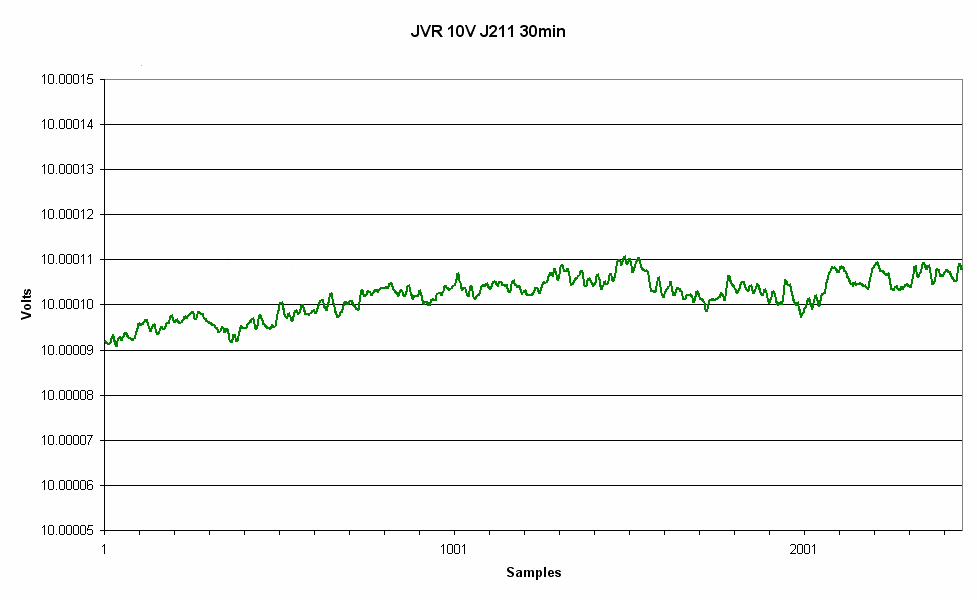

« Reply #48 on: October 11, 2015, 02:37:55 pm »
OK, let's not get all this popcorn wasted  8) .
I've decided to try a very simple circuit to get 10V output and to use the J211 transistor as a reference. This is a "budget" solution, as it requires only two good quality resistors (R1 and R2 and I've used 15ppm metal film for that, "padded" to the required value by some standard 100ppm/C resistors, so I should not expect much better performance than this value), cheap J211 JFET and an inexpensive INA133 chip connected as a gain 2 buffer with low tempco (~2ppm/C). Altogether is less than £10 in parts (resistors R3-R6 are internal for the INA133).
Here is the circuit which I've assembled on an old piece of a pcb:
And here is a 30-min run on the bench (vertical scale is 1ppm/div):
My estimate is that the temco around 23C is indeed about 10-15ppm/C. The power supply voltage variations from 12V to 28V create less than 2ppm/V change.  The load regulation is better than 0.5ppm/mA (a conservative estimate, as a load current up to 5mA, sink or source, creates less than 1ppm voltage change). The supply current is about 2mA.
First R1 is selected for the lowest tempco and then R2 for 10V output voltage.
Cheers
Alex
« Last Edit: October 11, 2015, 03:42:55 pm by Alex Nikitin »

I've seen this schematic some days ago in the LF355 datasheet, it made me think about you! Your idea is not new.
Thank you, I always thought that it was used before but couldn't find a confirmation!
Cheers
Alex
P.S. - would be interesting to find if that circuit was used somewhere in practice!
P.P.S. - The 2N4118 has a very low drain current (around 100uA for near-zero tempco) - it should make it good for low power but fairly noisy as a reference. A higher current device would make it a very low noise option - much quieter than ~1ppm p-p LF noise of the LM399.
« Last Edit: October 11, 2015, 07:23:46 pm by Alex Nikitin »
