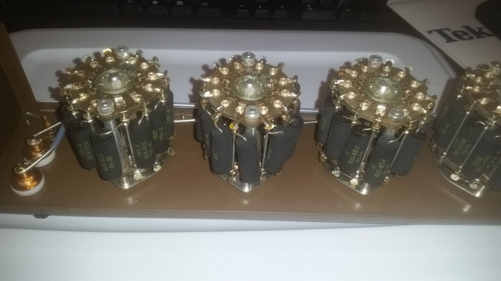

« Reply #4 on: September 26, 2016, 03:16:15 am »
That makes sense. I can set all the dials to 10 and then add the resistance that causes all of the decades to be 1/10 of the voltage of the decade on the left. Nice idea.
Here is the front
Here is inside
The resistors are beautiful. The wiring and soldering look good enough to be military. The ppm matching in each decade and ratios between decades are amazing.
No matter what configuration I decide to use, there will be a change needed. I will try the smallest change to run some test but I may decide on a Hamon configuration for a final working unit.

Those resistors look similar to the one in GR RTD 100 Simulator, and similar to GR 105T transfer standard

The string from this decade box would be 1Meg 5 Watt.
At 1000V power is 1W for the string and 0.1W for each resistor.
In a Hamon configuration, there would be 9 of the 100K resistors running at 0.1W
The bottom of the divider would be 10 x 10k with 10V across each resistor. power is 0.01W in each resistor.
If the tempco is similar in all resistors, the 100K resistors will drift more than the 10K resistors configured as a divider.
Since i will have to remove the resistors to make a Hamon divider, I can have a try at characterizing the tempco for each part of the string.
Maybe an oil bath for the entire Hamnon string will help mitigate the imbalance in power?
I like Dr Frank's string of 100 resistors. The power is equal in every resistor.
Sadly, I do not have qty 100 of the very tight ppm 10k value resistors in the decade box. Only 10 of each value.

Thank you Dr. Frank for the links and for the explanation. That helps very much. I have homework to do now to understand better how the 752A is arranged and how it operates.
I removed the first two decades from the decade box. I tested the 10k-per-step decade first since it will be at the bottom of the divider. I will skip all the steps for now and just say that the decade is arranged as a 10:1 divider. The bottom 10k resistor requires a series resistor of 2.2//1.0//1.0 to balance the divider as a 10:1. I am performing a coarse check with qty 2 of Fluke 731B. One of the 731B is a 10V source for the divider and the other 731B is a 1.000000 source to check the bottom resistor of the divider string.
I have the string of 10K resistors performing as a 10:1 divider with about 1ppm accuracy. This 1 ppm is compared to the 731B sourcing 1.000000v.
Before adding any resistors, the 1.0V divider output was low by 35ppm. Adding 1 ohm in series changed the divider to be high by 65 ppm. This arrangement will allow a calibration pot in series with the lowest resistor to balance the divider. I will try a 10 ohm, 20-turn, pot in parallel with a 1 ohm resistor. I can place another small pot in series with one of the upper resistor strings to allow some more fine tuning for the Hamon calibration.
Thanks you to everyone who participated in helping me learn some more.

I have some news and progress.
The resistors in Dr. Frank's design are available in the USA from Trendsetter Electronics in Florida. They are an authorized distributor of Vishay and Alpha Electronics; a Vishay subsidiary.
The price for 100 pcs is USD $3.99 each. The resistors are not stocked and have a 12 to 13 week lead time.
I have tried the string of 10K General Resistance resistors in two different modes. First I tried adjusting the 10k bottom resistor and monitoring the divider output. This was subject to lots of instability.
Next I placed a fixed 1-ohm resistor in series with the bottom 10K and then added resistance to the top 90k. This configuration is much more stable and easier to adjust.
The value of resistance to add to the to 90k string to balance the divider is between 4 ohms and 5 ohms. What works best is to have a string of 1 ohm resistors in a ladder on a protoboard and pick off what is needed quickly with solid hookup wire. Currently have qty 4, 1-ohm resistors in series with some 1 ohms resistors in parallel to make up the fractions of an ohm required to balance the divider.
For a permanent installation into a cabinet, I think I will borrow a Fluke configuration that is used in their 732B 10V reference. They have small PCB rotary switches that have fixed resistors. You can call it a PCB mounted decade box. You can insert a screwdriver increase or decrease the decade of resistance that you want to dial-in. It is a very clever idea. No more noisy potentiometer wipers.
I have to go find a suitable PCB switch for this purpose. The other option is to mount some surplus KVD or deacde box switches on the front panel and use those.

Yes el-cheapo resistors for trimming. The trim is less than 1 ohm which is 100 ppm of 10kohms. So, 100 ppm drift of the 1 ohm should not show up in the actual division ratio. that is my assertion. Fact may be different.
The Vishay Z-Foil family is essentially zero TC at some temperature. Have a look at the datasheet. The price is not for the el-cheapo crowd. The S-family is similarly almost zero TC at some temperature near 25C.
As an update, I trimmed the string for nearly 10:1 compared to my Fluke 731B. I let the string sit out in the open air in my office that is open to the entire 1st floor of my house at 1000 ft^2. The temperature in my office is not anything approaching lab-grade stable.
The string ratio has a meandering drift of about +/- 3ppm to +/- 4ppm. This is just eyeballing the DMM monitoring the bottom 10K resistor throughout several days. My theory is that if the string was immersed in oil and in a proper enclosure, the stability might be good enough for 1 or 2 ppm of uncertainty which is better than most 6 1/2 digit DMMs if you look at the datasheet.
So, I may go ahead and find the proper enclosure and oil tank for this collection of resistors and see how the project develops.
I did pull the trigger on buying some better quality modern-day resistors to try to make a Hamon string that may also be configurable as a cascade string. I also bought a few extra to make a proper bridge for performing the Hamon trick and for having a try at the cascade string bridge.
