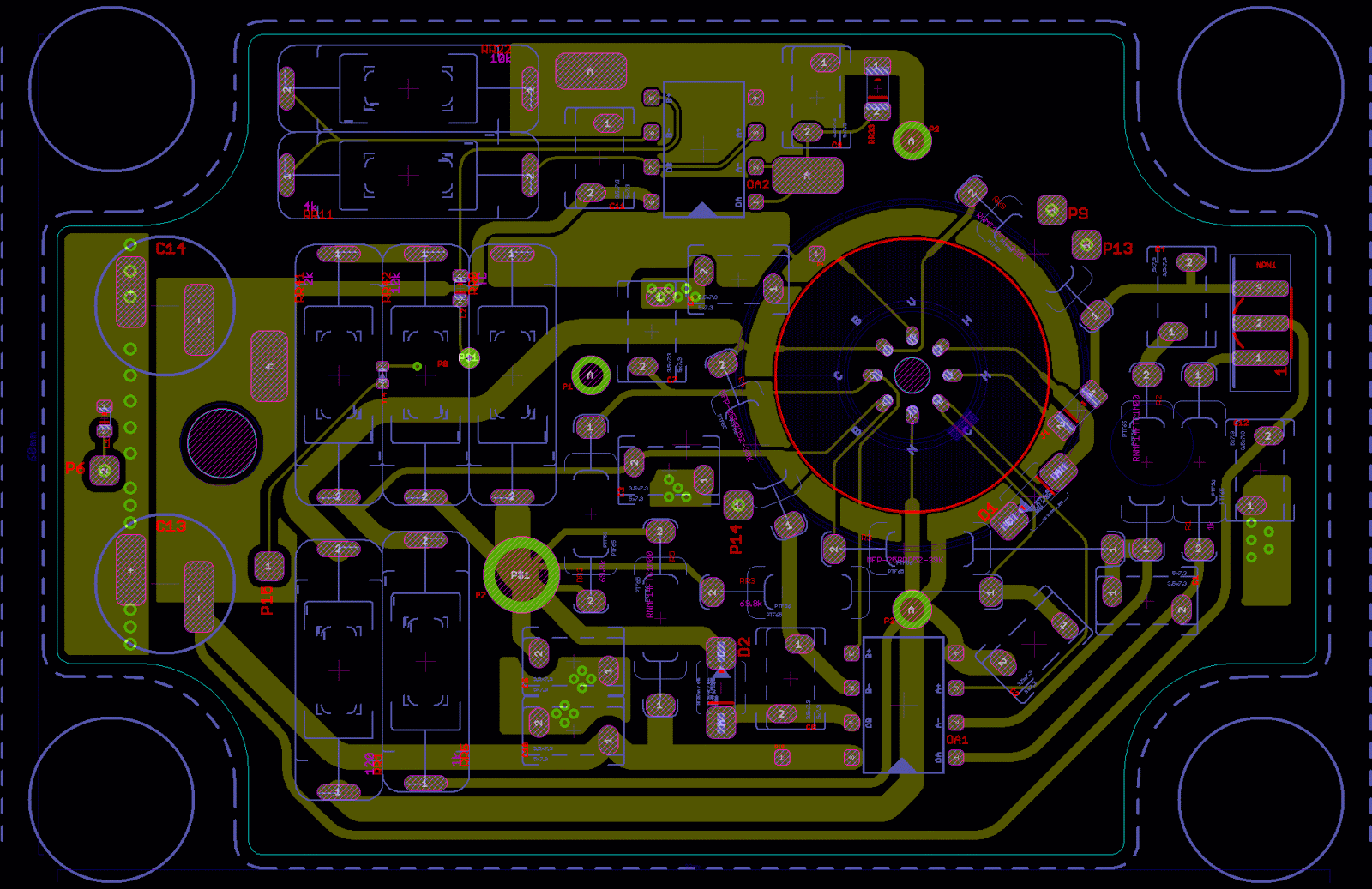

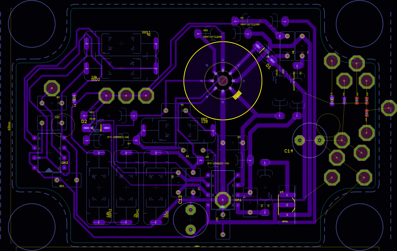

I have assembled and tested my 5 new LTZ1000 reference boards.
They all are based on Andreas schematic, providing additional EMI filtering for great immunity against RF and mains disturbances.
ive been playing with eagle, i wonder, has anyone been succesful in totally laying this entirely on 1 side? i must say i have no success.
Dr. Frank has!  https://www.eevblog.com/forum/metrology/mx-reference/msg1297126/#msg1297126
edit: actually he used two jumper wires, so *almost* entirely on one side.  I put a copy of his design on OSHPark: https://oshpark.com/shared_projects/gl2aXmlh
i know he did, i quoted his post in my question. i should re-word the Qn as : did anyone else have success in a strictly 1 layer layout w/o using jumpers?
this is my whimsical layout which i did for fun and somewhat curiosity
https://3.bp.blogspot.com/-fUTVzhfdWqY/Wjuw9s3vnXI/AAAAAAAAC30/BwFihqLtVVcEBqPCOMeiwlxS7IgqzYitQCLcBGAs/s1600/LTZ1k_11%2Bcopy.gif
i included the "RR0" which on LTZ pdf page6, is for finding an unstabilized TC compensation (but now i think it is a useless inclusion :/). the idea is to do the construction manhattan style, so no leads will be visible on the rear. the size is based on a IP67 plastic box 100x68mm. i dont suppose i have seen anybody create their favourite project box as a piece of component?
in my version, i had to use ground plane to connect capacitors :( (i also have to "jump" VREF to the 2nd op amp). which lead me to think, since capacitors do not really need to track temperatures and influence overall tempco, it should be possible to flip all the capacitors to the flipside of the PCB and have them out of the way of all the resistors on the front side.
*update
well i wasnt quite satisfied, and i think i managed to really fit all into 1 layer.
https://2.bp.blogspot.com/-ggDXXGuKW-A/Wjvgm3jeewI/AAAAAAAAC4I/rGwKasaRdf8qRVw13cVOsFrf3OUn19GxgCLcBGAs/s1600/LTZ1k_11B%2Bcopy.gif

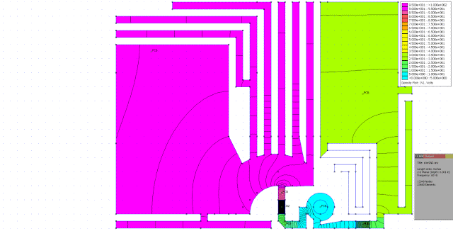

Not an expert here, but in ref PCB layouts, there's two grounds- the high-current heater return and the reference (-).
They are separated to minimize any heater-induced I2R voltage drop across ground from shifting the 0V reference point and causing uV offset error.
Your PREMA schematic just seems to use one symbol though, as some CADD software cannot understand two ground (nets) that are connected together at the PSU central grounding point. I don't have a 6048 or 6047 PCB to look at both sides.
The 10R resistor between them is usually to avoid big trouble if one ground is open circuited, and to lower Q for any RF picked up between the two ground traces.
The following users thanked this post: 3roomlab
Offline 3roomlab
  • Posts: 825
Re: Ultra Precision Reference LTZ1000
« Reply #2084 on: December 29, 2017, 03:50:11 am »
i could not get my head around it. so i dump something into FEMM 4.2 to visualize it
pic1 describes the approx currents and the 10R between the 2 sides, each with its own 0v (cyan)
pic2 is the same currents, but all traces are approx 6mil (no 10R)
pic3 same again, left side is approx 200mil trace, right is 6mil trace (no 10R)
pic4 is 6mil only 1 GND (no heater GND)
the simulation idea behind 6mil and 200mil trace comes from saturn PCB
6mil 1 oz PCB 1 inch long loaded @ 0.1mA returns a potential diff of about 0.011v
230mil 1oz PCB 1 inch long loaded @ 5mA returns a potential diff of about 0.011v (2oz PCB will only need about 150mil wide)
esp for VREF end, i wonder how much of these traces should be balanced between sourcing and draining. it would be a crazy matching exercise, this reminds me of that zero ohm thread, trying to find the zero current point inside a thick copper piece.
i also assume that the GND return current posing the most problem is the heater as the current varies with changing temperature.
but since swapping these around in simulation for GND, it appears as long as all returns appear at exactly the same star point, it doesnt seem to need a 2nd heater return? what did i miss? (assume the left side GND is the master)
maybe the better question is, since pin 3 potential is referenced to the GND thru R1, how could a seperated heater return create a more stable GND point since it is the only GND? if GND shifts, wouldnt VREF also shift and result in no change? (i assume a low noise LDO is on board and the V supply is always "constant")
i went a little further in FEMM 4.2 simulation. the animated gifs alternate between 2 diff current returns. however the more i look at these, i seem to confuse myself more
assuming zero volts is the black hole, it prevents a current return disturbance on the right from affecting the 1 on the left.
i need to emphasize, i am assuming by simulations.
this is with/without the 10R linker. i am unsure what to make of it.
i can assume since all GND labels are not really zero, what does come close to a full negation? huge capacitor as sinker?
(the txt file needs to be renamed *.FEC for use in FEMM 4.2)

« Reply #2085 on: December 30, 2017, 08:41:34 pm »
Colourful sims, what I expect for showing the electric field in copper PCB traces. Learned about the "river mouth" being something to consider.
My theory for the Prema 10R resistor - it does nothing at DC as the PCB trace resistance is comparatively low, unless for open-circuit protection on the Kelvin zener (-).
Or, it's to fool the CAD software. But at high frequencies, RF, the twin trace inductance is now at play and I suspect that another reason for it.
Copy pasta from http://www.electronicdesign.com/analog/what-s-all-ltz1000-stuff-anyway:
"Some folks put a dummy resistor in the schematic to separate those grounds into different nets. However, Mark Thoren, staff scientist at Linear Technology says, "Dummy resistors separating 'grounds' are a recipe for disaster, and I see disasters related to this practice all the time. One of the first things to look for when reviewing a customer's schematics is multiple ground symbols without a good reason for them."
'Do be aware of the return currents causing drift problems. [Carl] Nelson comments, “Current out of pin 7 is about 6.5 V/R2 + 6.5 V/R3 = 186 uA. Current out of R5 is about 550 uA.  Current from R1 (same as the Zener current) is about 4 mA.  These currents should be routed separately to the low side of the reference output. If a single trace is used, and the trace resistance is 0.4R , voltage drop in the trace will be 1.9 mV. Copper has a thermal coefficient of 0.0038/°C, which generates 7 uV/°C in the trace, equal to about 1 ppm/°C in the reference.  This is about 20 times higher than the expected drift of the part’s design intent.”
