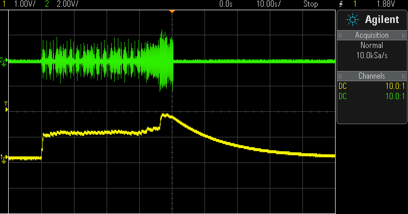

« on: December 17, 2016, 12:42:51 am »
MOD NOTE: This is thread is ONLY to discuss Batteroo test results. If you want to discuss Batteriser/Batteroo in general, use the main thread:
https://www.eevblog.com/forum/blog/eevblog-751-how-to-debunk-a-product-(the-batteriser)/
This new thread is dedicated to test procedures and results of the Batteroo sleeve. There is a spreadsheet which lists the performance gain you can get from Batteroo for different products, see here:
https://docs.google.com/spreadsheets/d/18K9c2YAT0d0QABGYGpzItbvDcgfAQCRUtloEzzfXADU/edit?usp=sharing
If you have a Batteroo, please test your products with it, instructions are at the top of the spreadsheet (no test gear needed) and then send Dave the results to dave@eevblog.com and he'll add them to the spreadsheet.
Some of the results you can find in this thread:
My train test:
Diagram:
Dave's train test:
Diagram:
Youtube reviews by EC-Projects, he measured a quiescent current of 14.4 uA
Measurements by dexters_lab:

Just an idea:
You are putting current measuring resistors in the supply and load circuits.
But the power supply and the load would have their own internal shunts.
Couldn't you measure the voltage across those and leave out the extra shunts?
That way you wouldn't have to worry about extra voltage drops.
I don't have access to the internal shunts and don't want to solder anything in the power supply or the electronic load. But the voltage drop is no problem with the uCurrent, because up to an amp it is well below 0.1 V, and I can compensate this in my testing script and incrementally increase the output voltage in 10 mV steps, so that the max error will be 10 mV, e.g. for the efficiency vs. load graph which requires a fixed input voltage (unfortunately my power supply doesn't have extra sense inputs).
I like the efficiency vs. load current diagrams for a given input voltage, will do this, too. And the tests Wytnucls suggested are very useful, too. Output ripple would be interesting, because one application to use a battery is for low noise things like microphone amplifiers, and they might be built in a way that they expect a very clean supply.
I don't have the right equipment or knowledge to do the ESD tests, but if someone can do this, I can send the sleeves to him after my tests.

I'm preparing the tests, cleaning and ordering the gear on my workbench a bit. And I bought some fresh AAA batteries, from different vendors, because the typical end user test would be important as well. Here is Dave's spreadsheet for entering test results:
I'll do some of these simple tests as well, as described in the spreadsheet. But it is difficult to find gadgets which run on 1.5 V AAA batteries. Most modern devices have accus, with USB charging, and many other devices I have use AA batteries. But I found a crusty old USB/MP3 player, you can see it in the image below. I tested it with a power supply and it turns off at about 1.12 V, when you lower the voltage slowly (works fine indefinitely at 1.12 V, but turns off randomly after some time at 1.11 V). Between 1.12 and 1.14 V it says "low battery when you try to turn it on at this level. At 1.14 V it turns on normally. Sound volume at the headphones is the same at 1.5 V and 1.12 V (but I'll verify this by measuring the voltage, will solder some audio rectifier and very low low pass filter to get an average of a few minutes for an automated test). With a typical application (playing "AC/DC - Highway to Hell" with max volume in an infinite loop), it needs about 70 mA. So a battery should be drained in less than a day.
In the photo you can see the electronic load, the power supply, another power supply for -5 V (for the analog switch and if I need symmetrical voltage for op-amp circuits, like the audio rectifier), the benchtop multimeter and the Raspberry Pi, controlling it all, connected by ethernet so that I can ssh to it, and it has mounted a folder on my NAS (with RAID0 configured harddisks), to avoid wearing out the SD-card when logging for a long time. A RS232 TTL to +/-9V converter I built some time ago with a nice box connects the RS232 of the multimeter to the 3.3V TTL level pins of the first serial port on the Raspberry Pi GPIO headers. The second RS232 connection to the electronic load is implemented with a RS232 USB adapter. And finally the power supply is connected by USB, too.
The following users thanked this post: Augustus
I think step 2 and 7 combined might mess with the results, the dead batteries regenerate (I understand they don't recharge), even 1 minute of on time with a low load (1-2ma) might give batteriser a lead. I don't think it's fair to wait for them to regenerate.
I don't think this will result in much difference. And it is always good to use best-case scenarios, because if they performs badly even then, you can be sure that Batteroo  is not good for the tested product.
To check exactly when the MP3 player I'm using for the first test stops playing, I created a simple peak detector with very slow fallback:
I'm not good with analog electronics, so first I forgot R5 and R6 and the voltage at the plus input was slowly running towards -5 V, but I saw this in the logging and could fix it. This is how the peak output looks like, compared to the amplified input after the first op-amp:
This is the script I'm using to record the data (it is really easy with the RPi_LogNut framework), and here are the first minutes of the log (both voltages are measured every 10 seconds precisely). As you can see, the peak level slowly faded away, until I hot-fixed it by adding the two resistors :) But looks good so far:
The battery voltage is measured with two wires in the battery compartment, between the battery and the contacts. This should not influence Batteroo later in any way. Thanks Dave for your latest video, I might need to replace the ADG608 with an ADG609, so that I can switch two signals. In this setup the battery minus is directly connected to the multimeter minus, but later when I switch to the shunt for the characteristics curve etc., I need to switch both multimeter inputs, to avoid the voltage drop on the wires for higher currents.
I hope logging works for hours, never tried this before. When it is done, the battery will have some time until the Batteroo arrives to regenerate.
