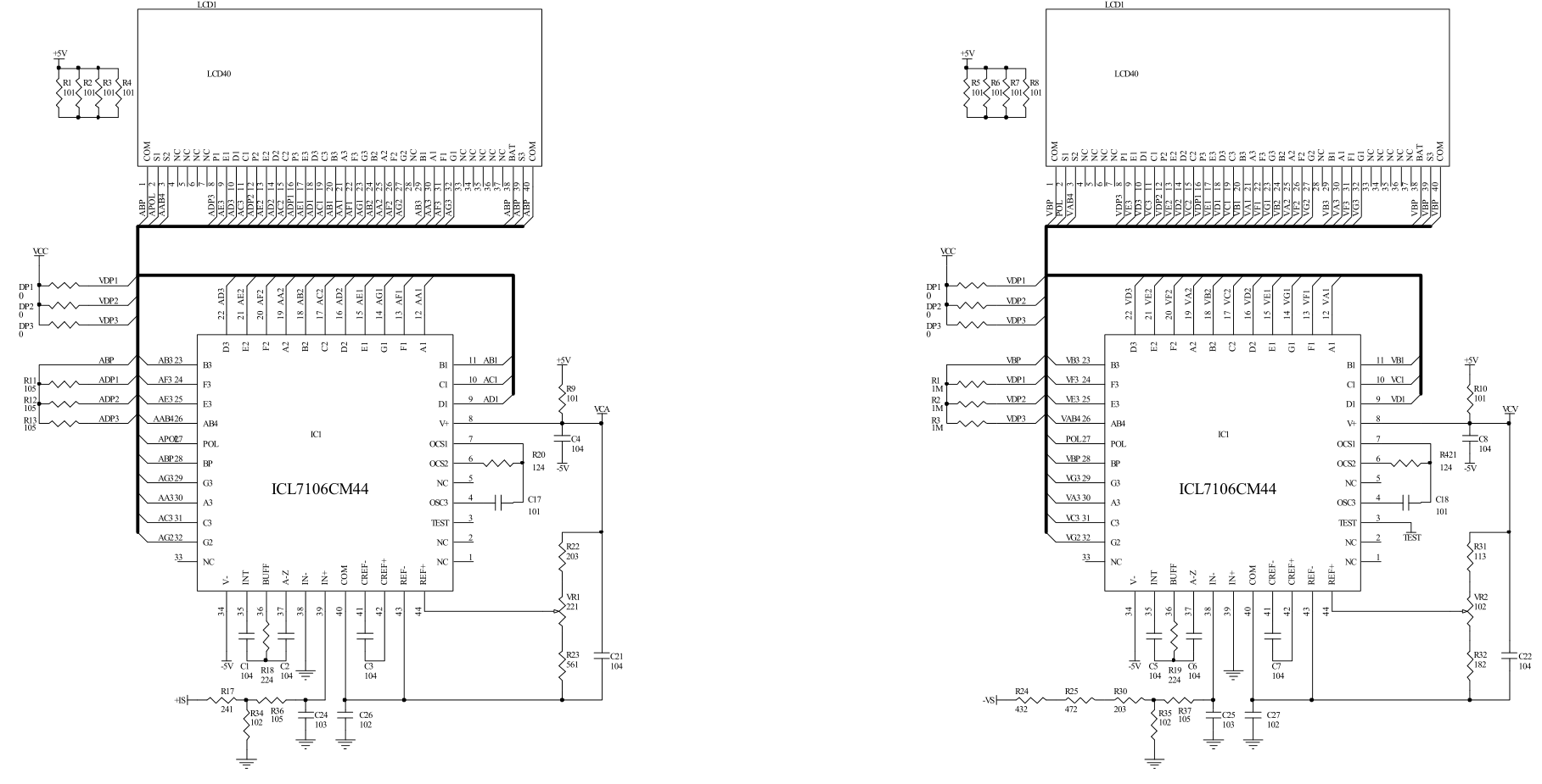

Here's an example of a 18v 2A power supply, using two transformer taps, a separate winding for the relay which enables the second tap or not, and two separate small windings for +/-8v and +/- 5v for the multimeter chips :
transformer, power transistor, linear regulators for opamps , relays, multimeter chips
opamp to adjust voltage and current,  current limit leds , output ... all jellybean components on this one and the previous part
multimeter chips (one for voltage, one for current) ... icl7106 is with lcd segments , icl7107 is with normal led segment (so you could use 7 segment digits)..
this last part is the only slightly more difficult part to make (and the chips are more expensive) but you don't really need it, you can get less accurate ready made meters from ebay. if you do make them, you need some film capacitors and more accurate resistors and you must read the chip datasheet to understand how it works etc..
