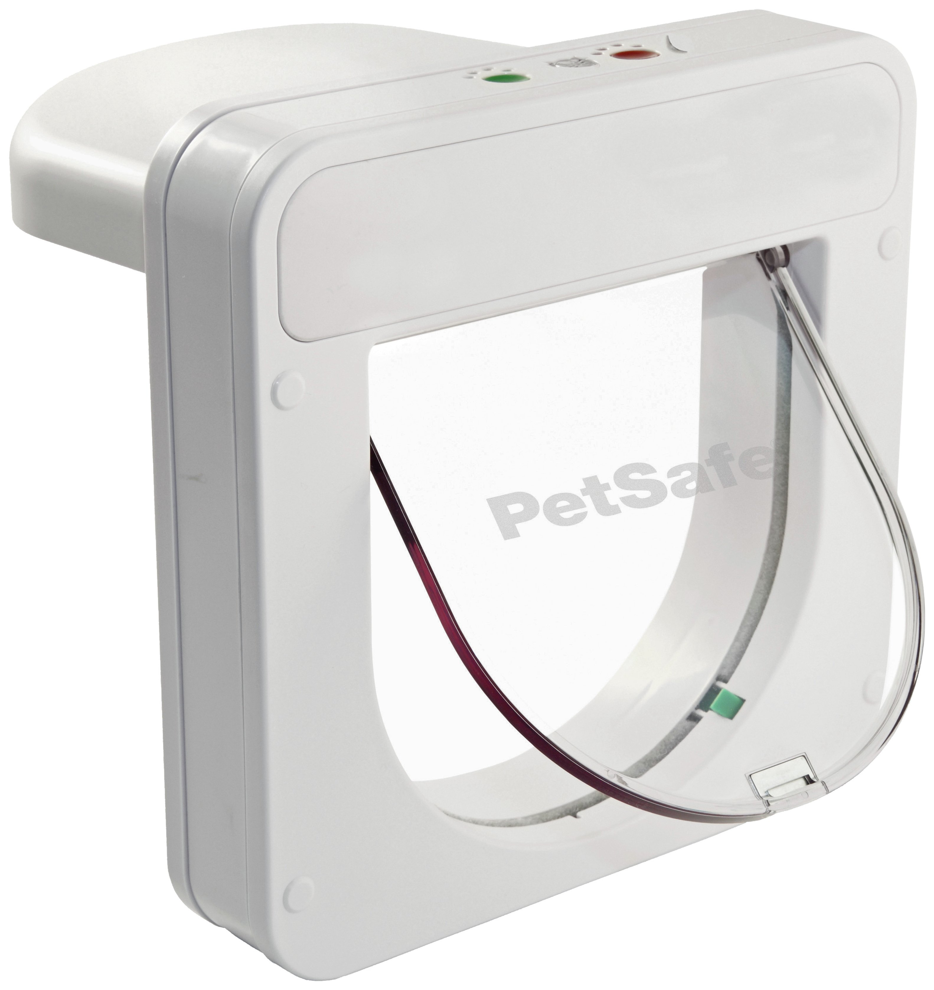

They already make these.  I recently bought this one and it works great.

Apparently unknown to you since that is exactly what that one does. There are other brands as well.
They read the pet RFID tags placed under the pets skin, and are programmed to recognize your unique pet's RFID tag and only open in response to it.  Recognition of multiple unique tags can be programmed as well. The distance between the cats subcutaneous RFID tag and the coil in the cat door does not seem to be an issue. It works well.

I have a cat flap which reads my feline's chip and opens the door accordingly.  The device (which I had an early production model and have recently replaced with a current model due to solenoid wear)... uses big coils but works very reliably.
Not exactly sure where in my cat the chip is... presume somewhere around scruff of neck but distance is probably around 30cm
I'll take  a picture of the internals if you are interested.. it's quite a simple PIC based thing.
The bit that sticks out has the coils... I actually took the coils out and remounted them above a bit of plywood tunnel due to the nature of the wall where I installed it.
