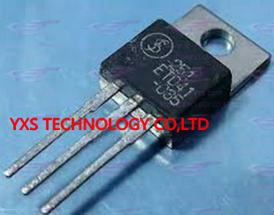

Short story: I'm looking for a datasheet for an ETD41-035, which I believe was manufactured by Fujitsu back in the 70's and 80's. I think it might be a Darlington and know it is an NPN in a TO-220 case.
Long story: These were used in a number of Yamaha motorcycle Transistor Controlled Igniters.   The ignition system supplies a constant 12v to the coils and the TCI provides a ground path through these transistors to fire the coil based on a signal from the respective magnetic pickup. There are 2 coils and therefore 2 transistors per TCI, firing on opposite strokes.
The TCIs are generally pretty reliable (biggest headache with these TCI units is cold solder joints). However, I am trying to repair one with a considerable mis-match between the two transistors. I cannot find any data about these on-line.
According to this Chinese vendor (http://www.aliexpress.com/store/product/ETD41-035-TRANSISTOR/107262_1098158355.html) the manufacturer is "YXS Technologies Inc.":
But while the photo is identical to the Yamaha TCI  component the vendor is calling it a voltage regulator! So I can't say that I trust any info from that vendor, and YXS seems to make cables, not semiconductors, so I suspect that this is one of those infamous Chinese re-labelled forgeries.
Some people report that they have successfully used a MJE5740 as a drop-in replacement in a similar TCI. So I tried a pair of those but with less than satisfactory results. I get a very weak spark compared to a known good TCI.

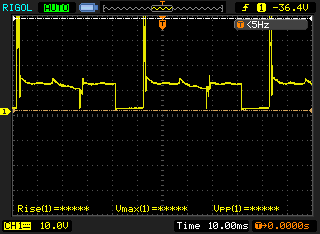

I back-probed the coil grounds on a running bike. Here is the signal from the known good TCI:
Note the wide pulse after the negative spike.
Now here is the "repaired" TCI swapped into the same bike:
The negative spike is gone and the positive pulse is virtually a spike, so the coil isn't fully discharging.
Now I just need to figure out if it's the transistors, or something else in the circuit. FWIW, both halves of each TCI behave identically. I already replaced all the electrolytic caps, measured the resistances of all the discrete resistors and tested the 8.2v zener diode. There is a mystery IC with a daughter board full of laser-cut resistors on one side and SMD devices on the underside, but I think that just controls the timing advance curve, which is working properly.

Re: Looking for transistor data: ETD41-035
« Reply #4 on: July 29, 2015, 06:17:35 pm »
YXS is their store name. It's not uncommon on aliexpress that instead of brand, sellers just put their store name. This have nothing to do with the part being genuine or not.

Yeah, I'm quite familiar with the Rider's of Vision article (Vision was a Yamaha motorcycle model). And the inside of that TCI is very, similar to the one I'm working on. Down to the value and number of most capacitors. That's why I tried their choice for a replacement. However, note that he has no specs on the original and mentions it was made by Fuji, not Fujitsu. Mine "works", sort of, in that I have successfully started the engine. But it was struggle getting it going with such a weak spark.
I think you are quite possibly right about the store name being substituted for the brand name. That said, I wonder what the odds are that genuine NOS Fujitsu transistors that nobody has been able to source for years happened to end up in China? And without a data sheet, how would I go about verifying that they are the real deal?
Based on the difference in the scope shots it looks like the original transistor did not have an anti-parallel diode across the C-E junction and was designed to operate in reverse avalanche mode. The latter would also explain why the circuit seems to be very finicky about what kind of transistor is used.
Note that very few transistors are characterized for intentional avalanche mode operation (forward or reverse) but there are loads of Darlington NPN transistors without an anti-parallel diode and in a TO-220 case so I wouldn't abandon all hope; you do have some tinkering ahead of you, though.

The MJE5740 is most definitely not a suitable part for a Kettering type ignition, the diode across the collector and emitter is dumping most of the coil energy.
There are numerous NPN darlingtons that are designed for just this application however, e.g. the ST901T is pretty cheap and available through Mouser/Digikey/Farnell etc.

Comparing the datasheets, the ST901T seems a little less robust than the MJE5740 in terms of maximum voltages and currents (although with a higher power dissipation). However, since I don't have a datasheet for the original ETD41-035, it may well be just fine. I guess the only way to find out is to try them, so I ordered some.
And just for $!+$-and-giggles, I ordered some of the supposed original from that Chinese vendor. Maybe they really are surplus NOS genuine Fujitsu transistors.
If one or the other seems to work well in the TCI I'm repairing, then maybe I'll risk desoldering one of the originals from the known-good TCI and try comparing the three in some sort of test circuit. (In which case, I'll probably be back asking for advise in designing the test circuit  ;D).

« Reply #11 on: August 08, 2015, 02:59:56 pm »
UPDATE:
The ST901T "works a treat" as Dave would say. In fact, it works better than the original. I forgot to save a screenshot from the scope, but the pulse is much broader and the spark produced is much stronger. The known-good unit craps out at about 1/4" (this is a waste-spark system, so that is in addition to the spark under compression in the opposite cylinder). With the MJE5740 installed, the spark barely jumped a 1/8" gap (in free air, so that would be less under compression. No wonder ran so poorly.) But equipped with the ST901T I had it up to 1/2"! (It was still strong, but I did not want to open the gap further for fear of stressing the coils and wires with the excessive voltage).
Thanks to all who chimed in, especially mikerj and MagicSmoker.

Funny you mention Fuji. The ETD41-035 arrived today. Different from the photo in the ad. This one bears a modern "Fe" Fuji mark instead of the mark identified as Fujitsu by several websites. That is now in question as, while exploring the Fuji website to see if they could have made this, I found Fuji claiming ownership of that mark on their website! They say they used that mark from 1923 to 1978.
However, I still couldn't find the datasheet  :(
Anyway, back to the transistor, the Chinese-sourced ones test similar on my $20 transistor tester (early Karl-Heinz type) compared to the 2 de-soldered from a known-good TCI. Hfe around 8. Forward voltage drop is a bit lower -- about 0.9 for these ones, about 1v for the originals. But looking very close at the face under the faint printing, I see fine striations. I wonder if it was sanded and reprinted. If so, the question becomes "by whom?"

Actually, that ST901T comes pretty close:
For comparison, here is the original known-good one again:
(The bias is because I forgot to set the coupling the same when looking at the replacement. But the overall waveform is very similar).

« Reply #19 on: August 13, 2015, 06:37:24 pm »
Sorry I missed your reply a few days back, it's great to know the replacement worked out ok  :-+
One thing that's interesting is that the dwell time appears to be much shorter with the ST901T, about 2ms compared to ~10ms with the original.  Presumably this system has an active dwell control based on peak coil current, have you tried looking at coil current?
I'm just wondering if the driver stage before the darlington maybe wasn't providing enough base current to saturate the original transistor, which could both explain it's failure (increased power dissipation) and the longer dwell.  The much newer ST901T probably has a higher current gain than the original and requires less base drive.
The RPM is a fair bit higher on the ST901T trace though, so maybe the system (12v) voltage was higher leading to lower dwell time?
