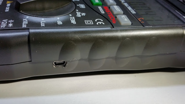

Thanks for the hack, it inspired me to buy one (for logging only, it's pretty crap as a general purpose multimeter) and perform something similar:
http://hackcorrelation.blogspot.de/2015/10/adding-isolated-data-output-to-mastech.html
I've transplanted the complete USB/UART transceiver inside the unit:
