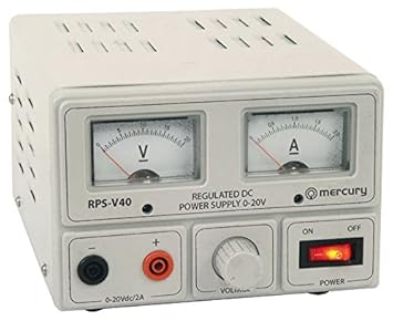

I recently bought a Benchtop Power supply from a local hobby shop and managed to murderise it by turning it up to 12v or and repeatedly toggling power on and off with something.
I don't remember what, this was a couple of weeks ago. Pretty much shorting the leads together repeatedly. Now it's stuck at spitting out 21v out the front, the dial on the front does absolutely nothing to affect it other than flicking the power button to completely stop current.
The Victim?
A Mercury RPS-V40, it's quite nice but only cost me £50
Rather than having it replaced, I'd like to have a look into it. By now it's out of the return period and it'd be rather shitty for me to try and claim it died at random.
I've got basic electronics knowledge but I'm trying to learn more as I go, however I don't fancy my odds playing with 230v while probing around inside.
While it's been turned on and sat at 21v with 0 amps it's BBQ'd a resistor on the main board inside. Pictures below:
I've not been able to work out what resistor should be in it's place. However I can confirm a good 23v is being thrown across it, way more than I assume it should normally.
After removing the resistor from the board the power supply now puts out a happy 5v that I can control with the front dial, though thats as high as it will go now.
It's range is 0-20v with a transformer inside that has 3 tapped voltages: 12v, 10v & 17v (In that order, see picture below).
I'm not familiar enough with the transformer to start probing it and know what the voltages mean. There's 5 wires coming off the secondary coil.
Though I don't know the function of all 5. I presume 3 of them are the taps at the aforementioned voltages, could the transformer be shorted?
What should I do next.
Any suggestions would be really appreciated, keep in mind I'm a beginner that's only ever really messed with basic circuits at ~5v so bigger voltage stuff is not in my area of knowledge.

Looks like that burned resistor services the Vcc pin on the 723, as well as something off-board (there appears to be a blue wire connected at the opposite edge of the board via a PCB trace from this resistor). My guess is that it's a low-value resistor. Unless you can make out its value (or have a schematic available) I would be tempted to replace it with something like 10 ohms, and also replace the 723. Then check the 2N3055 for damage and replace it if necessary. Also trace that blue wire and see where it goes. After repair, power up slowly with a variac or something similar if you have one and check to see if the 723 or the resistor (or anything else for that matter!) is getting hot. It's worth a shot and probably won't make you any worse off that you already are!

The fact the output voltage dropped from 21V to 5V when you removed the burnt resistor means it cannot have gone open-circuit.  There's a fair chance its somewhere near its original value.  Its resistance may have gone up a bit but measuring it may give you some idea of a possible replacement.
I strongly suspect that the 2N3055 pass transistor has failed.  While its supposedly good for about 5A with 23V across it, and I *ASS*U*ME* the PSU has some sort of fixed current limiting that kicks in at around 2A, that 5A rating form the S.O.A. graph in the datasheet is only applicable with the heatsink at 25 deg C.   Put a sustained short on the output and the transistor heats up the heatsink till it can no longer take the surge when you short it.
It would also be worth checking that relay - I *think* its a tap changer to select a lower input voltage to the bridge rectifier at low output voltages, and if its contacts have welded in the higher voltage position, that would result in pass transistor failure.
If you need to reverse-engineer it to get a schematic to help us work out a likely value for that resistor, you'll need to take well lit, in-focus photos of both sides of the board, square on, not skewed, and preferably against a white background, so we can help you overlay them to see the components on top of the track layout.   You'll also need to identify what each off-board wire goes to, and make a note of all component part numbers and/or values that can't easily be seen from the photos

A.K.A. Skytronic 650-673, this unit appears to be an over spec'd clone of a Velleman PS1502.
Edit: A.K.A. Quasar 650.673, PSU673
As far as I can tell, it corresponds to the schematic given on the last page of the Velleman PS1502A user manual. There are a few minor component value differences around the voltage feedback/control - as you might expect when the output is specified to 20V. R13 appears to be extra and is in parallel with R8 (! uh).
https://www.velleman.eu/support/downloads/?code=PS1502A

AARGH!!! Its a PNP* pass transistor design without effective current limiting - LM723 pins 2 and 3 aren't even hooked up, and there doesn't appear to be any other active current limiting circuit!   |O
* The datasheet the O.P. linked includes the PNP MJE2955 as well as the titular NPN 2N3055, and board layout doesn't match any conceivable NPN pass transistor LM723 variant unless its got a PNP driver transistor off-board soldered directly to the pass transistor pins as a Sziklai pair.

I'm not surprised the previous one cooked its transformer.
*DONT* start from the schematics above - its about as brain-dead a LM723 PSU design as its possible to create.
Implementing an effective 2A current limit would only have needed a 0.33R 2W resistor to be added - in the right place to trigger the LM723 internal current limiting circuit to pull down the output on over-current.
There's very little except the relay's natural difference between its pull-in and holding currents to stop it chattering - set the output voltage just so, with a bit of a load on it and you can probably get that relay to buzz till it dies.
Shrouded 4mm sockets make no sense whatsoever for a low voltage PSU.  There are no unsafe voltages so shrouding them is unnecessary, and the absence of binding posts just makes it harder to hook up to your load.
If you just want to hack the existing board to add a fixed current limit and maybe improve the relay tap changer we can probably help you mod it, but otherwise you'd be better off starting from the Philips schematics Oldway posted links to (and I posted a LTspice simulation of) in https://www.eevblog.com/forum/projects/how-do-make-a-current-limiting-knob-using-lm723-for-linear-reg-power-supplies/  If you can find panel space for its knob, it would be easy enough to add a variable current limit, and make the design close to bomb-proof.
Incidentally, LM723 was a stocked part at most Maplin stores, so if you've got one closing down near you it would be worth popping in and buying a couple - code # QL21X reduced to £0.35.   They are very unlikely to have more than 2 in stock so unless its a superstore, grab what they've got.
IF tou are short of pass transistors, Maplin don't have MJE2955, but do have the TIP2955  TO-247 plastic package equivalent (# QH55K @ £0.50) You can bodge a TO-247 onto a TO-3 heatsink footprint.   However it may be better to use a 2N3055 (# BL45Y @£0.74) + a medium power PNP e.g BD442 (# N17AJ @£0.23) or BD912 (# N19AJ @£0.24) + a base-emitter resistor on the 2N3055 to surpress amplified leakage to make a PNP-equivalent Sziklai pair. The extra parts can probably be mounted directly to the 2N3055 TO-3 package pins and collector tag.
Otherwise if you aren't near a Maplin or its gone or been cleared out by the vultures, wait for consensus in this thread and order the right parts from a proper supplier with a UK distribution center.
