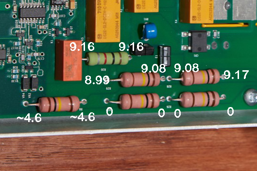

Got the shields off and took some detailed pics of the boards.

I've done more detailed testing of the input protection resisters. Data is as follows:
All voltages measured on Fluke 175.
R26 and R27 are tied to the current inputs, and are always zero. Thus they are not included in the interest of brevity.
DCV in:    0.015
Resistor Readings:
R28: 0.015 / ~0.015
R29: ~0.015 / ~0.015
R30: 0.015/ 0.015
R8: 4.56 / 4.56

For the sake of completeness, let's ensure the input protection is okay despite the input impedance looking okay.  The MOVs (circled in blue) should read 0L ohms on the Fluke 175.  The green fusible resistor (circled in green) should measure 1k ohm.  The black PTC (circled in black) should read about 1.1k ohm.
I can't quite make out the pcb lettering, but the two components circled in red might be some sort of spark gap?  If I'm correct, they should also read 0L ohms.
All these components can be measured "in circuit" with power off.  Report your readings for all of them.

I see no other precision resistor networks, either.
My readings as requested:
Green: 1.012K
Red: Unable to probe since the parts cover the connetions. Mine are different parts and are labeled TAIYO AG20 which are indeed spark gaps.
Blue: Both 0L
Black: .981K
All seem within what you expected where measured.
Can you measure the resistance of the spark gaps on the backside of the pcb?
0L on both.

I am a little late with this. I decided to record the analog switch address lines in DC and AC Volts modes similar to how Keithley did it in their service manuals. They are recorded in the attached spreadsheet. All readings are 5V logic except U60, which appears to use 3.3V logic on pin 9.
Hmm... I set out to test all of these. Every pin 9/10 I tested from the spreadsheet in 200mV is doing something like this, though this is not from this test. The range of the fluctuations got smaller as I stepped up the 8808a's range just like it did on the Z1 tests.
I set out to test the power supply and managed to have a probe slip and blew the AC fuse. More testing will have to wait until I can score another. My home office is all torn apart and I can't find anything so I'll have to go buy another if I can't source one close in value from something else.
