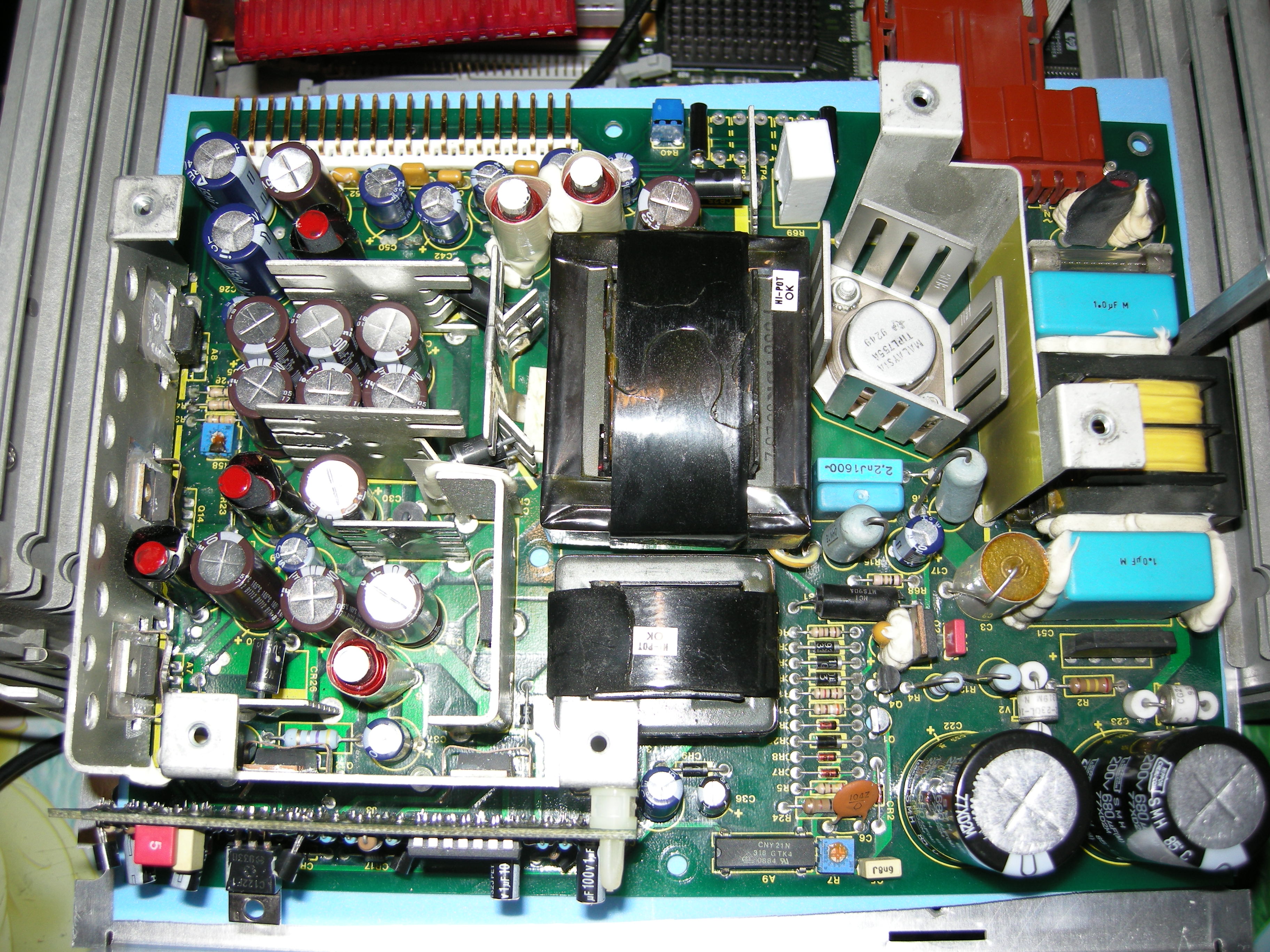

I have an HP 1660AS logic analyzer with power supply 'Computer Products XL130-3604E' where the +5V reference (test point in service manual) is ~+2.50V without load, with acquisition board as only load the +5V test point voltage drops to ~+1.14V. Adjusting the pot (+5.00V ADJ) next to the 5V test point have no effect.
The voltages on the PSU 20-pin output connector without load are as follows.
pin 1,2,3,4 +2.50V (expected +5.00V)
pin 9       +2.49V (expected +3.50V)
pin 11      -0.01V (expected -5.20V)
pin 13      +8.24V (expected +12V)
pin 15      -5.99V (expected -12V)
pin 17      +5.37V (expected +12V)
pin 18      -0.01V (expected -5.20V)
pin 19      +6.36V (expected +15V)
When the PSU started failing it was intermittent, it could work for like 20 seconds, all LA self tests passing, then fail again. Now it's "constantly failing" with output voltages as mentioned previously.
I have since then replaced all electrolytic capacitors (31pcs total), roughly 20% of the old ones were leaking, but the problem still remains. Also checked power transistors in-circuit which seem OK, at least no shorts between collector and emitter.
When measuring the diode bridge from the main transformer I get +2.50V, same as pin 1,2,3,4 on the PSU 20-pin output connector which is supposed to be +5.00V, so I'm assuming something must be wrong before the regulation, perhaps the diodes in the bridge or the transformer?
Here is a photo of the PSU linked...
http://modrobert.sdf.org/pics/HP_1660AS_PSU_XL130-3604E_top.jpg

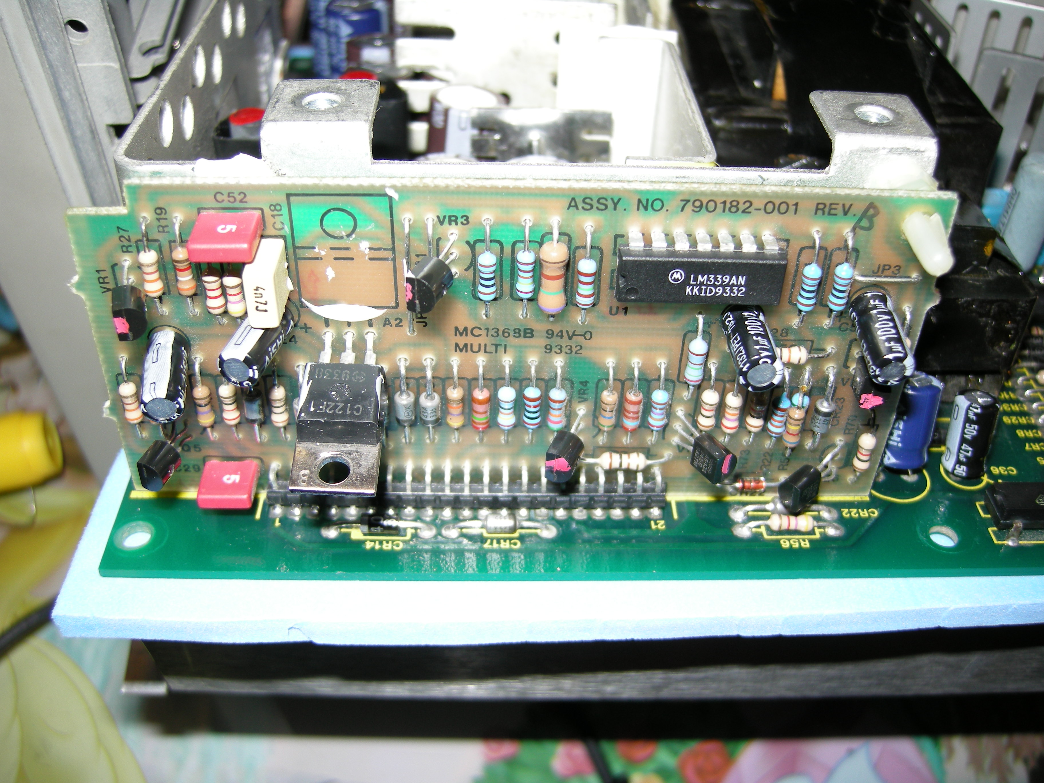

...and the small board soldered vertically in PSU:
http://modrobert.sdf.org/pics/HP_1660AS_PSU_XL130-3604E_side.jpg
If anyone have any ideas or what to look for it would be appreciated, power supplies are not my strong suit. I can't find any schematics for the PSU (XL130-3604E) when searching online, and the HP 1660AS service manual does not cover it.

Offline Toasty
  • Posts: 98
  • Component Level Repair Tech
Re: HP 1660AS XL130-3604E PSU problem
« Reply #1 on: September 27, 2017, 07:23:28 pm »
What/where is the 5V adjustment pot connected to?  I would check in that area first.
Note: Transistor/device A8 is not secured to heatsink...
T
« Last Edit: September 27, 2017, 07:27:03 pm by Toasty »

Offline modrobertTopic starter
  • Posts: 55
  • Country: th
« Reply #2 on: September 27, 2017, 07:57:19 pm »
T
OK, I will check where the pot leads.
Yes, I removed the A8 LM350T voltage regulator from the heatsink to make sure it was not shorting out against it (Vout, pin 2, also leads to heatsink according to datasheet). There is a plastic film on the heatsink protecting the metal part of the TO-220 package from making a connection, was thinking it might have gone bad over time.
A8:
Vin = +1.38V
Vout = 0V
R1 = 0 Ohm
R2 = 233 Ohm
At first, after measuring voltages and resistance, I thought the problem was with the A8 LM350T, because the output was shorted straight to ground, but after checking the board visually the trace from Vout actually lead straight to ground by design.
  • Posts: 55
  • Country: th
« Reply #4 on: September 27, 2017, 09:46:58 pm »
I checked it several times, the trace from Vout (pin 2) goes to ground.
The "+5.00V ADJ" pot goes to the small vertical board (second photo linked in first post), can't trace the leads there without desoldering the small board.
Offline Toasty
  • Posts: 98
« Reply #5 on: September 28, 2017, 01:13:56 am »
I see it, but I don't grasp the concept, yet.
Measure from Vout to Vin please.  Still get 1.38V ?
Where does the trace I highlighted in the attached image go to?  It's the input leg of A8.
T
veritas odium parit

Offline Toasty
  • Posts: 98
« Reply #7 on: September 28, 2017, 08:58:28 am »
Could you tell me where C35 and the diode are?
I understand the MTS90A action, but is it defective?  If it's operating as it should, then surely when doing a cold startup it should not be active.
I just noticed a tantalum cap glued to the back of Q2.  Tantalums are known troublemakers and I am suspicious of it.  The overall issue seems to be a lack of "drive" for the switching circuit(s). If that cap is causing a problem with Q2, it could be the root of the problem.
T
veritas odium parit

Offline Toasty
  • Posts: 98
« Reply #9 on: September 28, 2017, 11:33:16 am »
>>...I have an MCU based ESR tester, will that work for this type?<<
Absolutely.
If you ohm that switch, it should read open at room temperature.
Thanks for tracking that line down.  Pretty much convinces me that the switcher is not working.  As the other gent said, either they work or they don't.
Are there any components on the underside of the board?
T
veritas odium parit

Offline Toasty
  • Posts: 98
« Reply #13 on: September 28, 2017, 06:44:12 pm »
The cap is okay.
Is the MTS90A okay?  Does it show as "open"?
The schematic confirms 2 things.  That A8 is used to create a negative power source, -12V, and that A2 is a crowbar protection device.
Is the +5V the only line with a problem?
T
veritas odium parit

Offline Toasty
  • Posts: 98
« Reply #15 on: September 29, 2017, 01:48:08 pm »
It sounds like you have a 220V unit plugged into 110V.  Isn't your power around 220V?
What's the output from the bridge rectifier?  You should have around 312V across the mains caps.
T
« Last Edit: September 29, 2017, 01:53:26 pm by Toasty »
veritas odium parit

Offline Toasty
  • Posts: 98
« Reply #21 on: September 29, 2017, 04:25:07 pm »
In your 1st picture, to the far right, between the mains caps and the rectangular light blue cap.
Thin black device with a + sign next to it's yellow box on board.
Center 2 pins are AC in, outside are DC, positive is as marked.
Where is the cord plug connection made?
T

Aha, I think you mean CR1 on the schematic (page 5), it's black thin component with 4 pins. OK, I will measure as you described.
The mains connector is on the top right side on the photo, brown connector, you can see some of the pins there where I measured 230V AC.

I've measured the CR1 bridge rectifier (GBL06), as follows:
234.3V AC
322.2V DC

Good!
Was C5 (page 5) replaced?  What brand & series please.  It is critical to the oscillator circuit.
Also C45.   Both circled in PDF.
Do you have a scope?
