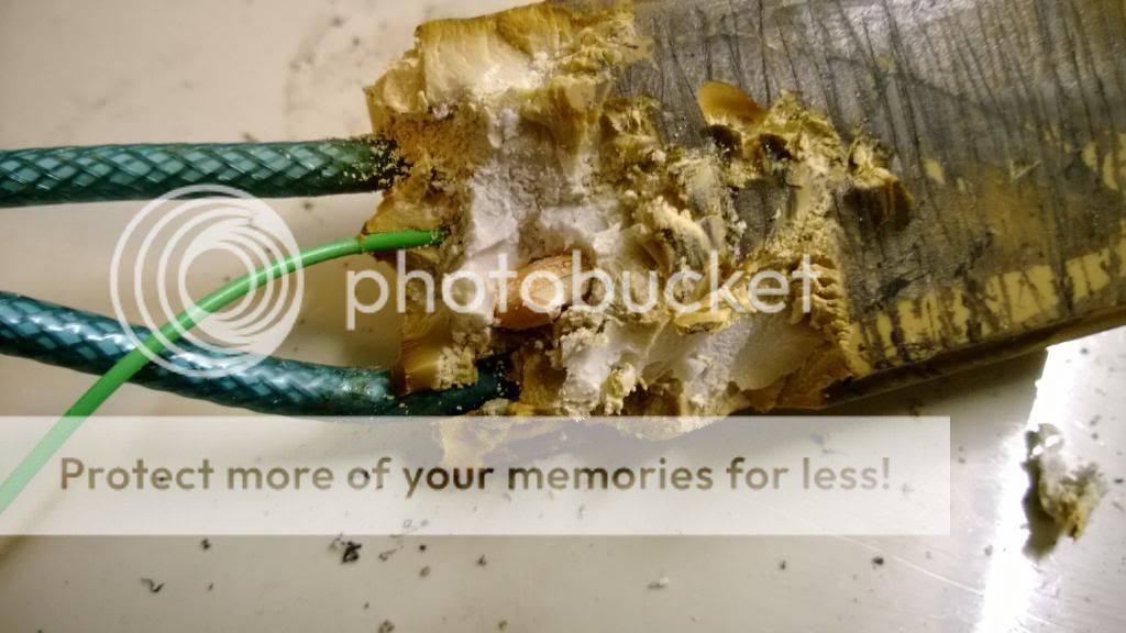

I assumed that the voltage multiplier is broken, so I decided to look what's inside the black box. Getting to the pcb was not very easy, after I removed the outer plastic layer with a simple wood saw, a very bad smelling block of nasty synthetic material appeared.
 I got it off the pcb by using a screwdriver and pliers. I accidantally damaged some caps by doing it so I wasn't able to determine what components were causing the voltage multiplier not to work correctly.

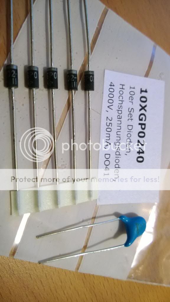

Then I desoldered all parts and cleaned the PCB in the sink with warm water. After that I had to decide what components I should use to substitute the old parts. The diodes were not labeled at all and the caps had an uncommon labeling.

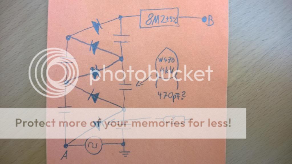

It was "W470 4kV". I think the "4kV" stand for 4 kilo Volt maximum voltage. But I was not sure if the 470 stands for 470pF or 47*10^0pF = 47pF. I decided to use my new Fluke 17B DMM  but I was not able to measure the capacitance. Every time I added another of these caps in parallel to my test leads, the difference between the capacitance was not constant but dropping.
However, I bought 470pF 4kV caps and GP0240 diodes, which are rated for 4kV and 250mA:
By the way, here is the schematic I figured out for the multiplier:

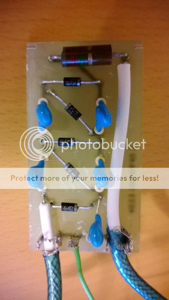

Then I soldered all components on the board. It wasnt so easy for me because I had to keep the old solder in the holes liquid so the legs of the new components could slide through. I kept the little ceramic rings at the legs from the old caps and used them again. Maybe they will prevent arcing. I reused the old resistor because it wasn't damaged.

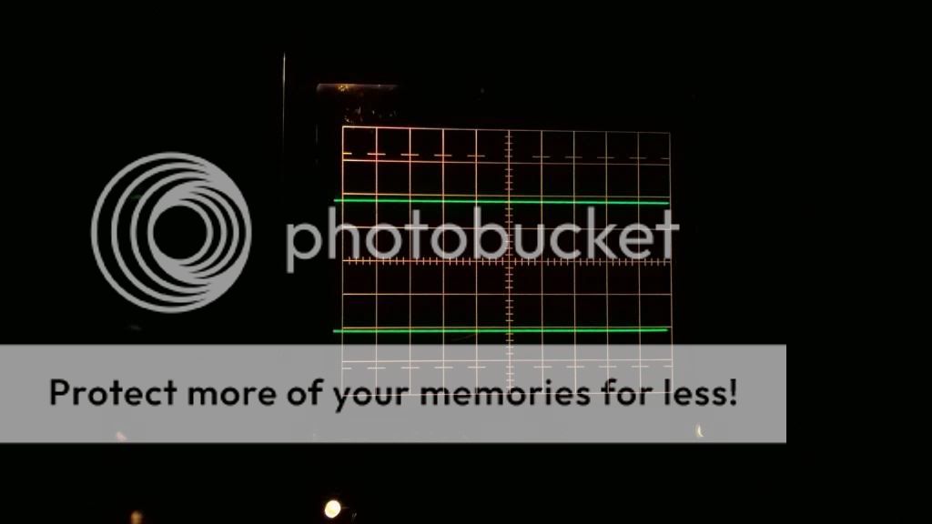

After I finished the soldering I hooked it up to my scope and secured it with a peg so the board was floating in the air and could not create any shorts.
Much to my astonishment a trace appeared, which made me very happy.

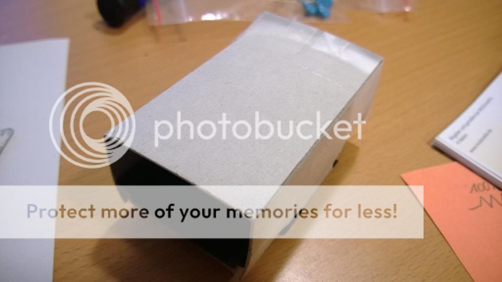

Next I wanted to put the pcb back into a secure casing. I decided to use some old silicone rubber I found in our basement. I made a little cardboard box with the backside of the old case attached to it which had the clips on it so it can be connected to the body of the scope.
Unfortunately I used to much binder when I mixed the silicone rubber, which caused the material to get stiff very fast. I had just enough time to fill the box and stuff the PCB in it. The result was not perfect so I used tape to seal everything up.

Nice job. I think you are right, the -1500V is a low impedance point so -1527 could be correct
-1527 reading on that rail completely OK (as deminstrated by sucessfully fixing the multiplier - nice job BTW).
Just under 30V out in 1500 is 2% out which is fine.
That said the actual reading may well be a bit higher - there's 1% tolerance in the resistors, but having 100M/.991M in the divider makes it read about 2% low - having 9x10M plus a 9.1M and adding a 10K to the 1M+100K series combination would reduce the systematic error to less than 1% (not much point aiming better because of the resistor tolerances).
