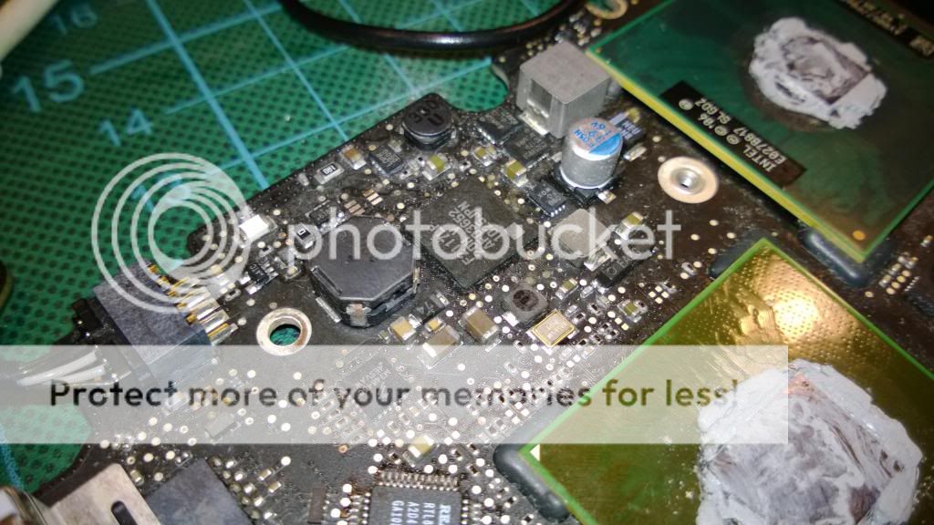

Hello!
I got a water damaged macbook I want to repair. I opened it and found nothing obvious.
Than I removed all the components and saw the backside of the logic board. It was quite dirty.
 I scraped some of the dirt with a little screwdriver off.
Then I reconnected all the components and connected the power supply. There was no effect when I pushed the on button. The power supply works with with another mac, so I know it works. In addition, the screen is damaged. You can see a lot of tiny bubbles in the panel.
Maybe it still works, but I can not test it as long as the logic board is not working.
When I will have the macbook repaired, I either want to used it or sell it on ebay. I found a macbook that is working on ebay: http://www.ebay.de/itm/200980412901?ssPageName=STRK:MEWAX:IT&_trksid=p3984.m1423.l2648
The seller writes that sometimes the screen does not work or shows green rows. He sells the macbook for 200€ as an auction or 300€ if you want to buy it immediatly. Does it is more trouble than its worth to repair the macbook with the macbook from ebay? Or can I maybe repair the logicboard of my macbook? Is it very likely than components were dameged when the water went inside the macbook? Are there any fuses on the pcb that protect the components on the pcb? Can you give me instructions what I could check? I have a soldering iron, a scope and a multimeter.
« Last Edit: October 29, 2013, 02:46:08 pm by Heribert Hechtersheim »

you need isopropylic alcool (IPA), a toothbrush or an ultrasonic bath (or both)
you spray the ipa on the corroded parts, then brush with energy and rince again with ipa
then a bath some minutes with ipa under ultrasonic pulses
you let it dry some hours
and you try to power on
sometimes you have to start this over 2 or 3 times, depends if you have some "alive" signs or not.
the display is dead you must buy another part but for the logic board it's not totally lost IMHO
good luck.

I bought isopropyl alcohol on Amazon: http://www.amazon.de/gp/product/B001FSXLMU/ref=oh_details_o00_s00_i00?ie=UTF8&psc=1
I poured a bit IPA on the pcb and cleaned it with an electric toothbrush.
The result does not satisfy me. Dust is still sticking on the pcb and components and the fluid left some lines on the surface behind. Maybe I have to repeat the process more times or pure more IPA on the pcb.
For now, I will keep the parts. If I fail repairing the macbook, I will try to sell them.

I will try to repeat my cleaning. Sadly, I don't have an ultrasonic bath. How can I get the dust away which sticks on the PCB and the components?

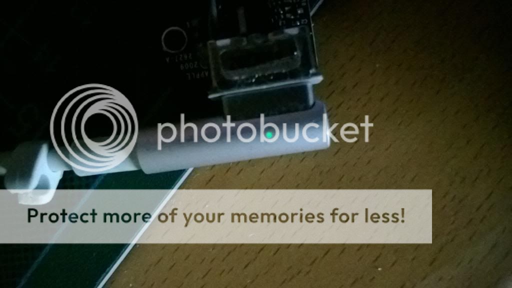

I found the first "alive" signs. When I connected the power supply, I noticed that the led of the magsafe connector glowed very very dim.
I think that normally the connector should fade green and glow more brighter.

if you want to go radical do it in the dishwasher (Glass-Program). That sould clean anything, after this into the oven at 50°C or if you have this "Nachtspeicheröfen" at home on one of these. Then total drying for days.
Another Idea, less crazy, would be the TFT-Spray from Kontakt-Chemie. Optional: After cleaning pour with clean water and a brush, don't be shy but try not to dump coils, transformers, switches and so on.
And, dry, dry, dry. At least 3 days on a warm spot.

A lot of that crud is dissolved minerals and electrolytes in tap water.
You can use distilled water sold specifically for steam irons (and it should say on the jug) to rinse the water soluble minerals.
Basically want to wash away the stuff the IPA would not clean. And once it looks as clean as possible then dry it the best you can, then pack it in a bag of dry rice to absorb the water.
Anyway, that would be my next step if it were me and I was determined to try to get it working.

The "power system architecture" page of the schematic will be very useful for figuring out where to look for voltages.
That F2117LP BGA is the EC. MC34845 below it is the backlight controller.
Seeing as the LED on the power in connector is controlled by a digital protocol and it's turning on (under control of the EC), indicates there is some sign of activity and the EC might be running - you can scope the center pin on the connector to confirm the communication.
Thank you for your suggestions. I will check that when the board is dry again.

  • Posts: 9012

Then I found a broken 1 ohm resistor which was protecting the 3.425V "G3Hot" Supply. I shorted it with my multimeter and the current was only about 4 mA so I oversoldered it.
Which one exactly? It might've been a current sense resistor, and in that case you definitely need to replace it with one of the correct value.
I shorted the blown fuse and measured the output of the 50v lcd backlight driver. It is only 37V.
It's a constant current, not constant voltage driver. Either way the IC can produce up to 60V but it's also PWM'd so I wouldn't expect maximum voltage unless the brightness is also set to max.
(Checking for shorts is something a thermal imaging camera would be very useful for. :D)
I marked the resistor with an arrow. The ~1k vaulue was the value the resistor had before I oversoldered it.
The output voltage is a bit lower then the 3.425V but still higher than the minimum so I think that is ok.
Ahh, that makes sense. In the datasheet(http://www.freescale.com/files/analog/doc/data_sheet/MC34845.pdf) they also say that "The 34845 includes fault protection modes for LED short and open, over temperature, over current and over voltage errors." So hopefully nothing got damaged when I shorted the fuse.

Offline Heribert HechtersheimTopic starter
  • Posts: 40
Re: Repair a water damaged Macbook. Is it worth it?
« Reply #42 on: November 12, 2013, 02:04:43 pm »
:palm:
Really. There's not much here to say.
First of all, when doing repairs like this please put in the time to do it right. Things like buying alcohol and distilled water? Not very hard to do, not all that costly (10 euros? maybe less). Washing the board with tap water introduces the same corrosives and minerals that destroyed the board in the first place. Not good.
And alcohol, unless you buy a whole lot of it at an extremely high purity costs very little.
It's a lot easier to help you get the whole thing working right if you slow down a bit and want to do it right.
I think I would wash dirty boards again in the dish washer. Probably not if they have BGAs on them, because the dirt and moisture will maybe stick under the chips.
If you dry the board after the washing, there is not much time for the metals to corrode.
Secondly, one thing I learned on fixing these boards is to NEVER short out anything. Shorting out the fuse? Yeah, the problem was likely still there and you just blew the whole backlight circuit and the LVDS connector. Same with oversoldering components. They are there for a reason- its almost always better to wait a week and spend an extra 10 euros to get replacement parts than to try and repair the *entire* circuit later.
I cannot check every single component of the circuit when I work with such an overpopulated smd pcb. As a electronics beginner like me, I need very much time to figure out where components of the schematic are on the pcb.
Before I shorted the fuse, I only checked how the components are connected. I must admit that I could have noticed that the LED cathode was shorted. It was a mistake that I didn't checked that.
Now the connector is partially molten and I had to order a new one from Hong Kong which costs me 7€ and what is even worse: time (I have to wait maximal till christmas). I cannot say if the damage to the connector was done before by the water or after by me by shortening the fuse.
Finally, I think the 50v you say the backlight needs is wrong, from what I have read this should be around 32v.
You are right, the 50V they wrote in the schematics would be too high. I disassembled the dirty screen and saw that the led stripe is splittet up into 6 lines which consist of 9 LEDs in series each. So if you say that every LED has a voltage drop of 3V you would need 27V per line to light the LEDs. If they cycle through the LED lines, the voltage of 37V I measured seems to be OK I guess. In addition, the voltage will probably drop if the LEDs are connected.
« Last Edit: November 12, 2013, 02:09:03 pm by Heribert Hechtersheim »
