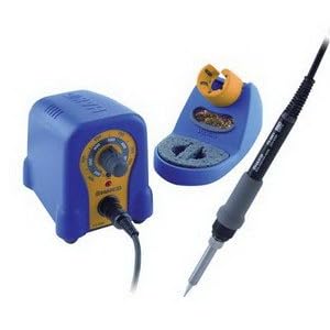

PART 1
As the Weller WX2 proved to be unfinished crap and after getting back my money from Weller i decided to try something little bit cheaper.
After searching for a 220 V unit everywhere i could not find any. There was some on eBay from unknown Chinese sellers with price about 140 $ bigger than at reliable USA sellers. Add VAT and tax to this and its a nice amount. Plus the unit shipped from china will travel 1 month and come beaten up like usually when packed by Chinese sellers while the one from USA will arrive in few days with USPS express mail international.
So i ordered 110 V variant in hope of exchanging the transformer and saving 140 $. Then unit arrived today after 4 days, triple boxed with huge amount of Styrofoam chunks. The retail box looks like it came from Hakko few minutes ago, not around the world. I really love USA based eBay power sellers  and their care :)
As soon i come home i will open it up and see what can be done in the 110 V - > 220 V conversion.
Oh, the joy of sending various electronics to silicon heaven

PART II
I opened the unit and the transformer does not have higher voltage taps. There is only one more transformer tap which gives about 1 Ohm bigger resistance and is probably used for 120 V. I measured the original transformer and its 28 VOC and fells to 26 V when loaded. After digging trough boxes with unmarked transformers using my meter and power cable i found a transformer i remowed from a Vivax subwoofer amplifier just few days ago. Its original in specs for hakko  :D
I glued it with thermal epoxy and the unit even does need any calibration. I saved 140 $, weeeeee  :)
The only bad comment about the soldering iron would be that the main on/off switch does not have insulated leads, it just relies it will not be pushed in but however it can fall out and mains voltage sits insulated 0.5 cm from bottom case. Fixed that !

That transformer is verry heavy and possibly when moving the base it would smash all inside, so epoxy is exactly what needed :P
I soldered about an hour yesterday i need to get some tips. The delivered one is small chiesel good only for trough hole. But in conclusion that is a AMAAZINGLY GOOD iron for money i spent on it. It beats expensive Weller crap i was buying. To be honest i think i found my supplier of soldering stuff   :D
For elCap: the unit had 110/120 V taps, running it on 100 V wont matter.

how many amp is the replacement transformer?
2.5 A, which is exactly 65 W as the iron is.

@hacklordsniper: awesome job!  The 888 is a great iron, I think overall Hakko beats Weller mainly because its consistency in its product quality.  Your review scoops eevblog who hasn't had the time to put a thorough one up, although he has had this iron for some time.
The PCB and layout is very similar to the 936 except its more cramped into a smaller box.  While i love the smaller footprint, and overall you get more items for the 888 than the 936 package [ when it was still sold ] the 936 case is easily stacked for storing items on top of it or among other test gear, which can't be done with the smooth curves of the 888.
I noticed Hakko has a version with decals, do Hakko owners receive it in their box?  There seems to be no price difference.
