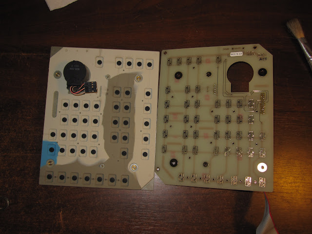

This machine was a virgin  ;D because of his sticker "warranty void if removed", so I was likely the first one who opened it after it's last calibration in January 1998 (cal sticker with date).
Dirty and nasty, the same smell when you open an old TV, black dust on HV accessories.

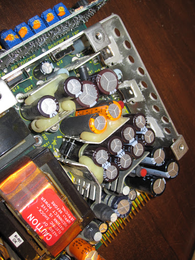

Power supply. This looks primitive for me compared to evilness of the mainboard. ;D
I cleaned HV supplies:
Everything clean now. Very easy assembling and dissasembling. However I recommend to seal all screws and write on it where they belong to :)
These orange Nippons are perfect, they always hold their capacity, ESR and tgD even in rough conditions.

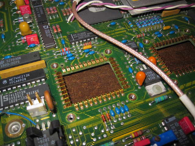

Computer. M68000. Where can I get this in gold ceramic ?

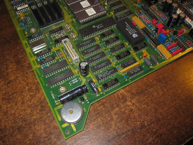

Should I replace this Dallas IC ?

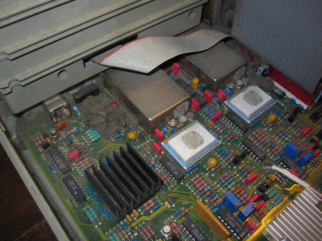

Preamps and attenuators

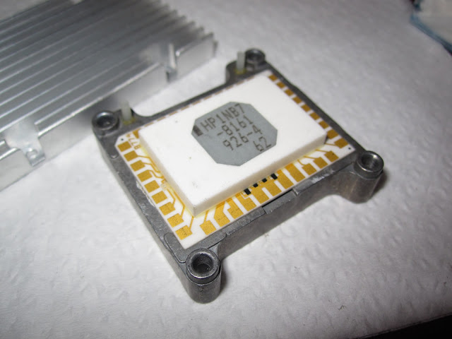

A/D hybrids
More hybrids and ... mmm, thermal oscillator :)
I was talking about evilness of the mainboard. Do you agree with me ? I can count 8 layers in close up of the laminate.
Anyway, it is beautiful, I like these clear laminate that I can read traces in inner layers :)
More hybrids:
I didn't take a photo, but this was very dirty, balls of dust:

Fault is with the DALLAS IC holding the calibration factors. It must be replaced and a re-cal should be done, though it may be okay without a cal (just not super accurate.)

Change the dallas chip and do a self cal. Most likely the machine will work again.

"Now I am going to check power supplies and find out what's wrong with this machine."
As can see in self test there stay NVRAM FAIL.
Just change it or modify with new compatible NVRAM. (exactly same you can not find maybe)
Or modify it using Gold contact socket + NVRAM socket + low standby current CMOS Ram. (this whole sandwitch is still just enough low that it can go inside through bakcside hole so these can assemble all ready outside. (if need many times take main board out then no need take NVRAM/CMOS out from socket. Advantage in modification is that you can then measure lithium voltage.

I read the service manual and ran self-test again to look what's wrong and I was a little bit confused about it, because I tried to load default factory calibration, and it gives me this errors:
This is the error that indicates corrupted Dallas IC you are talking about ?
I am confused because I just thought that this IC can operate without backup battery, that it just loss it's data after power off.

Turn cal protect switch non protect and do default. What reads then.
Then if all read D just do full selfcal.
(but also in your first image, there is test table where reads:
Failed: Protected Non Volatile RAM.
But in your las image there read that *C in every place = Corrupted.
But then top of screen there read that switch is protected. Turn it unprot and then load factory defaults. There need then read D in every place where now is C.

You all were right, I switched calibration to unprotected and then oscilloscope automatically loaded default calibration, as you can see here:

https://www.eevblog.com/forum/product-reviews-photos-and-discussion/defective-hp-54504a-nvram-substitute/
I tested it, and it would selfcal perfectly if started from a default setup, and everything worked after that. Of course it lost calibration as soon as it was powered down, but it'd work fine as long as you left it running. If those match your symptoms, it definitely is the Dallas chip. You don't need the exact same model, http://www.maxim-ic.com/app-notes/index.mvp/id/202#q13 (and see the previous thread for more discussion).
A note on removing it: the legs of that chip are covered completely by the package, so cutting the chip out and then desoldering pin by pin won't work. I ended up doing it with hot air, but the heating slightly discoloured the board and made a nearby cap drop out of the board too. Not too bad, no serious damage, but if you have access to a good vacuum desoldering tool you can probably do better.
Mine also had a bit of error on the low frequency adjustment. While you're replacing it anyway, grab yourself a copy of the service manual (search for the model number on the Agilent site, they have a scanned PDF version online) and follow the whole procedure for tests and calibration. Some parts are a bit tricky because you'll have to adjust pots under the power supply, some of those cheap plastic adjustment screwdrivers might come in handy (after cutting them in half, if they're the long type).

VOILA  :D
Hardly believe I managed to do it with only chinese sucker and pro's kit solder, but it went much more better then expected :)
It went absolutely with no resistance, almost every pin on the first try, pins were free and when sucked the last pin, I only deattached the IC with no force :)
DS1230Y substituent is on it's way :)

Those can be "modified" to place a new battery on top. There is a thread on that somewhere in the forum.
Any idea where it is? I have this same oscilloscope. I want to repair it with a piggyback.
Offline thetundrawolf
  • Posts: 2
Re: HP 54502A - nearly vintage digitizing scope
« Reply #22 on: July 17, 2014, 08:19:16 pm »
I found these resources.
http://www.hardwaresecrets.com/article/Replacing-the-Motherboard-Battery/81/3
This recommends replacing the battery inside the NVRAM module. It even has a pinout. At the worst case, you could solder a battery to the pins, observing polarity. This leaves the old battery inside, to possibly leak and corrode.
He is talking about removing the top cover and replacing the battery.
Here is another option, and an 'able.
http://www.instructables.com/id/HP-54501A-NVRAM-Replacement/
This guy not only replaced the module itself, he soldered in a socket so he could replace it later if he wanted. He has an HP 54501A.
I personally prefer to remove the cover and replace the battery. The best option, of course, is to solder in the socket so you can replace it any time you wish without desoldering.
Here is a search I did for replacing the battery in the Dallas NVRAM module. Unfortunately, it looks a bit more complicated than just popping the cover off.
https://www.google.com/search?q=replacing+dallas+nvram+battery&client=firefox-a&hs=qcE&rls=org.mozilla:en-US:official&channel=fflb&source=lnms&tbm=isch&sa=X&ei=YTDIU9ebNYzfoATC24DICQ&ved=0CAkQ_AUoAg&biw=1366&bih=631#imgdii=_
I am not sure what to think. The replacement module is a little over $30 which is worth it to keep my digitizing scope running good.
Apparently the Dallas modules have the batteries encased inside. This is what you must do to get at it.
http://www.classic-computers.org.nz/blog/2009-10-10-renovating-a-dallas-battery-chip.htm
