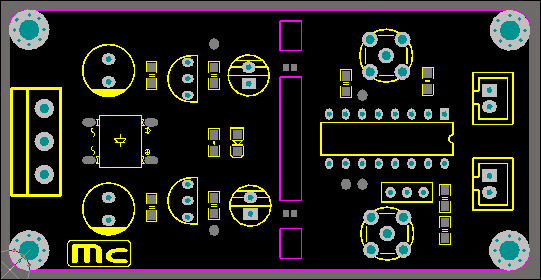

Since I am talking about China - some of the Chinese have fun with this chip also  :o :
Link:  http://www.microcontrol.cn/bbs/MINI/Default.asp?101-34077-0-0-0-0-0-a-.htm
