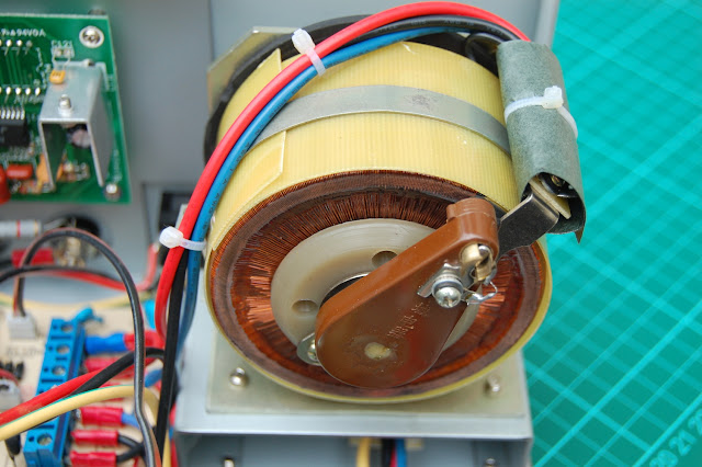

As the title says, this is a teardown of the EA-3048B power supply. There is not much info on the internet about these, so I thought I'd share some pictures and comments.
This is a so-called "universal" power supply. It has two outputs: DC and AC. The DC is not regulated, so you either get rectified or smoothed (using a 4700uF cap) output.

The voltage is controlled using a variable transformer (variac).
