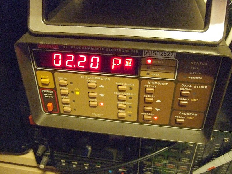

Several months ago I purchased a Keithley 617 electrometer (think I'm becoming a Keithley fanboy/collector).  It seemed like a fully functional unit with the exception of readings at the lowest 2 pico-amps setting.  The service procedure gives instructions for setting zero and offset on the electrometer board at the lowest pico-amps setting with no input.  The zero could be set with good stability but the there was too much variability in the 2 pico-amp range several hundred counts.  I did some research/probing but didn't find anything conclusive.  Prior posting: https://www.eevblog.com/forum/testgear/keithley-617-current-input-adjustment/msg450438/#msg450438
I held off cleaning the electrometer PCB for fear of adding or spreading contamination - thus adding new or exacerbating existing problem(s).  I finally decided to go for it.  I cleaned the critical half of the electrometer PCB with the best isopopal I could find.  I carefully scrubbed it and flushed it with IPA followed by drying with a heat gun.  I reinstalled the board and let it run for 3 days - It was better but still not there.
A little frustrated I let it set in the closet for a few months while pursuing other projects.  I recently revisited the zero/offset procedure and surprisingly the unit was much quieter on the 2 pico-amps range.  After ~3-days of power-on, the unit was correctly zero/offset adjusted and is very stable.  This instrument is very sensitive - just moving across the floor makes it jump a couple hundred counts for a few seconds an then settle.
The FIX = TIME.  My best guess is the unit may have absorbed moisture at its previous owners location or while shipping.  It was not shipped in a sealed bag with descendant.  So altitude changes (e.g. air shipping) may have created condensation.
While searching the web, I found some interesting information on design and cleaning/contamination for this type of instrumentation.

While searching for something else, I stumbled on this thread and found it worth bumping up.
Yeah, very familiar. In my job for an OEM, testing and calibrating measuring instruments that we manufacture, leakage always is an issue. We're talking about an instrument with a specified input impedance of > 1 TOhm.
Cleanliness of the boards is very important. All sensitive boards are washed in an industrial pcb washer using special detergents. This is to remove the spray on flux used in the wave soldering process. This washer also dries the boards, and surprisingly, not much time between washing and testing is needed at all.
We found the biggest contributing factors to leakage were actually what types of plastics were used in connectors in combination with the weather.
Certain types of plastic (like the green Phoenix connectors) can hold quite an amount of moisture and cause leakage in warm, muggy weather that we usually have here in  the summers. The seemingly trivial act of changing to a different type of connector solved a lot of issues we were having during these months.
So, with regard to your meter, just the weather conditions may have an effect on it that's not negligible.
Comment on the video: it looks like a crude way to clean the board, but it's tried and tested, been there done that. That curve on the monitor after cleaning looks very familiar...
Also note that there are no connectors on that board with plastic insulation, just individual pins with air around it. In these low current conditions, plastics turn out not to be that good an insulator at all since it can hold moisture (depending on the type of plastic, as written above).

For most aplications a good cleansing with isopropanol will do. Do let it dry for a while, most people forget/neglect this and doing do can easely generate nanoamps of creepage currents. On your electrometer clean the connectors on both the cables and the device itself too.
Once you play with a (good) electrometer you will soon find out why people use expensive (triaxial) cables, and propper grounding is a must. I have made measurements where it was necisary to keep at least 2 meters distance, not to completely mess up the measurement. Just breathing, walking by or even turning your head or waving your hand can mess it up.

one of the things people do not realise is that, when the cleaner evaporates, it cools down ( evaporation creates a cooling effect ).
this allows moisture form the surrounding air to condense .... moisture that is pretty conductive.

I've just cleaned a 617 yesterday, after it failed calibration. 2pA was unusable, it had more than 450fA offset and more than 80fA noise (this should not exceed 15fA). Totally cleaned the input PCB, and replaced 2 bad caps and a bad potentiometer. It now works like new.
I've posted some pictures on TiNs FTP.

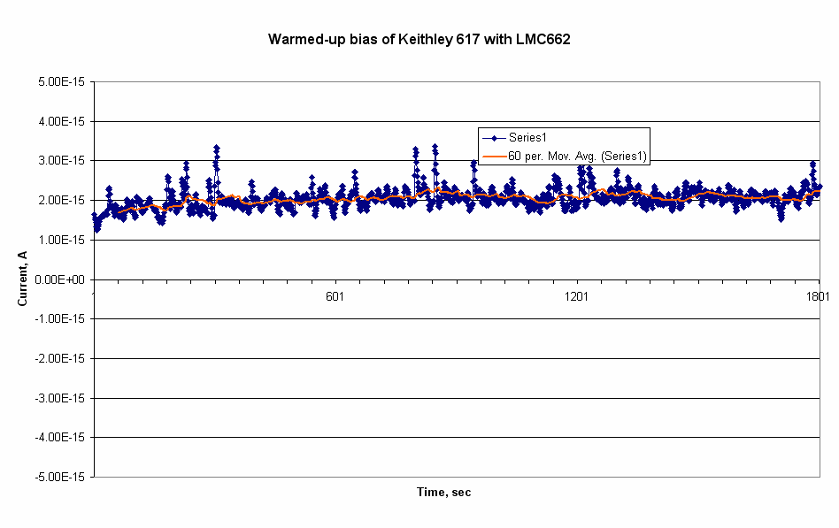

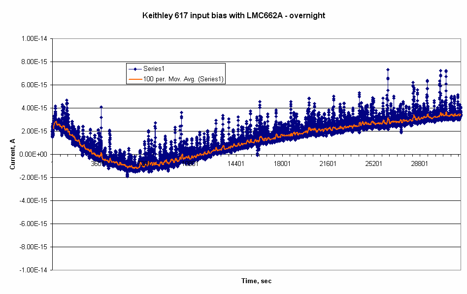

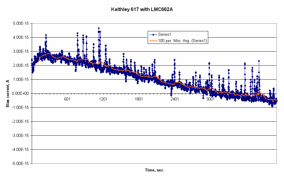

Here is the input bias current of the Keithley 617 with LMC662A in place of the input JFET pair for over an hour after I've adjusted it. I'll leave the logger to work overnight to see how the bias behaves.
Cheers
Alex
« Last Edit: September 19, 2015, 11:12:23 pm by Alex Nikitin »

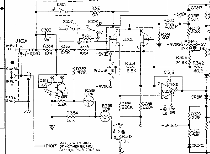

If I understand correctly, you've replaced the (unobtainable) Q308 low leakage dual JFET with an ultra low bias current op-amp??!!  The spec's on the LMC662 look very impressive but I did not think an op-amp would be an easy fit for the dual JFET.  I'd be interested in hearing more details on your modifications...
-rastro

I've replaced R348 which is used for setting the input current. It was 5K 3/4 turn pot instead of 10K used in the manual. I replaced it with a small Bourns 10K multi turn (don't know the type) and by offsetting the pins I could still set it via the original hole in the shielding (sorry, didn't make a picture afterwards). Its much easier to set a 10 or 13 turn pot than a 3/4 turn pot. Turning the old pot did nothing.
When I was at it I checked all old electrolytics because let's face it, its build around 1984. Most where fine, but two of them had quite a high ESR (capacity was fine). It were the two identical blue Ritchey (1000uF 16V if I remember correctly) caps next to the transformer on the (smaller) input PCB. I don't know the number as there was no silk and I could not find a silkscreen layout of the input board.
Unfortunately I had no time reading the EEPROM, it was version 4.2 as I remember correctly.

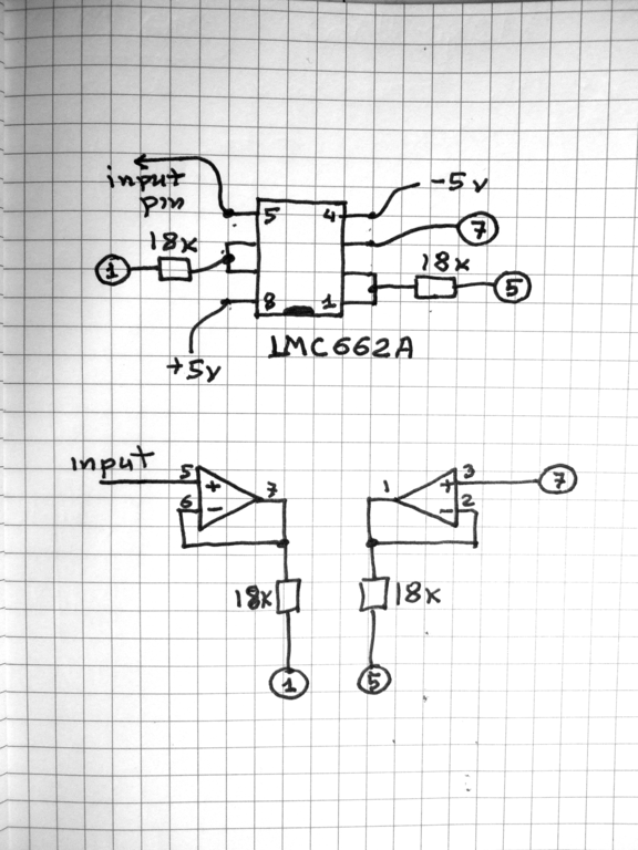

-rastro
Fortunately, in the 617 the input FETs are just followers, so I've used opamp as two follower buffers. Works fine. 18K resistors are needed to imitate the FET's output impedance, these should be selected to match within 0.1% .The orientation of the opamp is important - pin 5 is better to use as the input pin as it is far away from the supply pins! Below is a part from the 617's circuit and a sketch of my replacement. as well as the overnight measurement of the input current (the temperature in the lab went down by about 6-7C during the night). The input current stayed almost in spec even in these conditions. I've also added 220nF film cap between the supply pins of the opamp (visible on the photo I've posted earlier), this cap could be 47nF-220nF in value, preferably film.

BTW Alex, I wondered how you determined the FET output impedance resistor as 18K. I would imagine this value to be quite a lot lower.
These FETs have (roughly) the transconductance of about 2mA/V at 1mA (~0.5K output impedance in a follower). In the 617 circuit these FETS are run at a rather low current (~25uA). The transconductance in a JFET is (again, roughly) proportional to the drain current, so for 40 times lower current the output impedance would be about 40 times higher or ~20K. These resistors are needed as the second stage on the LT1012 is an integrator relying upon the previous stage output impedance.
Cheers

Hello Alex,
The 617 I'm interested in LMC662A-retrofitting has the newer electrometer PCB because it has the input protection (dual) transistor(s).  I have 3 areas of concern with how well this modification would cross over from the older style electrometer PCB.
1. Different input current compensation circuitry:
-- This is likely a non-issue since the newer board probably just adds additional range.
2. Different input JFET (Q308):
-- How was it determined the Q308 is different between versions? (part number marking?)
-- Is there a meaningful difference between the new and old version of Q308?
-- Will the 18K resistors still provide the correct impedance matching for the newer Q308?
3. Addition of input protection circuits:
-- This should not be an issue since input off-set is adjusted out with R348.
Regards
-rastro
Non-issues on all three items, actually. I had to update the current compensation circuit anyway, newer FETs are most likely similar in parameters , just from the photos it looks like the later ones have a smaller case, and the protection transistors should not be a problem.
Cheers
Alex
P.S. - the last measurement graph I've done today, on a fully closed and warmed-up 617:
« Last Edit: September 20, 2015, 02:53:39 pm by Alex Nikitin »

Offline jitter
  • Posts: 793
Re: Fun With Low Leakage/Bias Current: Femtompere, Electrometer, Keithley 617
« Reply #23 on: September 20, 2015, 09:03:57 pm »
Those spikes in the measurements, could they be the result of popcorn noise?
Online Alex Nikitin
  • Posts: 1177
  • Femtoampnut and Tapehead.
    • A.N.T. Audio
« Reply #24 on: September 20, 2015, 09:55:29 pm »
You may call it popcorn noise if you wish  ;) . At these current level it is almost unavoidable to have some of these. Before I've closed the top cover on the 617 even some air movement may cause a spike. And even with a closed cover a small tap on the bench could cause a spike like one of those on the graph.
Cheers
Alex

I tried to read the main EEPROM today, but unfortunately this type (Hitachi HM4827128G-25) was not supported by my programmer.
Today I found a problem regarding calibration: The device won't calibrate the current ranges. When I save the fresh calibration  via program select => stor the calibration values disappear, and the previous calibration settings reappear. The manual states this action should copy the settings to the NVRAM  (Xicor X2443P NOVRAM) memory. Voltage calibration does work. Anyone has experience wit this kind of issue?
Smith,
See page 7-6 of the 617 user manual "Keep in mind that the calibration jumper must be in the correct position, as described in paragraph 7.4.4."
It's possible that the voltage calibration may already have the same value in NVRAM as the new value you are trying to save - so it just appears you have saved a new value.
-rastro
« Last Edit: September 22, 2015, 12:22:46 am by rastro »
Offline Smith
  • Posts: 376
« Reply #27 on: September 22, 2015, 06:27:48 am »
I have set the jumper in the right setting. When saving calibration with the jumper on the wrong position the display says 'out' instead of 'stor'.
I am absolutely shure the voltage calibration worked as the device was far out of calibration (>1% on some settings). After adjusting the unit the voltage reading was within 1 or 2 digits of my Keithley 2000 & 6517a.
Unfortunately my programmer also doesn't support the NVRAM to make sure it writes anything. Also, the NVRAM has 256 bit for storing calibration. The device has 27 calibrated 'ranges'. So it has no more than 9,5bits for each setting, which will probably be 8 bits. Maybe I am trying to calibrate the device outside it's 'calibration working area'.
The device came in because it was out of cal on all voltage settings, some current and some resistor settings. As we don't use the coulomb measurement anywhere, none of our electrometer have calibrated coulomb settings. Maybe we should replace the damn thing, but it's only 31 years old  :D
Trying is the first step towards failure
Offline Smith
  • Posts: 376
« Reply #28 on: September 23, 2015, 06:46:54 pm »
Complete fail! You can only calibrate 4 of the current ranges.  :palm:
Thankfully my colleague noticed. After some final adjustments the 617 now works like it should. Only thing left is the jumps every now and then. Sometimes the current jumps 30fA up and then settles down in 2pA 20pA and 2nA ranges. It took some other irradicate jumps as well, but 95% of the time there is no problem.  Calibrating the pA ranges took some time, it was difficult to find 100Gohm and 1Tohm resistors, but we did.
Offline rastroTopic starter
  • Posts: 388
« Reply #29 on: September 23, 2015, 07:25:44 pm »
Smith,
Glad to hear your cal problem is solved.  How did you instrument your 100G and 1T resistors?  Box and triax connectors for shielding?
I've only checked mine against 1G ohm.  Resistors  start getting real expensive in the higher ranges and low tempcos.  If someone was going to scrap and old electrometer it would be a good time to cannibalize a few high ohm resistors for future testing or baseline.
-rastro

A little update on the Keithley 617. A year ago I've considered <1LSB from the voltage source a pretty good performance. It is however, one area where the K617 can be improved - and there is a good reason to do it, as the voltage source error directly affects resistance measurements in the V/I mode. 25mV (1/2 LSB) error at 100V is only 0.025% but at 10V it is 0.25% and at 1V - 2.5% ! Unless you are prepared to tweak the pot at the back of the unit to set the voltage accurately at a particular point, this error makes this kind of measurement somewhat less precise. Fortunately, the performance of the voltage source can be upgraded by changing the DAC chip - the old and venerable AD7541AJN to an improved LT version - LTC7541AKN, plus changing LM308A in the x10 voltage amplifier stage to OP97. The result is a much improved accuracy (now the maximum deviation over the whole +/-102V range is less than 5mV and most of the time it is under 3mV) and also a considerably reduced LF noise at low output voltages.
Cheers
Alex
« Last Edit: January 16, 2017, 05:22:14 pm by Alex Nikitin »

For the OP conversion I am wondering why you need the super high impedance LMC662 to replace both FETs. The feedback side is not very high impedance and could use a lower noise/drift type with no problem.
For the spike like noise, this could be cosmic or radioactive background radiation, hitting something like protecting diodes. Smaller diodes (less sensitive volume) and maybe radiation shielding could help.

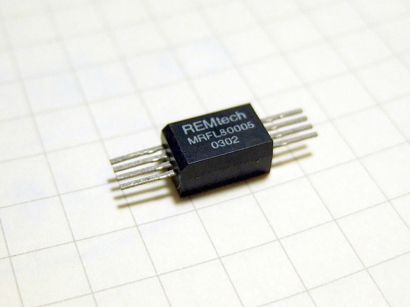

Offline MadTux
  • Posts: 785
Anyone know where to find those black or red low leakage reed relays used on the electrometer input of the Keithley 617?
Just finished fixing a couple of broken K617s from ebay (collected over the years and never really had time fixing them ;-).
I now have 4 working ones and 1 with leaky relay, maybe someone knows where to find replacement.
It was the only one that refused to zero input offset current (R348 trimmer, always displayed something around -.1500pA). Initially started by cleaning electrometer board with IPA and deionized water (which actually fixed some of the other "broken" ones), which didn't help in this case. I then replaced the "magic" input JFET (Q308) with 2N5909 (~$5 on ebay), which actually works really great (one K617 had toasted input and got fixed that way), but unfortunately didn't solve the issue here. I then had the idea of disconnecting all unused relays (K307, K309, K310) from the input stage to isolate the leakage path. With all these relays disconnected, the K617 input offset current would zero without problems. I then simply reconnected relays until I the input offset current problem started again. Found 2 suspect relays this way, which were then removed from the board and measured for leakage using my trusty Radiometer IM6 Megaohm-Meter/leakage tester.
Good relay has a resistance >1000TOhm @ 900V, while the leaky one (K309) has around 5TOhms @ 900V, which apparently causes enough leakage so that the input offset current can't be zeroed any more.

I could not find COTO 1240-0197 anywhere (aka Keithley RL-70) however I found COTO 7301-05-1000 relays (>1TOhm) in stock at Digi-key which may do if you cannot find anything else.  I "dead bugged" the new zeroing relay into the spot where the leaky relay was.
Here is a video showing the leaky relay that was replaced:
It would be nice to have some of the original relays AND a specification sheet for the original relays.  I can't find a specification sheet for 1240-0197 anywhere?
After replacing the relay it worked much better but getting full performance required cleaning BOTH circuit boards.  I got some laboratory grade methanol from eBay and used a small airbrush gun to blast the methanol onto those boards.  For safety reasons do that outside because of the flammable methanol and associated fumes that you don't want to inhale.
Does anyone know exactly how the zero-correct works?  Is it any different from suppress?  It appears that both zero-correct and suppress are executed by software.  I think this especially true because I cannot find any analog sample-and-hold so it seems just a software correction-no?

I'm quite busy lately, so I somehow forgot to write on how I fixed it.
Anyway, these red relays are quite easy to fix. Just pull out the old reed switch tube with some pliers and put a new reed  inside the relay coil.
The real magic lies in selecting a good reed switch. Forget the cheap crap from china, only a few GOhm of isolation resistance (because they have no sulfur hexaflouride filling). They will also start to arc at relatively low voltages (300-500V, usually). The original reed switches inside the red relays aren't that great either. (in terms of arcover and isolation resistance). For replacement, I finally found some afordable Harmlin MARR5 reed switches that are rated to an isolation voltage of 1000V and an isolation resistance of at least 1TOhm and fit inside the old relay coils.
 Real isolation resistance is more like 50-100TOhm @ 1000V, just at the limit where I can measure reliably. Also couldn't measure breakdown voltage, because my isolation tester/megaohmmeter only goes up to 1000V.
http://www.ebay.com/itm/Hamlin-MARR-5-Reed-Switch-SPST-NO-1-3-A-1000-VDC-10-W-10pcs-1-Lot/122199268347?ssPageName=STRK%3AMEBIDX%3AIT&_trksid=p2060353.m2749.l2649
http://m.littelfuse.com/~/media/electronics/datasheets/reed_switches/littelfuse_reed_switches_marr_5_datasheet.pdf.pdf
The only problem with these is that they won't reliably switch at 5V supplied by the 74HC04. So you need to overvolt the 74HC04 by applying something around 8V from the output of the first preregulator stage. (from emitter of Q309, placed some ceramic caps in there for good measure, too). I initially hacked an addon board so I can use 15V from C305 directly, but I got an noisy instrument afterwards, probably because of capacitivly coupled rectified AC noise. The it occurred to me that I might just overvolt the 74HC04 with some 8V from the 1th preregulator output, which worked.
Leaky black relays are a bit more difficult to fix, because the reed switch is epoxied inside. An option might be to drill it out. But I destroyed mine in the process, so I ended up replacing them all with Harmlin MARR5 reed switches and some reed relay coils I found on ebay. Doesn't look nice, but works just as good (maybe not as good as the red relay hack, because these coils have shielding inside) The coils are held in place by some copper wire and an eyelet soldered to the PCB, btw.

Did some more measurements on this REMtech relay, below are the results. Time scale is 10 sec per point, vertical scale 20fA per division. The leakage measured between the coil and both contacts together, the screen is connected to the screening box ground, voltages applied are 0V, +100V, 0V, -100V, 0V and +50V. The measured resistance after ~30 min is over 1000 Tohm for either 100V or 50V.
Cheers
Alex
« Last Edit: October 12, 2017, 02:30:50 pm by Alex Nikitin »
The following users thanked this post: 3roomlab, rastro
Offline Kleinstein
  • Posts: 14197
Much of the shown "leakage" current seems to be due to dielectric absorption and not true leakage: Especially the curve at 0 V is pointing toward DA, as the transients look similar for the -100V to 0 step and the 0 to 100V step. While this is not true leakage, dielectric loss can be still a problem in an instrument.
It might be interesting to also have a step like 100 V to 50 V in the sequence, as here the initial DA current and leakage would be opposite sign.
Online Alex Nikitin
  • Posts: 1177
    • A.N.T. Audio
Yes, it is mostly DA, as my overnight data also confirm. Unfortunately, DA is always present at these current levels, especially if voltages are reasonably high. I may try to do some more measurements tomorrow. I've tried 0 to 5V step and the leakage settled to <3fA step in less than 5min.
Cheers
Alex
« Last Edit: October 12, 2017, 03:38:53 pm by Alex Nikitin »

I won't expect to much trouble from the vacuum leaking out  :-DD , even with air inside this would necessarily high leakage.
I am not even sure they have vacuum. Low pressure gas could be a problem at high voltages though. Fancy HV switches might use SF6 gas under pressure. I remember using an electron microscope that had some of the HV stuff under pressure with SF6.
The problem is more likely with the surface. This could be inside the reed contacts if they were exposed to too much voltage and did deposit some metal. It could also be on the outer surface from some kind of contamination or just the plastic cover getting old. Also some glass might take up humidity, not much but it can happen and make an effect. There is a slight chance that a simple bake out of the relays could make them isolate better again.

Sorry for not being explanatory. I attached picture of relay which has mu-metal shielding and it should avoid "cross-talk" of excitation current when there are more relays crowded closely together. And yes, it decreases excitation current. http://pickeringrelay.com/pdfs/reed_relaymate_web-1.pdf page 6.
But this shield doesn't help in transient characteristic.
Since I have built new version of Gyro's picoammeter with some test jigs I made similar measurement to Alex.
I have a small test chamber with feedthrough BNCs. It is basically inserted between picoammeter and test current source (1.5V battery + 1TOhm resistor). Thats the orange background in graphs.
1) I attached non-modified Meder HI12-1A79 with shorted contact to feedthrough line and turned the coil ON and OFF.
Experiment was repated with my modified relay with shielding foil connected to box enclosure potential.
2) Similar experiment like Alex did. Shorted coil and put on voltage. I tried only 30V, but results can be seen.
Non shielded and shielded.
Shielding helps a LOT. It doesn't really matter in DC region since modern relay has excellent insulation materials. But I don't believe that repaired K617 would meet it's nominal transient characteristics and settling times.

One sleepless night with the statement of Kleinstein in mind an idea came up...
There was an unused ADA4530-1 sitting on the shelf for some time - would it be possible to replace the whole input amplifier with it?
In a nutshell the input amplifier formed by Q308 and U309 is just a difference amplifier.
As Q308 was already replaced and the performance was not what could be expected (I will come back to this later), there was almost nothing to lose.
First attempt looked promising in the amps ranges, but suffered from crazy offset and random jumps in volt ranges - smells like instability.
Nice thing is the direct access to preamplifier on rear panel, so no deal to quickly hook up the oscilloscope - it's ringing like a bell, journey just ends here?
The ADA4530-1 is a remarkable device considering nearly all of its properties, for example the GBW and open loop gain are higher than that of LT1012 (U309).
The 617 manual mentions that the 10nF C319 in the FB of U309 is needed for stability - maybe just a bit of isolation at the output needed to calm it down?
I throwed a 220k trimpot in and the issues disappeared, no instability in any ranges anymore.
To get the edge value for stability the trimpot was adjusted and the value measured was ~700 Ohms.
For a bit of margin a 2k2 resistor was chosen and replaced the trimpot.
This ended in the following configuration:
The 33k should protect the negative input up to 300V (spec: 10mA max at the inputs), for the positive input there is already more than enough protection given through 100k R333 and 10Meg R334 - even for surges (R355 not present in this unit).
As there was no 10nF in 2.5mm grid at hand, for now I put a 47nF MKS in - needs further investigation what is best value.
Seems with this replacement input protection Q311 is no longer needed as the OP AMP has input protection already - my early unit does not have it anyway.
To get an impression what this ADA4530-1 delivers, the bias current compensation and the input jack was disconnected (offset compensation already leaved with the mod in this unit).
As I would not trust old 4.5 digit ADC in this unit, my 3458A was hooked up at the preamp output.
After settling, the offset was ~300µV and bias current ~48fA (calculated) - no good sign.
I continued with performance verification of voltage ranges with help of internal voltage source.
Everything in spec according to 3458A, but the voltage source seems to have like a weared out 0V, sitting at ~200mV with horrible DNL between +-50mV.
It took me a while to realize that the output of the voltage source - even if disabled - is set to 0V and enabled all the time.
As the AD7541A DAC is in feedback, I would suggest this is the source, so put a better replacement LTC7541A on the next oversea order.
The last days the big reed relays were disconnected one after each other and bias current and offset were measured, so finally only 2pA range (K312) remained.
Disconnecting K307 improved much on bias current and now it is according to expectation ~3fA.
Every disconnected relay improved on the bias current, seems all have to be replaced - this turns into a costly repair.
Offset did not significantly change - as expected.
I guess the offset is mainly due to other sources and not from ADA4530-1 - will try to measure it in circuit later.
There is some work to do and diving into details will remain to later post...

After opening the package I scratched my head - obviously these were not the expected shining red Coto 1203-0147:  :o
872664-0
Received relays are marked with ARI (American relays?) 300RCA, did Keithley send me wrong parts?
After a quick search the picture of Keithley 3761 scanner card popped up and showed the same type - so they seem to be the newer versions of RL-181 (overview updated).
Next disappointment is that they are not direct drop in replacements - the spacing between Shield and Coil is narrower and Rcoil is 300\$\Omega\$ vs. 600\$\Omega\$ for RL-70.
872636-1
Investigation revealed that the Hex-Inverters U302/3 used for driving these relays are already operated near their current-limits - no resources left for the new relays.
My idea is to simply get 4 new 74HC04, throw out the current ones and stack two new ones on each other - any better suggestions?
The supply for 5V rail gets already damn hot - even without the old relays.
Seems to be a good idea to give U306 & Q309 some kind of heatsink - in particular with the more current-hungry new relays.
In the meantime the K617 demanded the next serious repair - never ending story  :scared:
Dremel-time: now EM-Board looks much more like a Keithley or - as we say - a swiss cheese.
872660-2
Yeah, this might be a bit of an overkill, but better to be on the safe side to have relaxed sleep when this unit is running unattended.
Hopefully this was the last surprise - steady I have less desire to work inside this K617 and more to work with it - but it was a good lesson whilst diving deeper into the world of attoamps & petaohms and how the circuits work to achieve that.
After repair the new relays were measured over several days, but this will remain for a follow up.
It is planned to measure the t-emf for self-heating - let's see if this will work out.
If there are more things that should be measured on these relays before they are soldered in, let me know.

Last summer I bought a Keithley 617 and it arrived not working.
The instrument turned ON alright but showed no correct value and the display fluctuated a lot.
I dreaded the repair, expecting it to be complicated and difficult to find the problem.
So, I finally opened up the instrument and found, that when I bypassed the triax input connector and applied a signal directly to the input circuitry, I got perfect readings.
After inspecting the triax connector, I found that:
1. the ground was broken off
2. the inner conductor was broken in to two pieces
Hmmm, never seen anything like this.
So, where to get a new 2-lug triax connector?
Almost to good to be true, I found a brand new one on ebay Germany for Euro 10 and installed it today.
The instrument is now working perfectly.
One of the easiest repairs ever.

Edit: R355 & Q311 were added after REV J, Q311 is for better protection of Q308 input JFET, not sure what R355 does - maybe isolation to C308 to protect against input transients?

These are the logs after changing to a LM662AIN (with case still open). Results look very similar to the Q308, peaks a little lower. I measured the offset voltage when in zero check, and was able to adjust it varying between +16µV and -18µV on the 2V output.

Some of the spikes could be from radioactive decay (radon gas) or cosmic rays. These can produce ions in the air and that cause such spikes. Air is a good isolator, but the air gap should not be to large and DC electric fields can matter.

I think the only relay that could be affected by DA this way is K307 for zero check.
It seems to be the most sensitive relay as it is always connected in parallel to measurement path.

DA cannot be reset by anything (except by time), it is modeled by parallel path with resistor and capacitor in series (or multiples).
So I do not think that this excludes K307 as source, but it may not be the only possible source.
Only simple way to check that comes to my mind is to desolder/cut lead of K307 from input side.

My thinking was that because the voltage over K307 changes between output voltage and ground when enabling/disabling the zero check, I should see a difference in slope.
But if we are indeed talking about DA charged to one of the high voltage rails, this little difference in voltage might not produce a noticeable effect in the slope.

The voltage source is now working. U124 needed to be changed.
So the displayed value is not changing in any of the functions. The LT1012 (U309) has a moving bootstrapped power supply as far as I can understand it. It is good. The reeds are also clicking when I change function.
I have measured that 89mV is going back to the motherboard on J1014 between pin 1 and 10 and 4. At pin 10 there is signal if K301 is operated. Should I brave enough to move W303 jumper to + or -5V? What is this for?
Also should I put a voltage here to the middle of W303?
UPDATE:
I measured voltage between U309's pin 2 and 3. It was 10mVolts. When I have applied a voltage to the input, the voltage was the same. But while doing this the displayed value changed.
Also I have measured the output of this opamp and the output was constantly -77mV while I changed the input voltage.
« Last Edit: December 04, 2020, 08:17:31 pm by balage »
Offline Kleinstein
  • Posts: 14197
« Reply #192 on: December 04, 2020, 09:36:33 pm »
The W303 jumper is for coarse trim / compensation of offset of the FET pair.  Remember where it started and watch out for ESD as the FET can be ESD sensitive.
10 mV across the input of U309 is normally too much - especially for an LT1012. So the U309 should be close to one side of it's supply (bootstrapped +-5 V) With a fixed output, there should not be much movement for the bootstrapped supply - more like close to +-5 V. The 90 mV shift is not much.

Q308 was replaced so something was around here before I get the 617. 9121TN is written on the case. Google shows nothing for that. The paired BJT is replaced a rude way...
So if at the inputs of LT1012 nothing changes when a voltage is applied to the triax then Q308 is dead, right? +/-5V from the bootstrapped supply is good.

 :o, that was indeed done in a crude way!
No,I would not look for a replacement fet, but I would do the excellent modification described by user Alex Nikitin: https://www.eevblog.com/forum/testgear/fun-with-low-leakagebias-current-femtompere-electrometer-keithley-617/msg759354/#msg759354
I had a good original Q308 and also did the modification, and the LMC662A is readily available.

I would start with the replacing Q308 by an LMC662A as described by Alex Nikitin. If you have to order parts, I would order an LT1012 also as it possibly also took a hit when Q308 died.
The following users thanked this post: MiDi, balage

Components arrived, old JFET removed, LMC662 is put in, LT1012 replaced. But now the 617 displays overload. :(
So I have measured the voltage going to the AD from the EM board, and now between pin 1 and 10 there is -225V. For sure, -225V!.  :-BROKE
How the f..ing hell can this can happen? Previously it was this:
Supply of LT1012 is still stable +/-5V. Maybe this bootstrapped bridge puts the negative supply to the central line that is going to K301. This must have damaged the AD. Great.

As far as I understand, the IV converter circuit should work like this
1129562-0" alt="" class="bbc_img" />
However, K617 connects the Rf to the In+ of LT1012. Why?
1129566-1" alt="" class="bbc_img" />
« Last Edit: December 12, 2020, 05:26:54 am by analogNewbie »
(Attachment Link) " alt="" class="bbc_img" />
That is because LT1012 is only functioning as a part of the amplifier (gain stage), and is not the complete amplifier. If you include Q308 (a differential input pair, which causes inversion), the figure is correct.

Thanks.
But Q308 is connected as follower not common source amplifier, right? the phase is not inverted in this stage
« Last Edit: December 12, 2020, 10:05:20 am by analogNewbie »

That's the result of the ingenious concept of the 617's output stage that keithley enabled to reach such an extremely wide output voltage range while still using "relatively" common input / gain stage components.
It's obvious, from a common point of view, the tranconductance amplifier stage appears to be connected the wrong way round (inputs reversed). And it's also correct, the input buffer (Q308) doesn't cause the polarity reversal. Instead, it's very important to have a close look at the power supply and especially the "grounding" scheme. The PSU for the output stage (+- 210V) isn't referenced to signal ground. Instead, the output terminal of the output stage that usually drives the load, is grounded, thus pulling the whole output voltage PSU "around", providing an inverted output signal at the output stage PSU's common terminal. And that's how Keithley's transconductance amplifier works, and also, why they use such funny (sophisticated...), staged and screened supply voltage transformers. This concept allows Keithley to drive the output stage with the low output voltage range available from the LT1012 by basically converting a voltage follower output into a true (common emitter) voltage gain output. Yet, this concept still keeps the voltage follower advantage from a biasing / driving point of view, eliminating all the voltage-shifting otherwise required.
The schematic is somewhat confusing since the multitude of supplies and ground symbols aren't always in direct view. It may be recommendable to print the page with the PSU schematic and have it always as a reference when working with the other schematics.
Edit: For a better understanding of the explanation, please see pages 6-5 and 6-6 of the manual. Observe where "Gain Stage Common" is connected to.
Edit2: Only now I noticed that Keithley made a mistake in the schema of the current output configuration: Both the "lower" supply and the transistor are of the wrong polarity (is NPN, should be PNP).
« Last Edit: December 12, 2020, 11:28:25 am by TurboTom »
Thanks for the detailed explanation, I missed that completely before.  :-+
Thanks for the details.  I have tried in the LTSpice.
What OP do you have in mind? The LMC662 has an ultra low Ib, that's what you want in the input stage to get the high input impedance here. It combines also 2 amplifiers in the same chip, that's from the thermal point of view also very nice. Also power supply is needed only one time ...
If the ADA4530 would be available as a double OP, I would use this one instead of LMC662 I think.
Guido
Science can amuse and fascinate us all, but it is engineering that changes the world - - Isaac Asimov
Offline Kleinstein
  • Posts: 14197
Yes the LMC662 and some other very low bias OPs come as dual.  Some, like the LMP7721, LMC6001 also come as singles.
I would todays consider something like an OPA202 for a simple low noise follower for the less critical path.
The second OP of the input stage could also be just skiped alltogether. The input side has a source impedance of about the required value - so no real need for an extra buffer. A slightly differenten resistance would change the BW a little, but not much and a different cap could correct this.
The 2 nd not really needed OP would add to the drift an noise. With the JFETs it makes sense to have 2 to get drift compensation.
However with most OPs the offset drift of the duals does not correlate that much. So the 2nd OP is not really compensating the drift and definitely adding to the noise.

Online r6502
  • Posts: 129
Hello All,
I took a look on the input stage of the K617, electrometer board, Rev. 0F. Please take a look and comment it.
This schematics of the input stage is different from the later versions, available as download.
Kind regards
Guido
corrections:
the 2 Resistors in the input line are 1st 10Meg an then 100k
the 2 resistors at the bottem, connected to the JFET and -5V(B) are 200k
« Last Edit: August 24, 2021, 10:41:06 pm by r6502 »
Online r6502
  • Posts: 129
Hello All,
meanwhile, i managed to get the device to do something ;-)
the following parts have been defect:
  • input double JFET, replaced with 2N5909
  • defect LT1012, actual replaced with OPA177
  • defect trimpot R348 and R314
  • defect -5V regulator LM337LZ
  • defect MPS-U60 PNPs in the end stage (Q303, Q305 and Q307), replaced with MJE350
Parts that have been replaced, but have not been defect:
  • all electrolytic caps
  • MPS-U10 NPNs in the end stage (Q301, Q304 and Q306) have been replaced by the MJE340, so they fit to the MJE350
Now the instrument is in the status, that it shows real values and no nor "OL" in all ranges. Voltage works fine, but I'm not sure, what's with the input impedance. I have bought 10 2N5909, and selected the one, with the lowest leakage current. I measured the leakage current at 5V reverse voltage with my 616 electrometer. The measured current varies from about 2pA to 0.2pA.
I will replace the input OP with the original LT1012, when they arrive here.
With the input double JFET's I'm currently not sure, if I want to keep close to the original design with the double JFET, or switch to a modern OP like the ADA4530 or so. If I go to the ADA4530, this will also replace the LT1012 ...
So at the next weekend I will continue with the performance check first before I do further modifications - luckily I also own a 263 current calibrator with good performance, so it will also easy to check the lower current ranges.
I will update you here, how it goes on with repair / performance check.
Guido

Offline Atomillo
  • Posts: 205
After couple of hours warm up, zero checking makes it read 0.002pA. After correcting and releasing zero check, the current jumps to about 0.3pA in two seconds or so but stays quite constant there.
I think there is indeed something fishy then. Should I start connecting and disconnecting relays to see if there's anyone leaky?

First suspect is K307, it is the only relay that changes between zero check and normal operation (see p. 142)
Offline Atomillo
  • Posts: 205
In the highest voltage range, zero checking makes it read 00.00 no problem, nothing changes.
After releasing it, it slowly climbs up to 1.10V in about 1 minute (slightly less) and then stays constant
Yes, after about 2 minutes it only changes about 10fA.
I will disolder K307 (with all the necessary precautions given the high impedance environment) and report back!

Offline Atomillo
  • Posts: 205
After desoldering cleaning and letting about 25 minutes for it to settle, the reading is very stable at 0.25pA.
So a bit of an improvement but still far away.
I will now reconnect K307 and try disconnecting K310 and if that doesn't show anything different then K309.
EDIT: K309 is okey, after disconnecting it the reading didn't change. Time for K310
EDIT 2: The same result is obtained with K310.
Thus, the relays all seem perfect!
It now seems to me that the only candidates left are the two transistors connected as protection diodes or the JFET itself. In that case, I would have to do the LMC662 mod. I will first check the transistors though
EDIT 3: Removing the protection transistors makes an inmediate difference. The current now is 0.15pA!!
Now, there only remains one big problem which I don't know how to solve. Simply inserting the screwdriver into the Input Current Adjustment trimpot makes the reading violently change. Turning the trimpot and then stopping doesn't change any of the readings.

You removed Q311 (metal case)?
If that changes the current I would guess there is a problem with the bootstrap common (amplifier output).

I've got bad news I'm afraid...
I disconnected the bias adjustment giga ohm resistor and found no improvement whatsoever.
Getting desperate, I reviewed all the schematics one more time and found one relay that I didn't check: K311.
After disconnecting it, the current plummetted to around 0.012pA and the meter is extremely sensitive to me just moving in the room.
So know I have one of the dreaded leaky relays...

Offline Atomillo
  • Posts: 205
Some good and interesting news:
After replacing the leaky relay with the one from the miliamp ranges and recleaning carefully the board, after about 1 hour and a half the current settles down nicely at 32fA (0.032pA) in a very stably manner and can be offset corrected with no problems (I've not performed the current cancellation yet). This is without the BJT protection diodes.
Of course with no relay in the mA range selecting such a range shows only OL. I do not think I will ever use it but knowing it's not "feature complete" leaves me somewhat unhappy... As soon as I can I will order the reed switches posted before, which should be drop in replacement if I manage the extract the existing one without damaging it.
Also I think I've determined conclusively that the protection BJTs add some extra leakage. With them connected the input current rose to about 65fA. Not a huge difference but a noticeable one in this very sensitive meter.
Changing the relays has been a nerve wrecking experience. I don't know why, but solder almost doesn't "stick" to this board. Solder wick didn't work either so in the end I had to "pull" the relay out... The results are NOT pretty and my mental well being was seriously compromised  |O. Any tips as to why this might be would be very much appreciated since eventually I will have to put the relay back!!! Is this common on old boards like this? Specially the shield pin seemed like it would just not fit. Or I just doing something wrong? The "black" traces are cleaning residue that were properly taken care of after taking the photo.
EDIT: I forgot to mention I've done my first "low current" measurement! Just connecting a 1G resistor to a power supply was able to check the nano amp ranges and the first of the pA ranges. It worked without any issues!! Now I'm looking for a proper triaxial cable and after reading the forums it seems that in order to get a "safe" option paying 120 euros for a Pomona 4725 is the best idea.

I purchased a 617 recently and had overload on every range.
I changed all the electrolytic caps which made a significant difference in that the ranges no longer read OL, but some non-small number instead. I also switched out all the relays to the Meder Electronic (Standex relays) MFPN: HI05-1A66 rather than the COTO relays often mentioned in this forum. I was just curious as the insulation resistance is specified to a minimum of 100 Tohm so should work quite well. One downside to these though is that the coil isn't encapsulated or potted so could accumulate surface dust etc. which would effect measurements.
I would describe the board condition as being rather good.
After changing the relays, I have a leakage current of around 17-19 fA after keeping the unit on for two hours and after cleaning all the flux off the board with lint free cleanroom swabs dipped in isopropyl alcohol. Next I want to swap out Q308 for Alex Nikitin's LMC662AIM however I'm a bit confused about the pinout for Q308. After analysing the photographs of people who have done this and posted to this forum, I have come up with the pinout scheme; so, each arrows represents where the pins of the LMC662AIM will be soldered to once Q308 has been removed. Could I ask for a spare pair of eyes on this just to make sure I have this correct?
Pointing out any glaring issues is greatly welcomed.
All the best,
Ryan
« Last Edit: August 30, 2022, 08:25:39 am by The13thParish »
Offline _Wim_
  • Posts: 1523
All the best,
Ryan
A bit hard to see if everything is correct. The -5V does not seem to be correct (seems connected to ground instead of -5V)
Best way to check is with a multimeter in short circuit mode to check if the below is correct:
* pin1 in the attached drawing must be connected to pin 3 of U309
* pin5 in the attached drawing must be connected to pin 2 of U309
* pin7 in the attached drawing must be connected to R351,R352 and R353
* pin3 (input)  in the attached drawing must be connected to R333
* +5V must be connected to R340,R315 & R319 and pin7 of U309
* -5V must be connected to pin 4 of U309

I'm having a little trouble correlating the pin numbers of the Q308 on the schematic to the physical form of the TO-type can as soldered on the board. The can has six legs; does pin number 1 correspond to clockwise after the little tab sticking out, or anticlockwise?
If I also understand your comment, there is a clip with wire soldered to it that clips on to the body of the can, I take that this is ground?
All the best,
Ryan
Offline _Wim_
  • Posts: 1523
That is why is it easier (safer) just to test with a multimeter in short circuit mode. Connect one lead of the multimeter to pin 3 of U309, with the other lead you can test all the pins of Q308. If it beeps, you are connected to pin 1. The same can be done with the other pins you need with the list above.
Yes, that is ground. But you do not need ground to make this mod.

I'm currently working on a K617 with rev L board.
I've already replaced the input FET, Q308 with the LMC662 and the unit is already working to some extend.
What is interesting with my unit is that the current reading in the lowest current range decreases over time (~5h) until it reaches equilibrium / thermal balance. See attached figure (X-Axis in hh:mm). This effect is repeatable. To me, this suggests some semiconductor is leaking but I'm not sure where to start the hunt. Any pointers are very welcome.
Attached is a picture of the mod with the THT version of the LMC662. Not proud of the soldering, would have preferred the SMD version :).
My notes with the pin numbering and my way of the output resistors selection.

When looking to the graphs from user Alex Nikitin and his LMC662 mod, I see around ~3fA drift over a period of ~1h or ~6fA over 24h. I did as well a test where I opened the lid of the unit to allow the unit to "cool down" a bit and the input current stayed at the current value or slightly decreased. This suggest to me an effect linked to internal temperature increase.

« Reply #330 on: December 19, 2022, 10:18:18 pm »
I may have a stupid question, but from the schematic, I cannot figure out where is leaking into the feedback path if the relays are bad. My naive thought is that's not very different from having a lower valued feedback resistor, which will only reduce the reading but not give a offset. And the guard is supposed to drive the shield at the same potential (+-1mV), so leakage from there also will not contribute to offset. What did I missed here?
That is definitly not a stupid question!
Leakage between the contacts would only effect the gain, but not the offset.
Leakage into the input gives an offset, e.g. 1mV with 1TΩ guard (ES/preamp out) to input gives 1fA.
If both leakages would be constant over time & temperature, they could be compensated/calibrated.
Crunching my numbers, the critical relays combined (K307, 9, 10, 12) had at least 2TΩ from ES to input (Relay resistance) and the offset current was ~50fA (from here).
That would need ~100mV between guard (ES/preamp out) and input, this does not compute with expected 5mV (50fA through 100GΩ) :-//.
Another question, after modding with ADA4530-1, is it still necessary to install the bias current compensation R332, R348? From the datasheet, the input offset of ADA4530-1 at room temperature is sub-fA, maybe we can leave that out to reduce the noise (thermal from 250G R332) by a bit? Also Q311 can be removed if we trust the internal protection in the opamp?
It would be counterproductive to have that bias compensation with ADA4530 (it includes bias TC compensation).
ADA4530 has internal protection, so Q311 is not needed anymore.

Today, I received my  Keithley 617 with very good condition. it was made in 1991 or 1992, and last cal time is 1999. when I power on it, on current and 2pA mode, no input, the read is change from 20 counts to 300. Now, I have work to do. ;D. maybe need clean the pcb first and change the capacitors .
I would only attempt cleaning if the PCB is really dirty and changing capacitor if you really suspect them to be bad. Also always wear clean cloves when manipulating the input board.
But what is the problem exactly with your unit ? if it's simply a offset after removing Zero Check, check the manual page 7-5 chapter 7.4.8 "Input Offset Adjustment".
« Last Edit: Yesterday at 12:57:47 pm by Kosmic »
Maybe just place a short on the input and watch it again.
Some charge can caused this,
You don't place a short on the input of a transimpedance amplifier (such as an electrometer in the current measuring mode), you use a screening cap over the input (or just a bit of an aluminium foil) !
Cheers
Alex
Very true, my mind was somewhere else, thanks for pointing this out!
