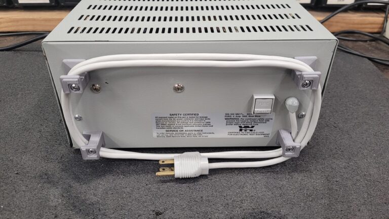

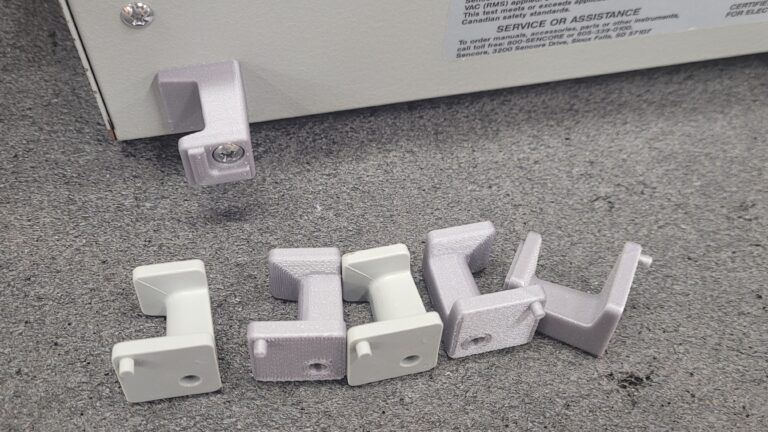

Rear Foot to Suit Hewlett Packard 5300 A & B and other Split Aluminium Cased HP equipment.
Fairly simple to start this thread off. 3D printed solution to what seems to be a fairly common failure of the original plastic foot. Printed in PLA as pictured with supports on the bed. Use 0.1mm Layer height if you want a smoother look but no one else should be looking under there to see ;)
Zip file contains both the STL and Fusion 360 CAD file.

Same Aluminium case design but more specifically for the Hewlett Packard 5300A and 5300B with the quick release mechanism.
These models use a two piece clip to hold the circuit boards and front and rear split fascias in place as shown. Between the two I have at present they had a broken one of each. Today's project D&C a new one using Fusion and 3D printing again but made as a one piece item.
Mk1 and MK3 shown less parts and better clearance for the circuit board. Printed with the Web facing down and bed supports only. PLA 0.1mm height recommended.
Zip contains the STL and Fusion Cad file.

I've been working on the old style HP feet. Part number 5060-0767.
Still have to work out how to make the spring-loaded retaining pin, probably using an M3 cap screw, spring and nut or something.
The following users thanked this post: GregDunn
You can fairly easily buy Flat Head Rivets in all sorts of lengths and diameters if you want to keep it more like the original. Try a Google search for "3mm flat head aluminium rivets" The 3x5mm collar and spring should be easy to sort out.
The few older Nixie Counters I have with those feet came with all attached  ;D But keep on with the design  :-+

« Reply #43 on: March 14, 2019, 12:52:52 am »
Looks like making something to do the job will be easy. Making a look alike without a sample impossible and not really that important I guess.
https://youtu.be/Cmz8bzUsj7E?t=1038
If you can measure the footprint or even the area available and where the screw sits relative to the edge and it's dimensions and a height needed to clear the transformer cover is all we would need to roll you a design based on the Tek one shown earlier.
Offline tautech
  • Posts: 28328
Re: Replacement Knobs, Feet and Fittings for Test Equipment
« Reply #44 on: March 14, 2019, 01:27:16 am »
Yep, them's the buggers.
As these HP's use an IEC lead there's really no need to have slots for the mains cable but the feet do need to be long enough to give good clearance for the CRT cover to ground.
Remember, these also used insulating feet for the days when it wasn't frowned upon to float your scope.
1/ So length required is 40 mm.
2/ Screw CL to case side edge max 10.5 mm. (so 21 mm min wide and square)(see 4 and 5)
3/ Screw CL to case top/bottom edge max 15.5 mm.
4/ Back panel to case edge/rim step 2.2 mm (in case you want to step up over it and make the foot slightly larger to the case side edge.)
5/ Case rim width 3.2 mm.
6/ Standard screw: remaining meat at bottom of screw recess 13.5 mm.
7/ Screw allow 3.5 mm dia.
8/ Screw head/washers allow for 8.5 mm dia.

Literally 5 minutes work.
Strongly suggest you run the bolt nearly full length to avoid layer shear. If the screw is to stay at 3.5mm then running a tube outside of that will help a lot so 3.5x5 or 6mm? Personally I would look and see if the chassis can be drilled and tapped to maybe 6mm?
The Foot outer I have made 31mm Square so a 5mm lip, partly it will give better stability when sitting on the feet but also would allow cable wrapping. The lower square is 21mm BTW
Simple print job when finished and I will send you a couple of sets over to play with.  :)

Yeah they could be improved some however without cord slots they should be stronger.
I've allowed for 5 mm screw thread engagement with the standard screw that while this 1740 I have here has zero feet all the screws are there.  ::)
While I could put bigger screws in most that own these would just want a drop in replacement so it's a shame we haven't got the original length so ppls could just print one or two to suit their immediate needs.
Thought you'd add a lip.  ;)
Thanks again, that's very kind or you but these are a commonly missing/broken part and I was just trying to add to the great future resource you're building.
Only got one unit here and not likely to be chasing another as this was a freebie I'be had for some years and still haven't got around to fixing.  ::)
One set will be fine.  :)

Extruding down to the lower level of 13.5mm is easy as is dropping back to the 3.5mm hole (3D print cross sections shown done below). The major difference with 3D printing over injection or rubber molding is the layer shear strength. As a design I will post a drop in replacement and a 6mm bore as shown above.
Some of the shear issue can be helped with the use of PETG (in my case as I don't currently run nylon or ABS) and raising the perimeter shells and infill. Below is 6 perimeters and 40% infill. The area will remain the weak point without the bolt running full length. The infill could be pumped up which will help a bit but it becomes the law of diminishing returns as it is still a point load at the head of the screw.

Understood and still reminding you the feet should provide full insulation so any metal fixings needs be recessed some.
BTW, we might be best for someone that has a HP1740 to chime in with the correct length for the feet.
Version one with the 6mm full length still allowed for 6mm recess and 12mm OD head. The hardware 6mm ugly below is 4mm x 12mm so it should be easy to get one for a long bolt option.Bumped the diameter of the recess to 12.5mm. 2mm clearance should be ok to 1000V+

Foot - Generic replacement for HP 5040-7829 cord wrap foot, fits HP174* CRO's.
40mm Long generic  foot as shown. Two STL's in the Zip a high strength 6mmx34mm depth and a drop in HP hardware replacement for 3.5x13.5mm screws on the scope. Also included is the Fusion 360 Cad file for others to play with.
Suggested 3D printer settings 6 top, bottom and side perimeters and 40% infill. Material choice minimum PETG or better Nylon if you can. 0.2mm Layers and support on the build plate only to keep the recessed hole looking nice.
So my design guess was WRONG it seems the real deal only had a lip on the outside ;) From here http://hpmemoryproject.org/an/pdf/sf_1700.pdf
Let me know if you want the design shortened to the 1 3/8" and I will tweak it, what isn't shown is if it is measured from the case or rear fascia so 40mm is safe. I think for strength keeping the more blocky 3D printed  version is sensible pending anyone having better images or one to measure from?
:clap:
Good find and checked the 1 3/8" (~35 mm) which seems perfect with ~4 mm clearance from the CRT cover to ground.(excluding any fascia height measurement)
IMO ~35 mm is the height we want to work with in this metric day and age.  :-+

Looking at the bad photo I am actually wondering if they were made from the same soft plastic on the 5300's I made new feet for rather than a rubber. What was left of mine basically crumbled into pieces and the rear shot of Daves looks like that same sort of issue?
Edit Adding the 35mm Foot here due to the 1Mb file size limit   |O I will add it to the link index on the front page and leave both available.
Modded Fusion file and both STL'in the Zip for 6mm Long Screw and the Genuine HP screw options.

In Sli3er for example after you slice the print you can look at a 3D preview of the print. I use this in most cases before starting longer prints. Go back to the last page and you will see the spaghetti version when reviewed with 'detect thin walls' on. https://www.eevblog.com/forum/testgear/replacement-knobs-feet-and-fittings-for-test-equipment/msg2257833/#msg2257833
Just for fun here is a 6 layer 40% infill in PLA of the 35mm Foot printed on the Ender Pro. My CR-10 with the glass Bed is where I will print the PETG ones for @Tautech is partially stripped down while I put it into an enclosure.
Sheared as expected at the screw head but even in PLA took a fairly severe whack to get that to happen, I would hope most of us don't treat our gear like that  ;) . PETG will give it more layer strength and a little more flex which will help it soak up some more punishment. The oposite end of the hammer is actually a PETG insert I made over a month ago and is holding up well unlike the PLA sample one which failed quickly.

Holy hell Bean, that took a whack before it broke.  :o
Should be more than strong enough IMHO.  :-+

It is not too hard or expensive to find the HP snap in feet used on a wide variety of small instruments including the 3468B multimeter, but it is was a fun challenge to model and print.  There are a number of functionally equivalent model numbers (at least as far as I can tell).  5040-7201, 5040-7222, 5041-8801 and 5041-9167 are ones I am aware of.
This is not an exact copy of any of them.  Changes were made to suit 3D printing and to make it easier to model.  Also the instructions molded into the foot were omitted.
Sliced with Cura, best printed feet down, 85-90% fill, with gyroid infill pattern, and zig-zag supports everywhere.  I used PLA+ filament at 210C and bed temp of 50C.  Any elephant footing will kill the ability to fit mounting holes, so if you have some trim or sand it down.
stl file updated 10/18/2022 for better fit and to eliminate a geometry problem.
HP 5041-7201 -rev a - copy is an .stl file, renamed to meet forum naming restrictions.  Change the extension to stl and it is ready to use.

I got bored last night so I came up with my own version of the rear stand-offs for HP gear.
Someone might find it useful maybe..
https://www.thingiverse.com/thing:3606417
BTW, does anyone know what the thread size is for the screws for these things? I'm having trouble matching it up to anything..

Rear cable wrap feet and wire securing clip for Tektronics 500 series mainframes and 400 series scopes.
Edit: I have to ask for your HP feet why you didn't flatten off the middle area instead of doing 1:1,
Not sure if this is Rerouter but is sure looks like his design eBay auction: #283800016690

Think they printed them with the layers in the wrong orientation. Looks like any pressure would snap the fingers off. Mind you at least that's an original feature  :-DD

Usually I mount 38mm 'adam hall' rubber feet with a printed plastic nut. In case it falls off inside the device, it will cause no problems.
My new old HP6653A power supply does not have a bottom cover plate, but the chassis itself is the bottom. So it would be a lot of dismounting to place a nut inside.
So I'm back to HP's hook and lock system.
The avaiable print models copy the plastic spring locking of the original.
As prints often do not reach that level of plastics quality and precision I was not conviced and scribbled another solution:
The locking is done by a locking plate with konical cotters and is fastened by a screw.
On top is a furrow to allow pliers to grab and pull out the locking plate.
On top of that I mounted the usual rubber feet to save table tops or other device covers.
The front alignment key part of the HP feet is not that important for me. I place to 4mm threaded holes in the front of the feet, but obviously this was not planned to the end.  :palm:
Anyhow, for me, it does the job for now.
You can find the STLs without the front holes in the zip file attached as well as on thingiverse:
https://www.thingiverse.com/thing:5352112.

A few days later, another one:
Rear foot for a Sencore Powerite II PR570 variable isolation transformer - will probably fit other equipment from Sencore as well, there are a few things in this form factor.
https://www.thingiverse.com/thing:3624712
Thank You, Printed Some Fit Great... https://www.stevenrhine.com/?p=132208
