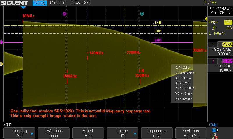

Btw, this unknown other scope is factory original 200MHz. I do not know its 500uV bandwidth but there is not forced BW filter and some suspect that it is around same as scope other voltage bands(?). Using higher voltages there is -3dB point around 240MHz.  In picture can see also things what leads to suspect  that this "ultra low noise" scope 500uV/div is not true analog channel...it is vertical digital zoom only.
Siglent 500uV/div -3dB point is around 270MHz.  Higher voltages(eg 50mV/div) -3dB is over 280MHz.
Of course testing is required to ensure that the environmental EMI has not affected the high impedance input.  These are so obvious basic fundamentals.

Offline rf-loopTopic starter
  • Posts: 4105
Re: Siglent SDS1000X and (MSO) SDS1000X+ series oscilloscopes
« Reply #80 on: August 07, 2016, 03:40:29 pm »
Did you properly terminate the BNC cable at the input of the oscilloscope? You have to select input impedance of 50 ohm in the oscilloscope to avoid reflections, which will lead to a reduced amplitude level.
In video it looks more like there is probe connected to SDG output. So if this is correct termination and for look scope frequency response...  no, there is nothing right for this purpose.
@snic ask if this is normal with this scope.
I can answer, if we do not know anything but what is in the video. Yes this is very normal for this kind of playing.
Btw, where is SDS1102X front panel knobs.
This is example about how oscilloscope frequence response can not measure at all. With this method can only "wonder" what all "miracles" happend...
Btw, oscilloscope probe in SDG output...  source impedance is 50ohm.
If look only one thing (and there is many what affect) probe cap is around 20pF if it is "usual" around hundred MHx 10x probe.
If it is 20pF with 10MHz its reactance is around 800 ohm.  With 100MHz  reeactance is around 80 ohm. Think about it.
Oscilloscope frequency response measurement need constant level over frequency band in scope input terminal and exatly just there. (also this is much more complex thing if look even bit more deep.)  Example. Someone have scope what have 1Mohm input and input capasitance is say example 15pF.  Now one connect 50ohm feed thru terminator to input. Then he happy believe his input is now 50ohm input. Bullshit. Only for DC.
I drive a LEC (low el. consumption) BEV car. Smoke exhaust pipes - go to museum. In Finland quite all electric power is made using nuclear, wind, solar and water.

Do you know really this SDG flatness up to 100MHz. This is SDG2042X.
What you know about actual  real signal level in oscilloscope input terminal.  Do you have any instrument for check it.
This because I do not trust this SDG2042X level accuracy with 100MHz (and specially when load reactance is what ever)
One other thing. Do you have good quality feed thry 50ohm terminator. If you have, do test so that you use scope input high impedance with this terminator.  Then other test without it and scope internal 50ohm as termination. As short 50ohm coaxial as possible.  Also if you have example 10dB atenuator, put it to scope input when use scope internal 50ohm.
Then use (just for reference) 300mV-pp sinewave for test.
In some message you say Hantek cheap scope show it better, you think. How you know it show more right. it is other and good question.
If you can not see difference when you measure with this agilent probe connected directly to SDGoutput BNC and then good coaxial  terminated with 50ohm, sorry but it is hard to belive. I expect least some visible difference. Not only between 10 and 100MHz points but also in whole response shape. (with peak mode, roll, and SDG sync you can produce whole response curve.
Until you know what is signal level really in scope input we can not say anything sure.
Is it possible you can use real trusted leveled RF generator.
I have measured several SDS1102X scopes and everyone -3dB point related to 1MHz reference level is always over 140MHz with all V/div settings in two bottom V band. (whole V range is divided to 3 bands)
And for sidemark, I have measured lot of Hantek's (as I previously have sold these, and I teest every single scope what I sell, everyone. I know what its freq response hassle is - really. So if Hantek tell signal flatness is better, it can be true or it can be wrong. Of course it is possible it is more right but, with tens of Hantek experience, sorry but I do not believe anything what this crap show until I really know individual Hnatek what I have measured then I can somehow trust how much it lie. (all scopes lie, indepeendent of brand and price, one less than other etc..

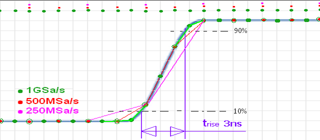

I have not now enough time to analyze your "findings".
But one first note.
Your signal have quite fast edge.
Now when you turn 2 channels on, maximum samplerate is 500MSa/s.
It means there is one sample every 2ns.
As can see your image where is 2ns/div with 1GSa/s (one channel on) and then right side image 500MSa/s (2 channel on) it is natural that there is high aliasing. In this case aliasing can see as "corners wobbling". This is NOT at all related to manufacturer. it is pure math and physics. Even Siglent can not break base fundamentals.  It is well known that this scope BW is highly over 100MHz. If it is rehjected to 100MHz and after then BW shape drops steep you can not see this effect, because in this case ADC can not see this fast (rising) edge, if edge rise is limited to over 3ns you can see very small amount of corners aliasing. (Alisiang components are this waveform harmonics)
Now situation change if you shut off Sin(x)/x interpolation and also do not use linear interpolation. Just use dots. Now you can see corners do not "wobble". But, you see more or less dots but perhaps not coninuous line because it have limited wfm/s speed. Turning example 1s persistence may help more nice visibility.
But overall this signal breaks oscilloscope specification (rise time).
If you take oscilloscope what analog front end before ADC is not so wide you can not see this effect because front end limits signal risetime.   Of course if there is more fast samplerate this effect also disappear. As can see when you use 1GSa/s.
It is very important to know signals fundamentals and also oscilloscopes fundamentals.
Then you tell it goes to "roll mode".  Yes, it is default.  But pushing one button you can go to normal sweep mode. And doing trigger setup  you can adjust more things. Example if you set 500ms/div and NOT roll mode. You get 7 second long capture but of course samplerate is only 2MSa/s. (so in practice max sinewave frequency around or under 700kHz and otheer waveforms so that its harmonics stay (enough) below Nyquist frequency (sample frequency / 2).
And also it need note that in this case you need wait before see anything on the screen (of course).
External trigger do not at all have same trigger performance than main channels. EXT trigger use analog side pathway trigger system what have been very normal in digital oscilloscopes also in main channels.
Siglent main channels use full digital side trigger system. But EXT trigger do not. And it can see - lot of more  time jitter and not perfect signal fine adjustment to trigger time position. Main channels digital trigger system outperforms most old digital scopes conventional trigger method just hands down.
Also specifications tell that EXT trigger performance is highly reduced. <100ps trigger jitter is specified only for CH1 and CH2.  It reads clearly in data sheet.
Here some examples and about basic fundamentals you can find useful readings from many sources, also from Keysight, Tektronix and R&S application notes etc.

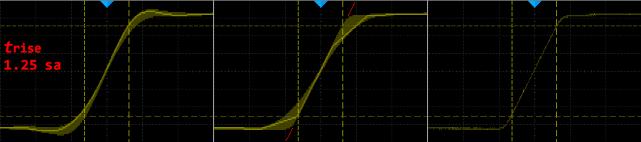

Here only linear interpolation and dots. Sin(x)/x make lot of more bad things when we go too near f Nyquist.
It is normal  that experienced user also know that Sinc interpolation is not always best for not sinetype signals.
Sine, Linear, Dots. Persistence on.  In this image input signal trise is adjusted so that there is  ~1.25 sample for trise (10%-90%)
Note: As can see,  using linear interpolation and persistence there can estimate also true risetime. (red marks) (as long as oscilloscope analog BW do not reject risetime.)
One "problem" specially for unexperienced (I do not mean length of experience but quality of experience) users in example this Siglent model is that analog front end frequency bandwidth is bit too wide, specially if think lower than 1GSa/s samperates in use. Avoid problems with this, need know how to do. But, peoples want "high Bandwidth..."
Here example one individual SDS1102X
As can see f Nyquist (500MSa/s) is not attenuated even 6dB.  It is clear that fast risetime to input leads lot of aliasing and in this case one special form of aliasing: "corners wobbling".
Know your equipment for better measurements is rule number one.
