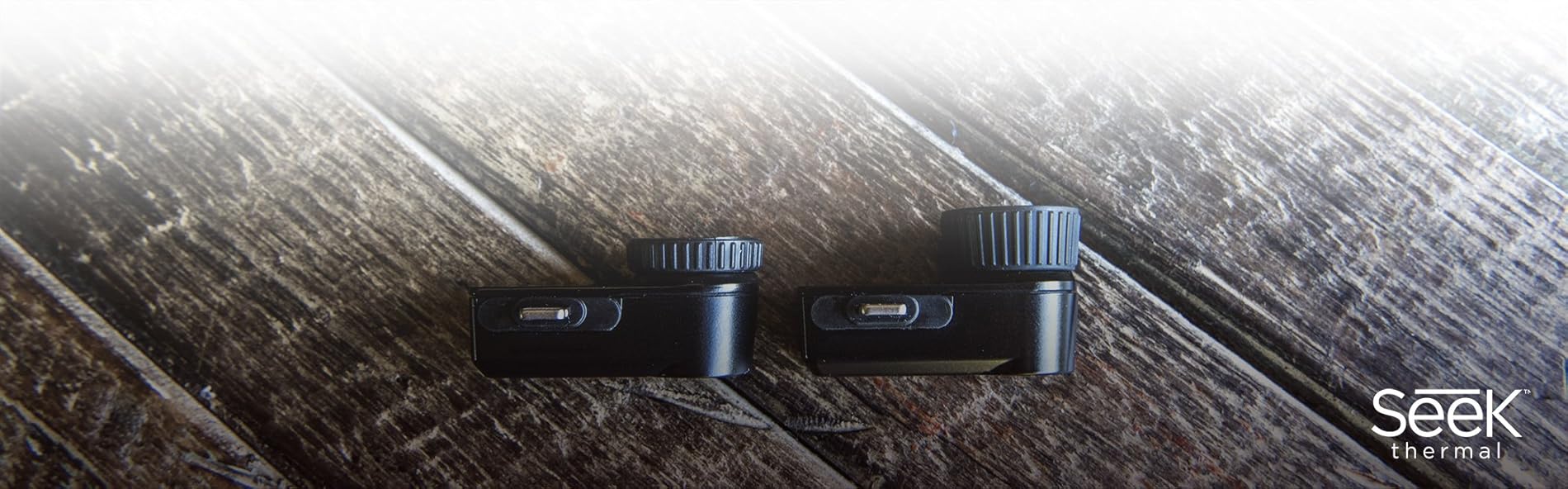

Today UPS deliverd my Seek (Non XR-Version). Actually I want to buy the FLIR One (second gen.) but its very hard to order here in Germany... *sigh* I gived up to waiting  :(
And thats why I orderd the Seek for iOS. (FYI, I ordered the XR-Version 3 Weeks ago but sell it again and orderd the non XR Version to days ago!)
But today there was a little surprise: The non XR-Version has a focus ring!  :scared: I'm not sure if Amazon send me a wrong product.... I dont think so! Or it is a new Version. Because the Ring is much smaller!
Its hard to tell if the Focal length is similar to the XR-Version.. maybe you guys can help me

This is definitely a new model:
Offline in.Vitro
  • Posts: 50
Re: Yet another cheap thermal imager incoming.. Seek Thermal
« Reply #1959 on: August 06, 2015, 10:38:04 am »
But the question is: Why is it labeld as "non-XR"? I mean, its obviously the XR because when I strech my arm and make a "selfie", my whole face filled the frame (yes, I have short arms :D )
The Ring on the "new" Model is about 5mm thick.. I would gues on the XR is the thickness about ~7,5mm? right?

Good News!  ;D
Its a new Model (Hint: look at Amazon ;) )
this little sucker has impressive macro capability!!
I hold the Cam ~3cm above the PCB
