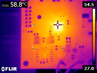

« Reply #11 on: August 17, 2018, 12:38:59 am »
Hacked E4 (320x240):
Hacked E4 with lens from https://www.ebay.com/itm/321078811086 (19 mm ZnSe, unfortunately I don't recall the focal length):
The smaller components in this screenshot are 0402 (US).
Checked lens with Geiger counter with alpha window, no radiation detected.  :o

« Reply #12 on: August 17, 2018, 03:42:40 am »
Thanks for posting those. That's a really impressive level of detail. It's also very moving, in a way, to be able to see the heat rather than just running an equation that predicts it.

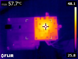

« Reply #15 on: August 18, 2018, 11:46:55 pm »
The lens I posted a photo of above is a meniscus lens. Here are a couple images form my E40, the first image with the stock lens focused as close as it can manage, and the other of the same board with the close-up lens as close as it can focus. Do note that I didn't bother squaring the lens with the subject, so focus is only optimal in the area of interest due to very shallow DOF.
