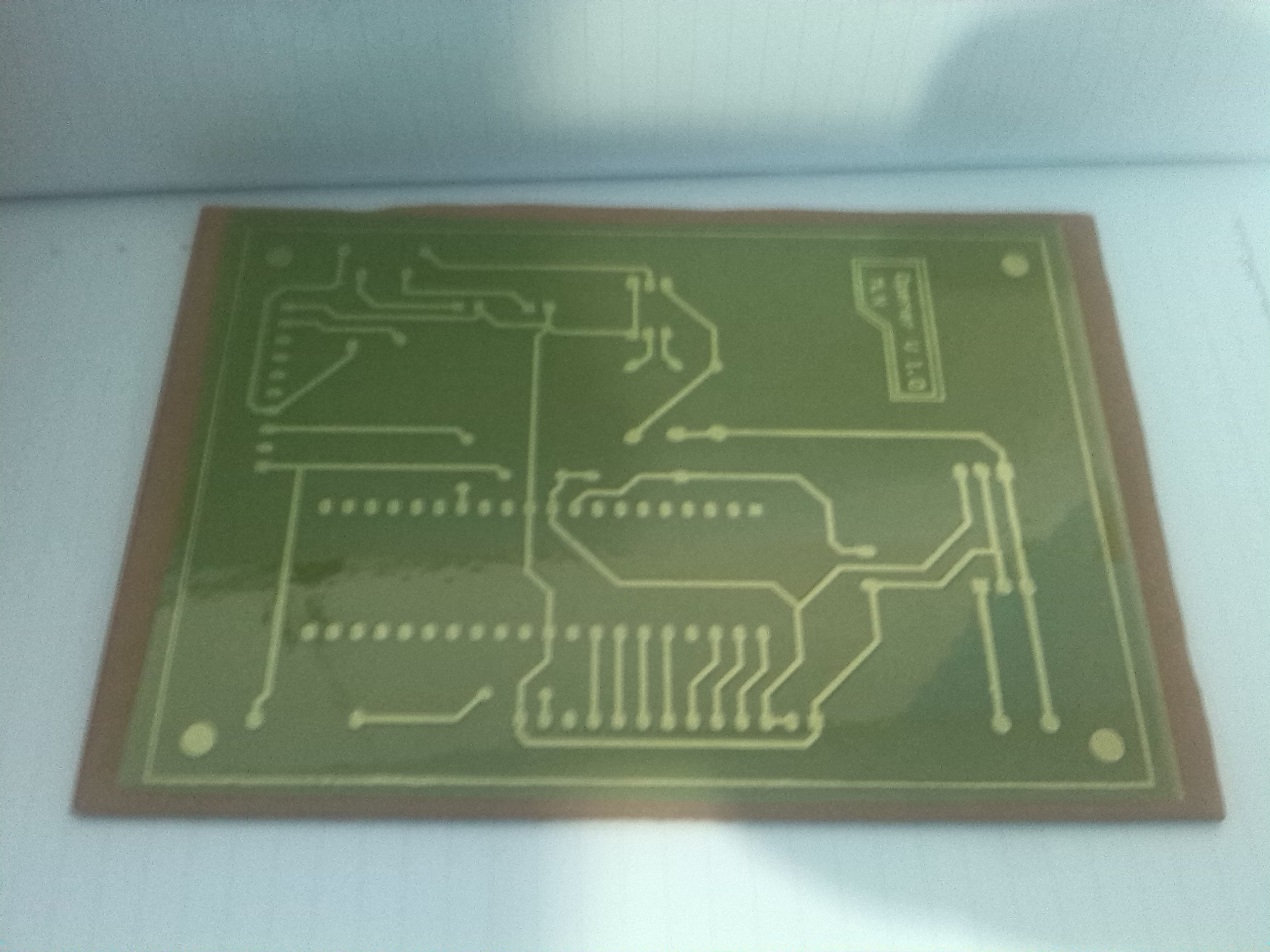

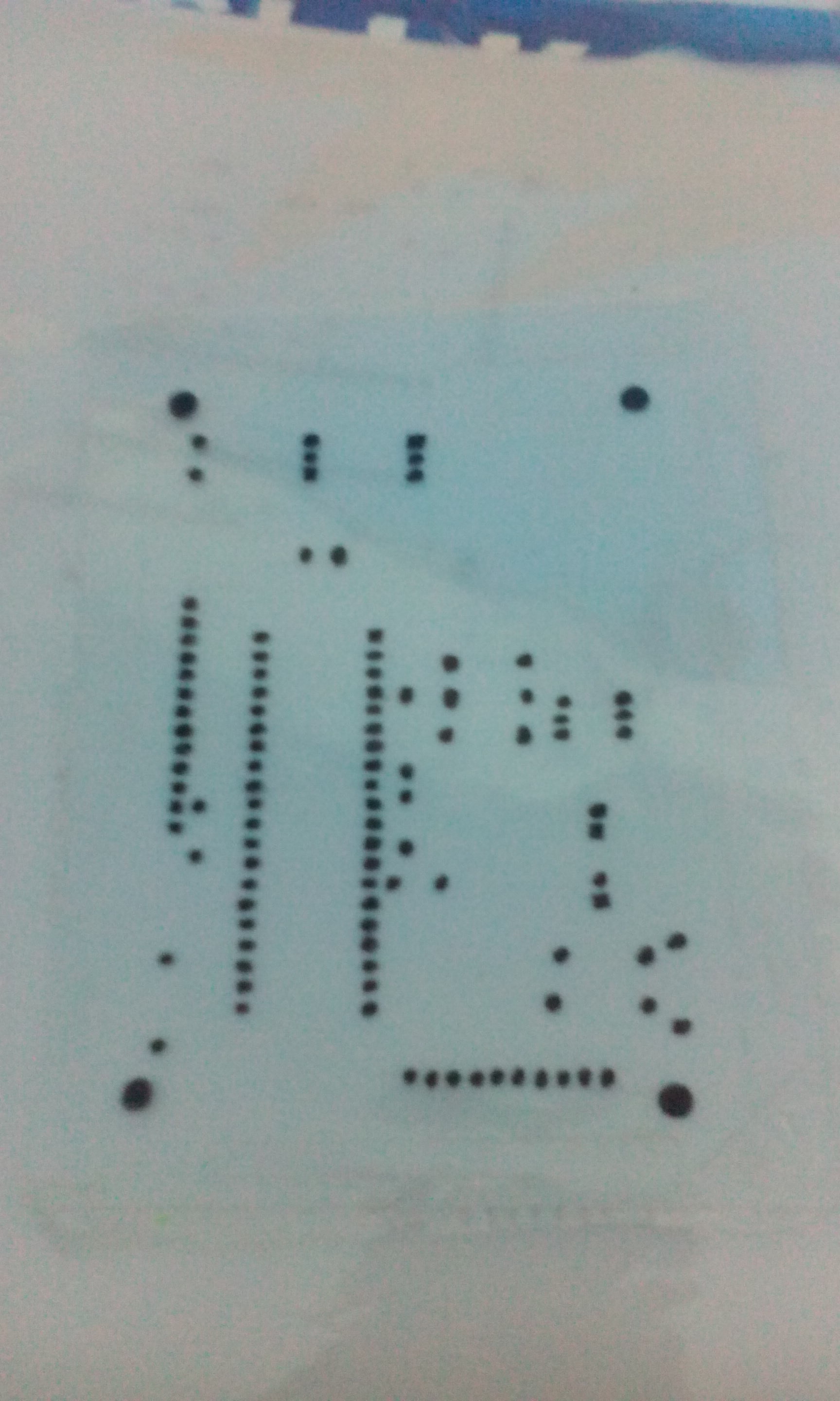

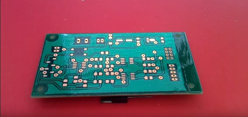

I am now in the step of developing pads:
http://s7.picofile.com/file/8245350242/IMG_%DB%B2%DB%B0%DB%B1%DB%B6%DB%B0%DB%B3%DB%B3%DB%B1_%DB%B1%DB%B5%DB%B2%DB%B7%DB%B2%DB%B0.jpg
And the final step is having something like below picture:
http://s6.picofile.com/file/8245349950/Untitled111111.jpg
And the picture below is my glass sheet (I draw pads onto it by permanent marker):
http://s7.picofile.com/file/8245347884/IMG_20160331_135643.jpg
Although I tried the developing pads step almost 20 times but I could catch goal of having this final result:

Your marker is too transparent. The pads are exposed through the marker. Try exposing it shorter. Also use nail lacquer if you really want to draw them by hand.
The marker is probably too transparent to UV as ruffy91 says.
Also be sure that the artwork (the ink in your case) is against the board.
   WRONG:       PCB GLASS|INK LIGHT
   CORRECT:     PCB INK|GLASS LIGHT
The following users thanked this post: mov-jump
yes it's too transparent but I used double glass sheet to have darker pads.
Unless glass is a mis-translation, that would never work,  light will just go in between the glass layers.  print  the artwork same as you do for etching.
