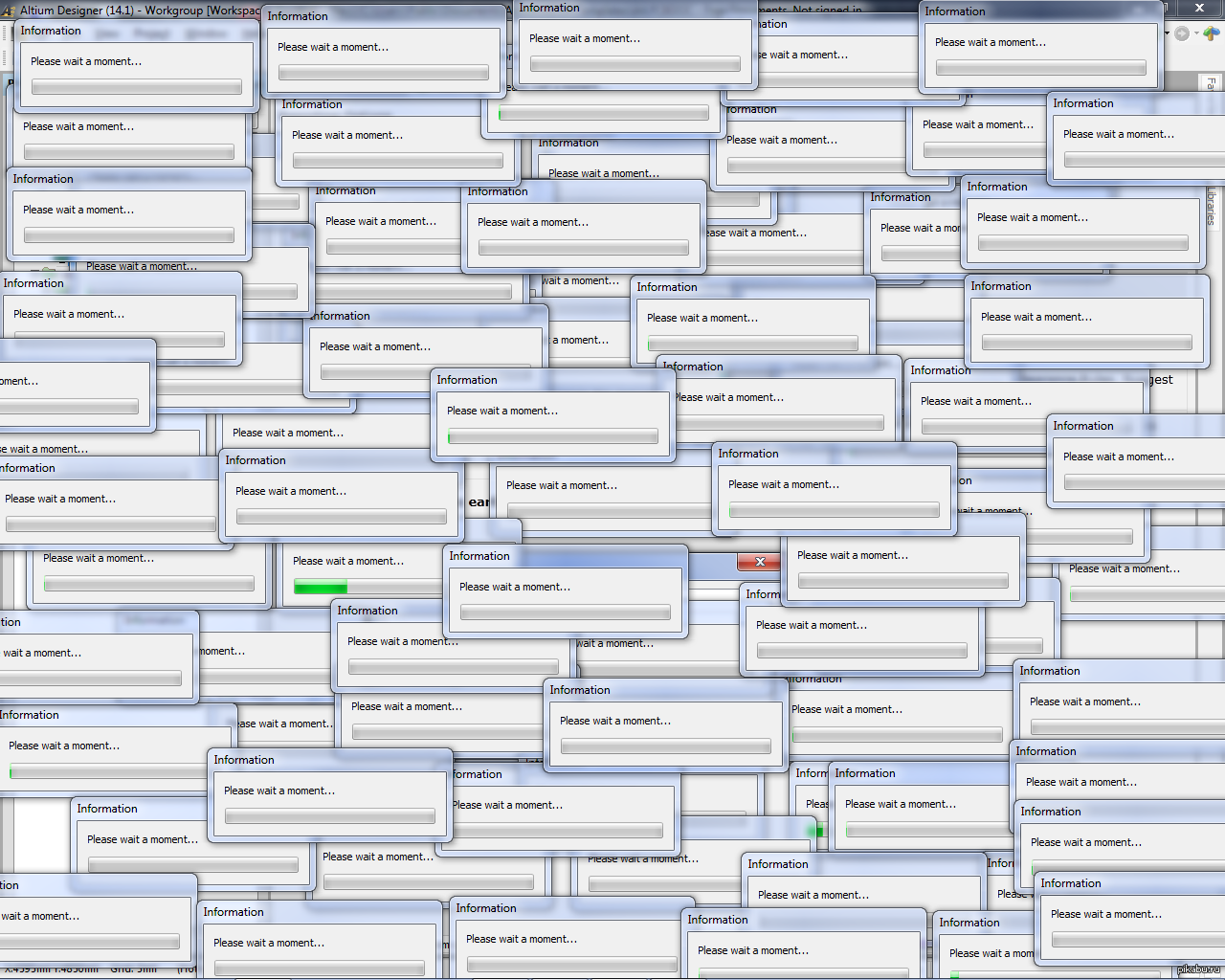

You can always replace the 0603 resistor with a TQFP144, press "Update PCB with current footprint" and receive this:
The following users thanked this post: voltsandjolts, mars01
I can't quite put my finger on it, but that image immediately conjured up that scene from I, Robot where you had hundreds of those androids surrounding Will Smith and apologizing.
