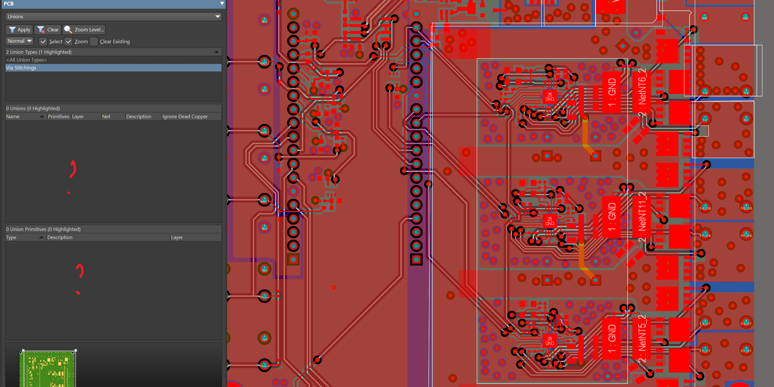

I am new to Altium. So might be very noob questions but I could not figure out what's the problem.  |OI tried to use the auto stiching function and found out it could not stiching areas where has other polygons carry different signal.

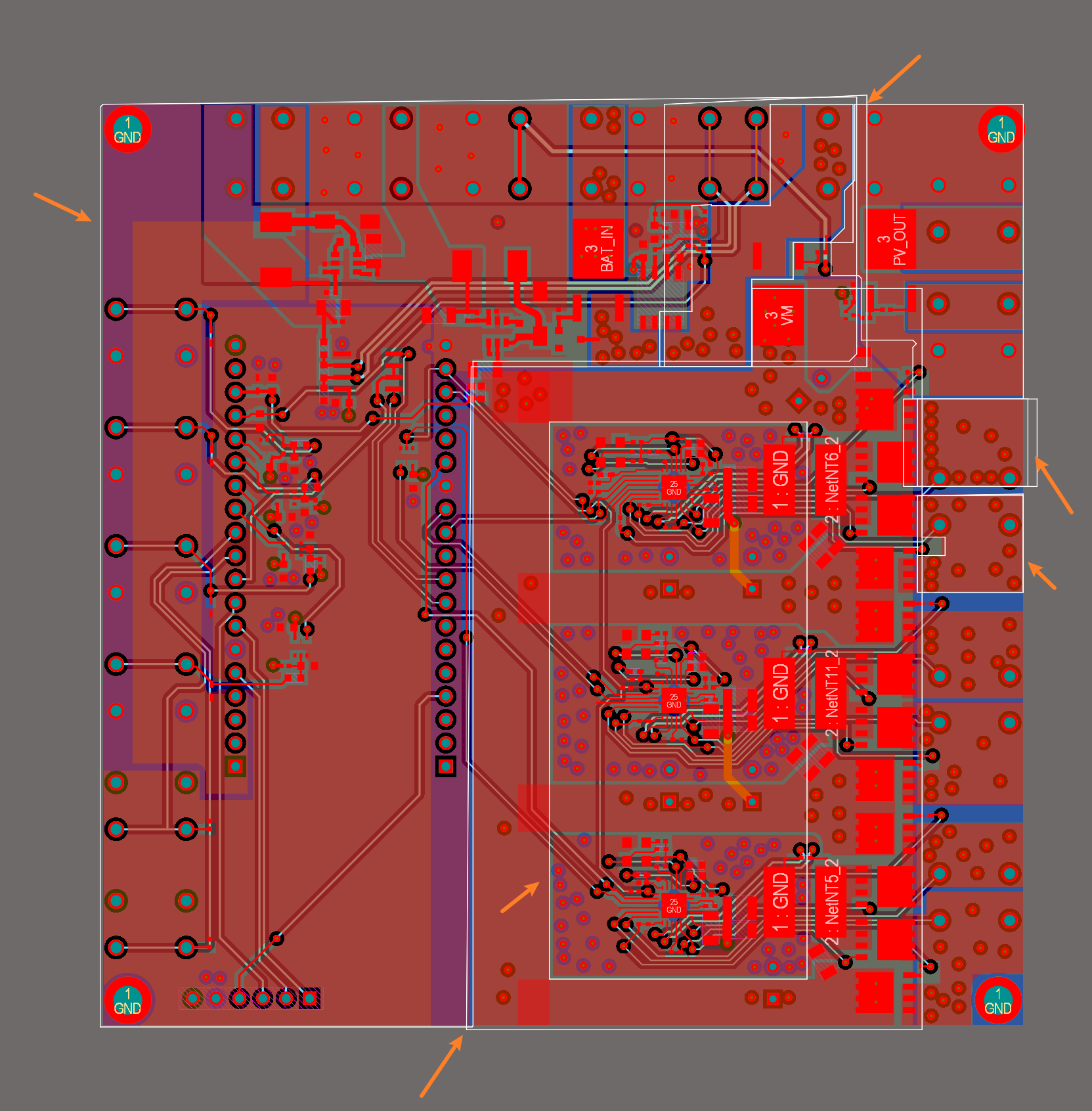

So I deleted all the auto stiching vias and redo them manually. But after I do it, altium seems leaves white outlines for the restrained areas I defined for stiching vias. And I can not select those outlines or delete them.
I tried highlight stiching via union there is nothing.

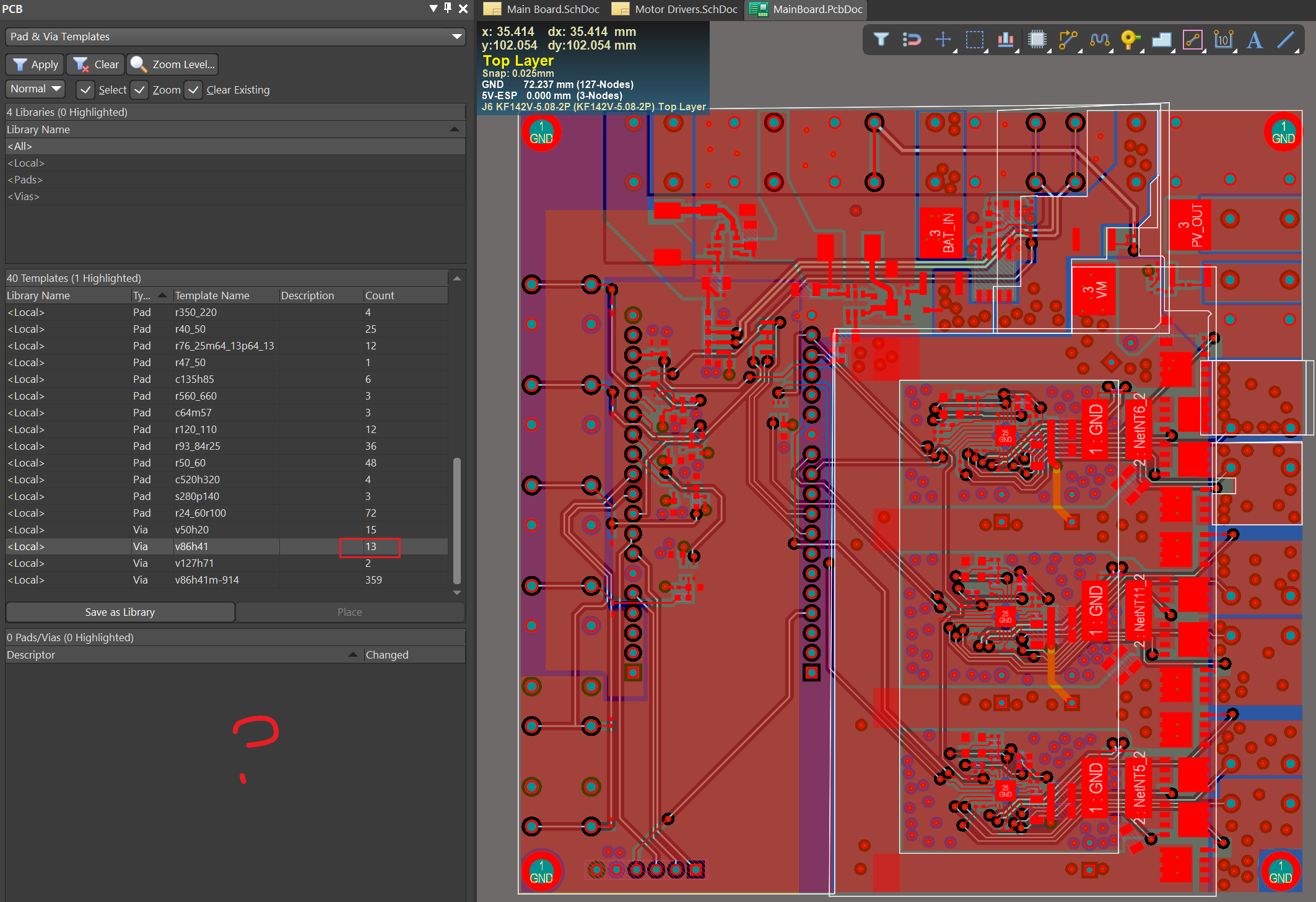

Some ghost via shows 13 count and not highlighted?
I know this might not afect anything in the design but it's just anoying  |O

So to delete the vias, you are supposed to click Tools -> via stitching -> remove via stitching group. And click on a via.
I tried manually deleting the vias as you described, and the white box disappeared after. AD19.
Maybe you missed one?
