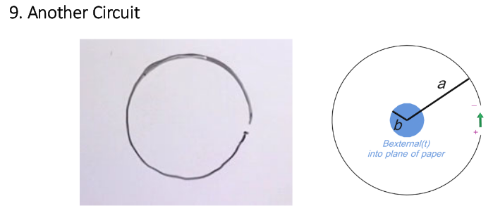

And I have another thought experiment for you: what if you replaced the two resistors with just wires, what would you measure around the loop?
I can actually predict it: the voltage across the two wires replacing the resistors would read "zero", while across the other two, the red wires of your original experiment, you would still read roughly 100mV.
Instead of using my little red wires, I used a single length of 14AWG  in a loop, and soldered the ends together with 3/4" overlap so I wouldn't have any contact resistance issues to worry about, like this: https://postimg.cc/nXD7ynQf
I cannot run it for very long because the wire starts getting hot.
However:
Measuring across where the red wires used to be gives about +50mv.
Measuring across where the resistors used to be gives about -50mv.
(NOTE: Signs are to indicate the phase! I was using an AC volt meter, but I also determined the phase.)
Measuring from two points exactly opposite on the copper ring gives about 0mv.
The voltage dropped on the exposed part of the wire is opposite phase as compared to the voltage developed  on the wire which passes through the core.
To determine whether the voltage drop across the place where the resistors were was resistive or inductive, I put on a twisted pair as you can see, and it read the same ~50mv that the volt meter leads do.
It looks like we basically have essentially four resistors in series, two passing through the core and 2 not passing through the core.
A total of 200mv is induced, and each of the four "resisters" drops 50mv.
There would be 100mv induced in each resistor which passes through the core, but due to the current, there is a 50mv ohmic voltage drop in the opposite direction.
And since Σ(50,50,-50,-50)=0 it looks like KVL still holds.
That is a little hard to explain with your claim that none of your probing wires "cross" any magnetic flux, right?
I don't see why. The two ends of the "resistor" that is inside the core stick out, and those are the output wires to my transformer. They have ∮E.dl voltage across the ends of the wire.
By definition, a closed path core is equivalent to an infinitely long solenoid, right? So it makes sense that if the solenoid wraps around the straight wire, the straight wire effectively does exactly one turn around the infinitely long solenoid.
For the sake of KVL, it seems to model that way just fine.

10. Another circuit
link to image: https://i.postimg.cc/DZwxkkyJ/screenshot-3.png
The experiment above was not considered in the video, but I offer it up as an exercise for the reader. I have a “one-loop” inductor, with a capacitor and resistor, as shown, where I assume the self-magnetic field is only non-zero inside the loop. The battery is shown with the positive terminal down, which will result in a current flow counterclockwise around the circuit, giving a self-magnetic field out of the paper.
At the top of p. 15, he writes
https://i.postimg.cc/vTphV47f/screenshot-4.png
Take note of the equation, You will see it repeated shortly. For the time being, let's look at the other picture:
https://i.postimg.cc/ZqCLVPfp/screenshot-5.png
Oh, look: same circuit, same test points to which attach the probes and different voltages depending on whether the voltmeter is on the left or on the right of the loop. I wonder where I have ever seen that before.
Oh yes, Lewin's ring. There is a difference though: Lewin's ring is not lumpable, while this RLC circuit with lumped R, L and C component is lumpable.
How so? What you need to do to consider it lumped is to devise a circuit path that DOES NOT CONTAIN the changing magnetic flux region in its interior (technically, we should say that the closed circuit loop does not cut any net flux - but in 2D it's easier to say what I just wrote). If you can do that, then all voltages along any path you could imagine in the area enclosed by your circuit path, will be path independent (they will only depend on endpoints).
How can you find such a circuit path? Easy: instead of having the circuit path following the coil's filament, we consider the circuit path jumping in the space between the coil terminals. As explained by Feynman, shown by Hayt (posted an excerpt just a few pages above in this thread), detailed by Ramo Whinnery and VanDuzer, exemplified by Purcell, and Haus and Melcher, and Faria, and in the published papers by Romer, Roche, Nicholson, and on and on and on... now you can apply KVL to your freshly lumped circuit and be happy. It's fake, because voltage will still in general depend on path, but in our little bubble we can pretend it doesn't. In that sense, in that little safe space we just cut out from the rest of the real world, KVL holds.
Let me rephrase it: if you can hide the changing magnetic flux inside a lumped component, and you do not look inside it (meaning: your circuit path does not go inside those forbidden zone components and thus it is impossible to go around the dB/dt region) then the "amended" KVL holds.
Yet, whenever you consider circuit paths that go around the magnetic region, -pouff- the dream shatters. For example, if your circuit path consists of only one inductor and the jump at its terminal, you will see KVL die in the definition itself of voltage across the terminals of the lumped inductor. If you accept the definition of voltage as (minus) the path integral of the total electric field (such as that given by the IEC), the following paragraph says just that
https://i.postimg.cc/5y3vxj7f/screenshot-6.png
i.e. you have a voltage -Ldi/dt across the terminals of the (self-)inductor, but zero voltage along the filament of its coil. Voltage referred to the same points A and B is different depending on the particular path you refer it to. Exactly what Lewin says in his video "Kirchhoff law is for the birds=https://youtu.be/LzT_YZ0xCFY", at minute 33:
"And now I'm going to cause you some sleepless nights. And I'm going to attach here a voltmeter... And now I'm going to ask you what would this voltmeter show. And you'll probably say: 'well didn't you say that the integral of E dot dl through this wire is zero?' So you will think that V here is zero. But that's not true. You know what V is going to be? It's going to be + L di/dt."
Oh, look! Belcher and Lewin are saying the very same thing.

By the way, have you read Dr. Belchers writup on the subject yet?
He goes over the idea of an unloaded transformer having voltage.
He basically cites Faraday's law and says that if you want to reassure yourself that the electric field actually exists, just increase the output voltage of the transformer to where it jumps an arc. He says you will see a spark and that PROVES (his word, my emphasis) that there is an electric field there, whether you put a volt meter onto the circuit or not.
Others here have likewise used similar electroscope/statically deflected oscilloscopes as thought experiments to show that the EMF is still there even if no current is flowing as a result of it.
In fact, I think maybe this is what's getting everyone in knots:
Dr. Belcher writes:
At 4:31 into the video, Mehdi draws the open circuit to the left above.  There is no current flowing
because the curcuit is open.  Let’s discuss this situation before we put the voltmeter into the circuit.
There will be zero electric field in the wires, because in the wires the induced electric field exactly
cancels the coulomb electric field, as we saw before.
And everybody stops reading there and declares that a transformer does not have a voltage output.
But Dr. Belcher continues immediately following the above quote:
But we will still see a charge accumulation on the ends of the wire, as shown in the schematic to the right above.
The upper end of the wire will be charged negatively and the lower end of the wire will be charged positively.
Moreover we can calculate the potential difference across the gap by using Faraday’s Law (which applies for
any open surface and its bounding contour, where or not there are any wires around.  Going around the circle
counterclockwise gives us (l  is the height of the gap)
If you want to reassure yourself that this electric field actually exists, make larger than the
breakdown voltage in air, about a million volts per meter, and you will see a spark across the gap that
proves that there is an electric field there, whether you put a voltmeter into the circuit or not.
So there. A transformer secondary puts out a voltage. KVL depends on guess what, VOLTAGE. (Word Kirchhoff's, emphasis mine.)

1. That sentence of Belcher is about the RLC lumped circuit of section 10. Read pages 15 and 16. It's not about the unlumpable Lewin ring.
That's where I was quoting from. Wouldn't you say that he clearly describes that there are two different attributes, both of which use the unit volt, but one of which is always zero across an inductor and one which is what a volt meter reads, which is how KVL holds as argued by Mehdi?
He says "Thus with Feynman et al.’s definition, the sum of all the voltage differences around the circuit is zero (that is, KVL holds) "
Ok, let me join the dots for you.
About that sentence by Belcher
You already posted the two relevant pages of Belcher's note. Let me show you that the partial sentence you keep repeating ("In this sense, KVL holds as argued by Mehdi Sagadhdar, but..." - oh, no! You stop right before the 'but') is not about the unlumpable Lewin's ring, but another, lumpable, circuit.
The "but" doesn't have anything to do with it not being lumpable.
And I just re-read  Belcher's writeup, and I think you're wrong in saying that "In this sense, KVL holds as argued by Mehdi" was said about the RLC circuit that Belchar shows.
Specifically, Belcher goes over Lewin's loop specifically ( two resistors in a loop on opposite sides) then also goes over several specific loop configurations that Mehdi showed.
Then Belcher gives an RLC loop diagram that Mehdi did NOT use.
Belcher then goes onto a new Section,  "11 KVL" which makes one reference to the Non-Mehdi RLC loop above just to say that a common misconception holds that the -L(dI/dt) voltage read in the above RLC diagram represents -∫E.dl
In no other way does section "11 KVL" tie it'self to (or exclude itself from) any specific loop topology. In fact, it specifically says "As argued by Mehdi" which means section "11 KVL" CANNOT be about the RLC loop, because Mehdi didn't argue anything about that loop.
I stopped at the "but" because it just says that "one must always remember that the voltage difference across the inductor is defined in a very different way compared to the voltage difference across the other three elements."
It's still a voltage difference though.
I really don't see Belcher addressing the issue of probing or lumping at all.
It looks like he's just saying that even though a superconducting wire has no voltage drop due to -∫E.dl, it does have voltage drop due to ∮E.dl or Faradays law, and thus, KVL holds, that is to say, once the ∮E.dl is taken into account, then yes, the sum  of the voltage differences around the circuit is zero, and that KVL holds.
He says nothing about whether it is testable in the real world, but he says it holds.
How did you get from "but" to believing that Becher is saying that it Lewin's loop is unlumpable? Or that his section "11 KVL" does not apply to Lewin's loop?
After all, the entire basis for his conclusion in "11 KVL" is that ∮E.dl does give the voltage across the wires in order for all the voltage differences around the loop to sum to zero: Just because Lewin's loop may be difficult or impossible to measure in the real world doesn't mean that ∮E.dl  suddenly vanishes.
The famous sentence appears in section 11 on page 16, but it is related to a discussion that began in section 10, on page 15.
Source: Belcher's note available on Mehdi's YT channel. Let's see what section 10 is about, first.
10. Another circuit

This part of Belcher's note is about the series lumped RLC circuit where L is the self inductance. NOT the unlumpable LEWIN's RING (where, incidentally but not importantly, the self inductance is negligible). It is about the different approach IN LUMPED CIRCUIT THEORY between properly applying Faraday (using a circuit path the goes through the filament and accounting for the magnetic flux intercepted by the path: 5 + 3 + 0 = 8 ) and using the 'amended version of KVL' (using a circuit path that jumps at the inductor terminals and pretending -L di/dt is a potential difference to save KVL: 5 + 3 - 8 = 0).
Belcher is explaining the common misconception, and showing that L(dI/dt) is COMPLETELY SEPARATE from -∫E.dl and that when Faraday's law is a term, then in fact the voltage difference across the inductor portions summed with the voltage difference across the non-inductor portions will be zero.
One can still save KVL for lumped circuits by bringing the rhs (the surface integral of B.dS) to the left side (and pretending it is a path integral of E.dl).
The trick works ONLY IF you can devise a circuit path that DOES NOT contain the variable magnetic flux region.
You can do it for the lumpable RLC circuit.
And this is the "amended", or "modified", or "extended" or "new" KVL that is so very often badly explained in high school and in first, second year introductory uni books (they use the 5 + 3 - 8 = 0 formalism that erroneously lead students to think there is a voltage buildup in the wires of a coil - Lewin says that "the physics stinks").
You CANNOT DO IT for Lewin's ring.
Why? Because it is required that the two resistor be on the opposite sides of the variable magnetic region. So, your circuit path is BY DEFINITION required to contain the magnetic flux region. The circuit is unlumpable.

In order to model it with two or four lumped coils, the magnetic field region must be splitted to accomodate a circuit path that does not include any of it. I used the same 'stellated' path style used by Feynman in figure 22-9 at page 22-7 of his second volume of lectures.
Some ask: "don't you see the transformer?" Well, when you are inside the coil, when your circuit path go around the dB/dt coil you no longer have the luxury of using a lumped component model (the secondary of a transformer to which you can apply KVL) for the coil. You have an unlumpable circuit and you need to deal with it accordingly: ditch KVL and use Faraday.
