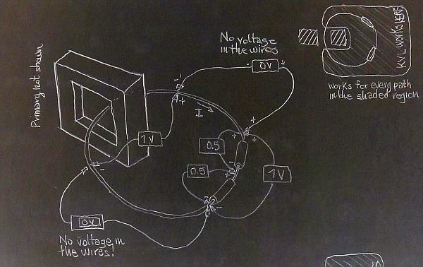

Fantastic!  Now here is another problem for you.  The same 'Lewin' ring as before with a AA battery in series (as show in the attached figure).  Compute the voltages V1 and V2 at t=0.  Also, the battery, although slowly, is discharging over time, but at t=0 the voltage between the terminals of the battery 1.5V.

NOW: Using your provided definition, and the circle path diagram above that, in your opinion or by your calculations, what will be the voltage between the points connected by the non-conductive green line, assuming a 1v/turn induced voltage for the whole loop?
Assume that the upper section encloses exactly half of the dB/dt, and that the wires are superconductors.
Also assume that the solenoid is infinitely long.
As I see it, you have yourself in a bit of a bind.
If you say "Can't be known" then you're obviously using the wrong definition for volts.
If you say zero, then transformers have zero volts output, which is obviously false.
If you say non-zero, then Lewin goofed by not accounting for the voltage induced in his probe leads between the "point of measurement" and the "volt meter."
So what's the voltage across the two wire ends shown by the green path?

I don't think the conclusions you draw from the possible answers are valid.
But I can also predict that you will not understand, and reject, the answer once given.  :-DD

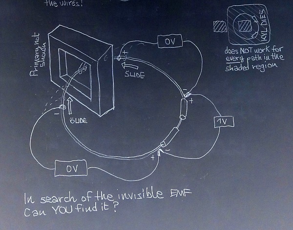

No, I applied Faraday. I can do that even with lumpable circuits, if I choose not to lump them. Here's one picture from one of my answers on EE Stack Exchange where I properly apply Faraday to a lumpable RLC circuit (the 5 + 3 + 0 = 8 approach)
The solution is in the image you quoted. It's fascinating that you do not realize it.
Just switch the capacitor with a resistor, and there you will see how to apply Faraday to your circuit, and how the right hand side only features the induction EMF, while the battery EMF is accounted for as part of the circulation.
You really can't see it, if you think putting a battery in Lewin's ring can represent some sort of difficulty.
Anyway, I solved step by step (again for the general case, I am not interested in exercises) and I tried to spell out every single step - including sign conventions and the many parts you can break the circulation path integral (something you can read, certainly better explained in Ramo Whinnery and VanDuzer - but you won't read it, right?), and how the direction of the current depends on who wins between the induction EMF and the battery.
But before scanning these two pages, I want that some KVLer do the measurements I propose.

So let me ask you this. In the following diagram:
Let's see if you can forecast my answer by looking at this image
https://i.postimg.cc/15n8XGXJ/Voltage-can-be-path-dependent.jpg
Some hints:
What color would I use for that kind of path?
What color would I use for the probes in Lewin's setup?

What you are telling me by making an equivalence from my circuit to your circuit is that you lumped the induced EMF and them you used KVL to solve it!
You really can't see it, can you?
You're like that guy in Kevin Smith's "Mallrats" movie. The guy who spend hours in front of the stereoscopic poster and everybody else can tell what the image is, while he can't see it.

Here is the answer to your previous quiz
You talk about measuring reality, so this is my prediction for your circuit. If you don't like the polarities flip the signs.
https://i.postimg.cc/Yq1ZDcPY/KVL-works-if-I-leave-out-the-magnetic-region.jpg
Note that you won't be able to measure any voltage in the perfectly conducting wire of the ring, in accordance with Ohm's law. So, are you a lumper, or today you decide that there is voltage in the wires and in the probes? I have to ask.
Now, it's my turn.
Same circuit (you can even use a single resistor if you want. My prediction is that you will observe zero volts in the wires even when the sliders (you sliding the probe tips along the ring) get in contact inside the core.
So how does KVL "appear" to hold?
https://i.postimg.cc/CKfjJ0PV/KVL-dies-if-the-magnetic-region-is-inside-my-circuit-path.jpg
Now, if today you are still a lumper, please tell me where is the EMF on the ring.

You already admitted that the V1 and V2 readings in my above yellow diagram would be identical, so why does it matter if the wires coming out of the transformer have to come near eachother? Does that change the voltage? Does it change whether my volt meter readings will all add up to zero around the loop of which that transformer secondary is an element?
https://i.postimg.cc/R04QGyHs/KVL-works-if-I-leave-out-the-magnetic-region.jpg
I see you noticed that you made the same mistake Lewin did and you got one of the volt meters backwards, but at least you caught it in time to put a text note that says I can flip the volt sign.
So yes, I'd like to flip the sign on the left-hand meter which reads 1V. You have to keep the meters all pointing clockwise or counter clockwise -- but all the same way for a given test -- around the loop. That's just the way KVL is. If you mix up your volt meter signs even with pure batteries and resistors, KVL will appear to fail then too.
With all the volt meters pointing plus-clockwise, then you can see that the voltage sums to zero, just like KVL says.
So do we agree that  KVL at least APPEARS to hold on your above diagram, since taken in a positive clockwise series of element voltage difference readings, all the voltage differences sum up to zero?
I don't understand the question. I think you're making a dichotomy between a lumper and there being voltage IN the wires.. but I'm not sure what you're trying to ask. If a wire has induced voltage, I'd rather say that it has induced voltage across it.

So do we agree then that in a setup as you show in your diagram above, the transformer secondary winding MODELS AND MEASURES as if the entire induced voltage is where the wire passes through the core, and that the wires outside the core MODEL AND MEASURE as if there is no voltage induced in them?
Now, it's my turn.
https://i.postimg.cc/cH5RxJ52/KVL-dies-if-the-magnetic-region-is-inside-my-circuit-path.jpg
KVL continues to hold once you MODEL REALITY.
The REALITY is that by sliding your volt meter probe through the core, you now have ANOTHER SECONDARY WINDING, AND ANOTHER LOOP!
Like this:
https://i.postimg.cc/LX6wZVFJ/20211121-235058.jpg
See? You have TWO secondary windings, with the SAME number of turns, and the SAME direction, and they are both having induced across them the SAME VOLTAGE and in the SAME POLARITY at the SAME TIME.
Of course the difference between them will be zero, because 1-1=0. Go figure.
And you don't just have one loop anymore, you have TWO loops. Or three, depending on how you want to model and measure.
If you MODEL REALITY, like I've been saying the whole time, KVL will hold with elements composed of the secondary windings on closed-magnetic-circuit-core transformers.
If you DON"T model reality, then all of physics will fail you, not just KVL with transformers, but KVL without transformers, MaxEQ, Ohms law, EVERYTHING.
I don't know what you mean by "lumper" but the EMF MODELS AND MEASURES as being across the transformer secondary at the very point it crosses through the core on a closed-magnetic-circuit-core transformer.

The point is that by adding in additional voltage sources/drops and creating nested loops but pretending there is only one loop will get you in the same trouble with pure batteries and resistors as with a transformer.
So do we agree that if we run two identical parallel windings on a transformer that the voltage difference between them is zero?
