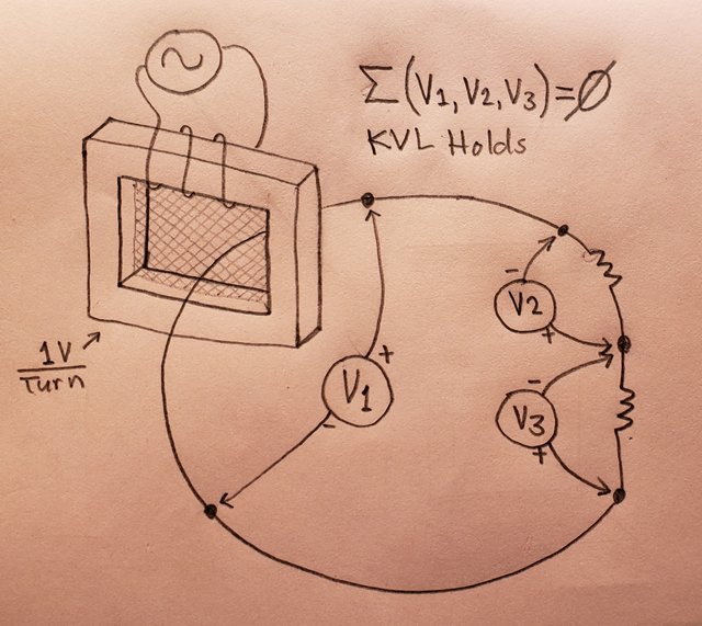

So I guess then that both V1 and V2 in the below diagram would hold for KVL since you already admitted V2 will hold for KVL and that both V1 and V2 will measure the same with my volt meter, that's an unambiguous physical measurement, right?
https://i.postimg.cc/fTgyDNp0/20211119-030105.jpg

Why does the wall have to be there? How about I put my wall here, in the very center of the toroid just to keep idiots from dropping their volt meter leads through there, as shown in the diagram below - it's functionally identical to your wall, yes? And its a lot less bricks!
https://i.postimg.cc/qqG0vgRV/20211124-213839.jpg
Above: See the crosshatched wall inside of the core.

So to clarify, if I put up a wall inside my core as seen in my diagram directly below, and this wall keeps all the idiots from dropping their volt meters in the hole, then the secondary winding measures and models as exactly a single turn secondary, right? And as long as no other elements of my loop breach that wall, then I'm golden, right?
And since your own trusted source says that KVL holds as long as the current_in = current_out and the voltage is unambiguously physically measurable, I guess we have to agree, with my boundary wall KVL then holds for the exact same reason I've been droning on about for a year now - because you have to model reality or your math isn't going to match reality. The wall just keeps the idiots from dropping their volt meters through the forbidden stargate hahahaha  :-DD :-DD
(And NO NO NO, I'm not saying it IS a stargate, I'm saying it MODELS AND MEASURES AS IF it is.)
You already agreed that KVL would hold for "V2" in the below diagram, and you also already agreed that "V1" and "V2" would unambiguously read the same with a physical measurement:
So I really don't know why you can't agree that the 2 terminal output of a toroidal transformer can work fine as an element in a KVL loop.

You already agreed that "V1" and "V2" read the same in the following diagram - and you also already agreed that "V2" is suitable for use in a KVL loop.
Furthermore, your trusted sources say that if Iout=Iin and the voltage across the terminals is unambiguously physically measurable, then KVL holds.
And because you already agreed that V1 and V2 in diagram below read the same, that tells me they read UNAMBIGUOUSLY  so how can you not agree that KVL would hold in V1 as well?
Draw the resistors in that exact position around the shaded dB/dt region, with that shape and size (the one where I write "Example where there is no room to twist it"), and then draw a green dashed line that is your circuit's path. It has to join the resistors' terminals with one another and with the lumped transformer. Note that the shaded disk should all be contained into your lumped transformer, and your green dashed circuit path must NOT INCLUDE the shaded disk.
Go ahead, I'll wait for your picture.
What're you blathering on about?
You've already agreed that V1 and V2 will read the same in the above yellow diagram, and you've also agreed that V2 is suitable to be an element in a KVL loop.
AAAAaaand you've also agreed that KVL will hold if we put an imaginary brick wall inside the core that prevents all idiot volt meters from falling through the hole as shown in the diagram directly below:
You full well know that if I measure the voltage across that inner section of winding it will read 1 turn of voltage. Of course the voltage isn't actually all induced just inside there, but because the rest of our loop is not inside there, IT MODELS AND MEASURES AS IF IT IS ENTIRELY INDUCED INSIDE THE CORE and as such ONE TURN MODELS AND MEASURES AS EXACTLY A SINGLE TURN, which is what my claim is.
Are you actually denying that the voltage measured by V1 in diagram below will be something other than one turns worth of voltage?

Just like shown with my Lewin Clock, there are planes along which probe leads may be run where there is no non-conservative field which allows unambiguous physical measurements to be made of the two half-turns.

For the moment, let's see that picture where you lump Lewin's rings by enclosing the shaded disk inside your transformer but NOT inside the circuit path that connects it to the resistors.
Remember, the resistor and the disk must remain in the same position, you cannot move them nor split it.

Why not just admit that a secondary winding on a toroidal transformer can be unambiguously measured and therefore KVL will hold fine with such an element?
Then we can move onto where the real dragons be, like aircore transformers and partial turns and all sorts of wonderful stuff!
The fact that you repeatedly refuse to answer that question tells me you don't know what you're talking about.

Snedri already admitted that V1 and V2 in the following diagram will physically measure the same voltage, and that V2 will hold as an element in a KVL loop:
He also admitted that if we put up an imaginary wall to keep other stuff from going through the core, then the winding becomes suitable for being an element in a KVL loop:
Do you really think that the voltage reading is ambiguous on my EI-Core loop so long as I don't add or remove secondary turns without documenting them?

It's not possible to measure two different voltages in the same spot.
But you aren't measuring the voltages in the same spot, are you?  The two voltmeters are in two different spots.
Assuming we're talking about this:
Electrically it's the same spot. The piece of wire between the resistors has 0V across it, so obviously there's no potential. You could move the probe points of the volt meters (those across "R" and "2R") until they touch, they would still show the same value, provided the wires have negligible resistance.
PS: edited for clarity.
The real answer is "Don't add undocumented turns to your transformer and expect physics to work."
This "wall inside the transformer" is not equivalent. It makes people believe they'll be safe if their probe leads do not cross it and so they stop looking at the complete paths and instead concentrate on "forbidden planes". It has certainly not stopped you from adding "undocumented turns" in your EI core experiment.
Please explain. Do you mean that assuming no probe wires breach the wall in the above diagram, there is still path dependence effecting the probes wires?
Are you saying somehow my volt meter can possibly read anything other than the unambiguous voltage of 1 turns worth of induced voltage, assuming my volt meter leads don't breach the wall?
Whaddya mean? Each of my half turns were exactly a half turn. And all four voltages summed to zero.

Here's some questions I've been asking for days and you're refusing to answer:
You have admitted that in the V1 and V2 voltages in the diagram directly below will both read the same voltage, and you have also admitted that V2 will be suitable as an element in a KVL loop:
Question One:
How can V1 not also be suitable since they both measure the same voltage? Your own trusted source says that if an unambiguous physical measurement of the voltage across the two terminals can be obtained, then KVL holds! How can V1 not work for KVL?
Question Two:
Considering your own trusted source, if a ONE TURN TRANSFORMER SECONDARY on a toroidal transformer has a voltage that is unambiguously physically measurable, then it should qualify as an element for a KVL loop, Correct?
For example, in the following transformer diagram with a safety wall in the center, why would the output winding not be suitable as an element in a KVL loop?
If you think the above secondary winding is not suitable in an element in a KVL loop, then why? It is possible to unambiguously measure the voltage, right? So then according to the following textbook, which you yourself cite, KVL should hold, right?
https://i.postimg.cc/sf4j3HbF/Desoer-Kuh.jpg
If you honestly answer the above questions and I'll do my best to draw up Lewin's loop and show how I would measure the voltage across the half turns.
No, I have answered the questions that made some sense. But you have such big holes in your knowledge that you end up asking questions that have little to no sense. I was going to make a post about the misconceptions your posts are full of, but there are way too many. For example, I have written many many times that KVL applies in all regions of space that do not contain/cut a variable magnetic flux. So, in the lumpable circuit with the twisted wire it goes without saying that, since there is no changing flux in the small loop formed by V2, the wires and the jump at the first twist, KVL works.
But you keep asking questions that contain nonsense in them
What the heck does "V2 (or V1) is suitable as an element in a KVL loop" even mean???
V2 is a voltmeter, to begin with, but let's consider it a branch. A branch alone can be part of a loop to which KVL applies (works) and AT THE SAME TIME be part of a loop to which KVL does NOT apply.
Case in point: Lewin's ring with the two 'external' voltmeters. V1 forms a loop with R1 that you can apply KVL to, but forms with R2 (and V2) loop(s) to which you cannot apply KVL to, you need Faraday.
Therefore:
Question One:
This question betrays your confusion. I cannot answer this question because you are showing not to possess the prerequisite to formulate a rational question. V2 in the twisted circuit can be though as part of a circuit that stops at the first twist. If you limit yourself to paths that are inside that little loop, V2 will always be part of loops to which KVL can be applied (because in the universe that is the area enclosed by your circuit path there is no dB/dt).
Yes, you can define your circuit path to follow all the twists and go around the core, but that betrays your ignorance of the purpose of making the transformer's terminal so close together: it's to treat the circuit with V2 as lumpED.
V1, on the other hand, is part of a circuit whose circuit path you can immediately see going around the core. Anyway, being a lumpABLE circuit you can choose both ways. If you choose the copper as the trail of your circuit path, you include the dB/dt region inside it. There are paths that when part of a loop along with V1 will go around the core, hence KVL will not apply. Faraday's will.
Question Two:
Again, the question betrays your ignorance. That is a lumpABLE circuit. You can treat it either as NOT LUMPED, by allowing paths that go around the core by considering an orange circuit path that follows the conductor around the core, or lumpED by denying this possibility by considering a green circuit path that jumps at the terminals, excluding this possibility. The wall is just a way to represent the fact that you are denying this possibility and your circuit path skips the innards of the transformer. (EDIT: to clarify: what really counts is how you define your circuit path: is it the green path that does not include the dB/dt region? Or is it the orange path that includes the dB/dt region?)
If you deny this possibility, then your voltages will be well defined (as Desoer and Kuh require for KVL to hold).
If you allow this possibility, then your voltage can be multivalued (and Desoer Kuh will say that KVL ceases to work for those loops with a part 'going the other side').
(To tell it all, we should make the terminals close together so that the circuit itself can be shrinked to a point, but I decided not to push this. )

Oh boy, where to even begin...
Okay, first of all: I'm not in denial of observable reality. In fact, I took the reality YOU observed, turned it into a nice, colorful diagram and explained each measurement YOU did using only Ohm, Maxwell and Faraday. I showed in which loops voltage is induced and why not in others, explained every number you obtained.
Here it is again:
Excellent, so if you don't deny observable reality, then please tell me that you agree that the two terminals of a single turn transformer secondary on a toroidal core will MEASURE AND MODEL just fine as a lumped element in a KVL loop, like this:
If not, why do you think the V1,V2,V3 would not sum up to zero?
Second: I did not "dream up" any "magic electric field". It's existence was found and explained by James Maxwell. It's his second field equation.
Quote from: Wikipedia
The Maxwell–Faraday version of Faraday's law of induction describes how a time varying magnetic field creates ("induces") an electric field
Third: It is very obvious how to measure it: create a wire loop around any area with changing magnetic flux, create some discontinuity (make a cut, put a resistor in the loop), measure the electric field across it. The probe is just some wire coiled up. It senses non-conservative electric fields. Just the same, each turn around a transformer core "measures" this electric field.
Ahhh, you have to add in a secondary winding measure this electric field you talk about extending to infinity. Why'd I have to ask 3 times to get an answer?
You may extend your secondary transformer load wires off into infinity and say "Ahah! An E-Field at Infinity!" But I could sneak in and replace your toroidal transformer with a non-inductive DDS waveform generator and you'd still be out there at infinity gloating about your E-Field which you presumed was made by your toroidal transformer, because the signal from my DDS would be indistinguishable.
And when you do form a loop, you get v. Then you add another loop, and you get 2v. and so on. Is that like stacking 10 plates and being able to pile 10 times the food on the top plate before it spills over the sides?  :-DD :-DD
Obviously it's the dB field that induces the E-Field, and obviously there's "no" dB field outside the toroid core, so where exactly is the E-Field induced? In a conductor enclosing the dB region.
But let's say you take a toroidal transformer, and you have it shielded in the thickest bestest Faraday and magnetic shielding known to mankind, and yet you have a tiny hole going through the shielding so that a wire can pass through the hole in the toroid and come out the other side. You still have a full turn's induced voltage even though only a fraction of the turn is actually inside the Faraday and magnetic shielding.
So what do you have, a super powerful field that blasts through the best known shielding known to mankind, which is completely undetectable unless you get INSIDE the shielding?
As others have said, nature does what nature does. We do our best to model it with physics, but physics are concepts and they don't always exactly describe the fullness of what nature is doing.
But anyway, so what does this have to do with  KVL not holding when one of the elements is the secondary winding on a toroidal transformer?
Are you saying that the E-Field surrounding a toroidal transformer will cause unexpected readings if it is near a KVL loop?
If so, what do you expect? How would I observe this in real life?
When I measured EI-Core secondary widings in a loop, I found that KVL holds just fine.
I hope this is not too much to stomach.
You mentioned repeatedly how the magnetic flux is fully contained inside a transformers core (which is not exact but, eh, good enough). Then explain how a conductor (charge particles) outside of the core and thus outside of the magnetic flux, can interact with it. "Spooky action at a distance"? The answer "Dude, because Faraday" is not enough. What is the mechanism behind it?
Nature.
We've figured out a number of different very clever ways to model nature in a number of different settings, but you tell me what the ACTUAL mechanism is behind it. What REALLY IS magnetism? You tell me.
At the end of the day, we can encase a toroidal transformer in the best shielding known to man, and it's output winding still has induced upon it a full turn's worth of voltage even though only a fraction of the turn is actually inside the shielding. So you argue that the remainder of the voltage is induced outside the shielding, even though there is no measurable magnetic or electric fields outside of the shield.
Ultimately, our models aren't always pretty for certain situations. Nature does what nature does, and we come up with models which sometimes create apparent paradoxes.
And what has this got to do with whether KVL holds in a particular setting?
Are you saying that a KVL loop will not sum to zero if one of the elements is a 2 terminal toroidal transformer secondary winding?
Btw how's that lumped circuit coming along @Sredni asked you to come up with?
I'm trying to use that as bargaining currency to get him to answer some questions he's been refusing, but I doubt it'll work, he knows better than to allow his belief to be tested against reality.
By the way, you've been refusing to answer questions too. But at least you talked to me! Thank you!
Do you really think that the two-terminal secondary winding on a toroidal transformer would not work as an element in a KVL loop?
If I summed up the voltages around the loop shown in the diagram above, would they not sum to zero for some reason?
What the heck does "V2 (or V1) is suitable as an element in a KVL loop"???
V2 is a voltmeter, to begin with, but ....
Dude, really? How many times have we talked about the secondary winding on a transformer being a 2-terminal element in a KVL loop?
Did you really not figure out that I was referring to the two secondary windings by the Vx number by each of them?
Did you think I was talking about a volt meter as an element in a KVL loop?
Do I literally need to write like a lawyer and cover every possible path by which you might try to escape from the question? Do you really want my replies to be 10 times size they need to be?
(Heh, besides, a volt meter in parallel with a secondary winding still makes a 2-terminal element, so what the tarzan, leave them connected and put the volt meter in the loop!)
'By "V1" and "V2," I am referring to the two-terminal toroidal transformer secondary windings depicted by "V1" and "V2" in the indicated diagram.'
'  a. In paragraph above, "V1" and "V2" are not referring to any volt meters, oscilloscopes, frequency counters, phase meters, or other measurement instruments not herein specifically mentioned.'
' b. By "toroidal" I mean to describe a transformer who's core is in the shape of a torus.'
' c. blah blah blah.'
Please, if you know what I'm asking, why beat around the bush and act like I just might be asking something else?
If you know what I'm asking, why try to take it to mean something else just to make me look stupid?
Bad faith antics dude.
... let's consider it a branch. A branch alone can be part of a loop to which KVL applies (works) and AT THE SAME TIME be part of a loop to which KVL does NOT apply.
Therefore:
Question One:
This question betray your confusion. I cannot answer this question because you are showing not to possess the prerequisite to formulate a rational question. V2 in the twisted circuit can be though as part of a circuit that stops at the first twist.
I don't care how you think of it I want to know how it will MEASURE.
You're not really answering my question.
How can V1  not work?
Consider explaining whether THE "V1" (Untwisted) SECONDARY WINDING would actually cause KVL to fail MEASURABLY -- in other words, as I already asked numerous times, if I made a loop out of "THE V1 SECONDARY WINDING" and two resistors, would the voltages around the loop as measured with a volt meter STILL sum to zero even though you say KVL is failing?
Question Two:
If you allow this possiblity, then your voltage can be multivalued (and Desoer Kuh will say that KVL ceases to work for those loops with a part 'going the other side').
Ahhh, so on question 1 above, you said that if I use the V1 winding in a loop, KVL will fail.
But here you say so long as I deny the possibility that any other wires pass through the core, then KVL will hold.
So this begs the question, if I simply denied that other turns can be added in the Question 1 diagram, then both windings labeled V1 and V2 would work as 2-terminal elements in a loop and KVL would hold?
Isn't that exactly what I've been saying all along "AS LONG AS WE DON"T ADD OR REMOVE TURNS WITHOUT DOCUMENTING THEM?"
