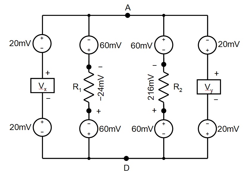

I have a simple challenge for team 'Lewin'.  But before I do so, let me summarize the results presented by Lewin in the original experiment.
The first attached figure shows a diagram of Lewin's original experiment, including the measuring setup with the measuring wires tightly placed close to the one loop ring.  R1 is 100 ohms and R2 is 900 ohms.  Assume the induced EMF is 80 mV; if we disregard the resistance of the green wires, the calculated voltage V1 is -8 mV and the calculated voltage V2 is 72 mV.  I think both team Lewin and team KVL agree on that.  Do we also agree that the left 'voltmeter' shows -8 mV for Vx and the right 'voltmeter' shows 72 mv for Vy?  Team KVL thinks that Vx=V1 and Vy=V2 because the voltage induced in the measuring wires cancels out the voltage induced in the corresponding section of the one loop ring, and KVL works just fine.  Team Lewin thinks that Vx is not equal to Vy because KVL doesn't work, so that the voltage measured between nodes A and D shows different values depending if its taken from the left or from the right.
Now consider the circuit of the second attached figure, where the original single loop ring is replaced with a three loop ring with the same diameter as the original one loop ring.  This arrangement of three loops has R1, R2, node A, and node D in the same locations as the original ring.  In the figure, the three rings are separated so it is easier to see how they relate to each other, but in reality they are tightly pack together, with virtually no gap between the three green wire loops.  Once again we have the measuring wires placed tightly close to the ring and  R1 is 100 ohms, R2 is 900 ohms, and since we have three loops now, the induced EMF is 240 mV.  This is the challenge: Calculate V1, V2, Vx, and Vy.
(An easy way of making a three loop ring is by making a one loop ring with three times the radius and then fold this bigger ring over itself three times so to end up with three concentric rings with the same radius as the original one loop ring.)

« Reply #480 on: November 28, 2021, 08:17:46 am »
It's not team 'Lewin'. It's team 'Classical Electrodynamics'.
But what's the point of the exercise?
Both 'teams' are doomed to find the same values for what is read by the voltmeters.
Anyway, if I copied it correctly - and there is no guarantee I did with all those turns making me dizzy - I would say
Vr1 = -24mV, Vr2 = +216mV
Vm1 = -136 mV, Vm2 = -56 mV
Provided I counted the 'rings' right and didn't change some sign here and there.
And if I got one sign wrong somewhere, that would proof that there can be say 200 mV in two inches of copper wire that carry a current of 100 nA?

Excellent!  You got the correct results.  Now, what is the voltage between nodes A and D, VAD?
Homer: Yeah, but faster!
I didn't find a way to make it glow, but let's see...
IT DEPENDS ON THE PATH.
No it doesn't depend on the path, because we are calculating it.  You can use either the voltage measured from the left or the voltage measured from the right to find exactly the same voltage between nodes A and D, VAD.
It's like trying to explain color to someone who is blind since birth.
I have already calculated "VAD" twice: its value depends on the path.

You have solve nothing!  For a moment I thought you knew how to solve circuits, but then you come with such a ridiculous argument.  Do you even know what a 'node' is?  Of course I was expecting you to come with some sort of excuse, but this is plainly denial!  I see now that trying to reason with you is impossible.  For everyone else reading, I'll now show how to get the solution, and how simple it is to compute the voltage between the nodes A and D, VAD, a process that was not done correctly in Lewin's presentation.
In the problem I posted above the total generated EMF is 240mV.  Using KVL we now compute the loop current as:
I = \frac{{EMF}}{{R_1  + R_2 }} = \frac{{240mV}}{{100\Omega  + 900\Omega }} = 0.240mA
Now we can compute the voltage drop in each resistor:
\begin{array}{l}
 V_2  = R_2  \cdot I = 900\Omega  \cdot 0.240mA = 216mV \\
 V_1  =  - R_1  \cdot I =  - 100\Omega  \cdot 0.240mA =  - 24mV \\
 \end{array}
To solve for Vx and Vy we need to find an equivalent circuit to work with.  We know that three wire loops are generating 240mV.  So each quarter of a loop can be lumped as a voltage source of 240mV/(3*4)=20mV.  We now notice that the '+' terminal of R1 is 3/4 loop (or a 60mV voltage source) from node 'D' and the '-' terminal of R1 is also 3/4 loop (or a 60mV voltage source)  from node 'A'.   Similarly the Vx 'voltmeter' is 1/4 loop (or a 20mV voltage source) from node 'A' and 1/4 loop (or a 20mV voltage source) from node 'D'.  The same can be said to R2 and the Vy 'voltmeter'.  Being very careful with the signs, this is the equivalent circuit we need:
To solve for Vx, we apply KVL to the left loop:
V_x  =  - 20mV - 60mV - ( - 24mV) - 60mV - 20mV =  - 136mV
To solve for Vy, we apply KVL to the right loop:
V_y  = 20mV + 60mV - 216mV + 60mV + 20mV =  - 56mV
Finally, to find VAD, we can calculate it in four different ways from the equivalent circuit above by applying KVL to each one of the four branches between nodes A and D:
\begin{array}{l}
 V_{AD}  = 20mV + ( - 136mV) + 20mV =  - 96mV \\
 V_{AD}  =  - 60mV - ( - 24mV) - 60mV =  - 96mV \\
 V_{AD}  = 60mV - 216mV + 60mV =  - 96mV \\
 V_{AD}  =  - 20mV + ( - 56mV) - 20mV =  - 96mV \\
 \end{array}
So how many values we have for VAD?  Just one: -96mV.
I assembled and tested this circuit.  The voltages I measured are V1=-24.4mV, V2=212mV, Vx=-134mV, Vy=-56mV, and VAD=-96mV, as shown in the attached oscilloscope captured images.  As you can see, the theory and the measurements are a very good match!
I know, I know:  Almost a perfect match from theoretical computations and experimental results mean nothing for team Lewin.  For everyone else, here is the evidence, once again, that KVL works perfectly for circuits under the influence of varying external magnetic fields and that Lewin did NOT get his calculations correct in his presentation because he ignored the induced voltages in the wires when he extracted the equivalent circuit.
