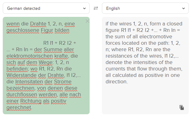

A common objection raised by KVLers is that Kirchhoff Voltage Laws was originally intended to include all forms of electromotive forces, including the nonlocalized inductive EMF. They mention the high school version of KVL that puts all EMFs on one side of the equation and all voltage drops on the other. From their point of view, considering the inductive EMF as a special case, would imply having a new law for every new kind of localized EMF in the loop. The problem is that the inductive EMF is a very special kind of EMF that is not like other forms of EMF.
If we go back to the original formulation by Kirchhoff in the 1845 Annalen der Physik und Chemie,
link https://i.postimg.cc/5tzVMxGx/screenshot-2.png
https://books.google.de/books?id=Ig8t8yIz20UC&pg=PA494&hl=de&source=gbs_toc_r&cad=3#v=onepage&q&f=false:
he indeed wrote (I am using R instead of omega to denote the resistance, and n instead of nu):
2) wenn die Drahte 1, 2, n, eine geschlossene Figur bilden
          R1 I1 + R2 I2 + ... + Rn In
= der Summe aller elektromotorischen krafte, die sich auf dem Wege: 1, 2, n befinden; wo R1, R2, Rn die Widerstande der Drahte, I1 I2,... die Intensitaten der Strome bezeichnen, von denen diese durchflossen werden, alle nach einer Richtung als positiv gerechnet.
Which translates into (bold mine)
2) if the wires 1, 2, n, form a closed figure
          R1 I1 + R2 I2 + ... + Rn In =
= the sum of all electromotive forces located on the path: 1, 2, ...n;
where R1, R2, ... Rn are the resistances of the wires, and I1 I2, ...In denote the intensities of the currents that flow through them, all calculated as positive in one direction.
Automatic translation is getting better and better every day, thanks to AI progress. Here is Google Translate's output for the original German text:
link https://i.postimg.cc/CLJMvxyX/screenshot-3.png
The locution "located on the path: 1, 2, n" points to sources of EMF located on the path itself and I have found at least one source confirming that Kirchhoff formulated his rules by using localized, lumped, forms of EMF. In his Physics Education paper "Explaining electromagnetic induction: a critical re-examination. The clinical value of history in physics" (J Roche 1987 Phys. Educ. 22 91), science historian J. Roche writes:
