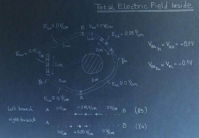

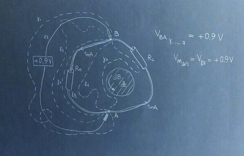

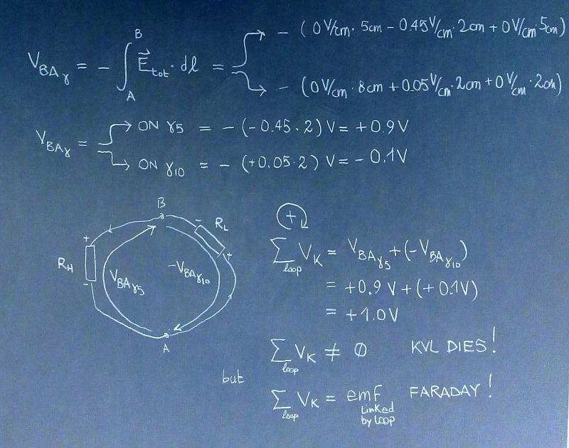

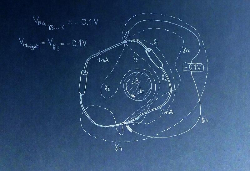

1) What is the calculated voltage between nodes A and D, VAD, in Lewin's circuit?
It.
Depends.
On.
The.
Path.
Here are a few paths for which VAD, which I call VBA, has the value +0.9V.
Among this paths there are the left circuit branch and the path composed by probes and left voltmeter.
