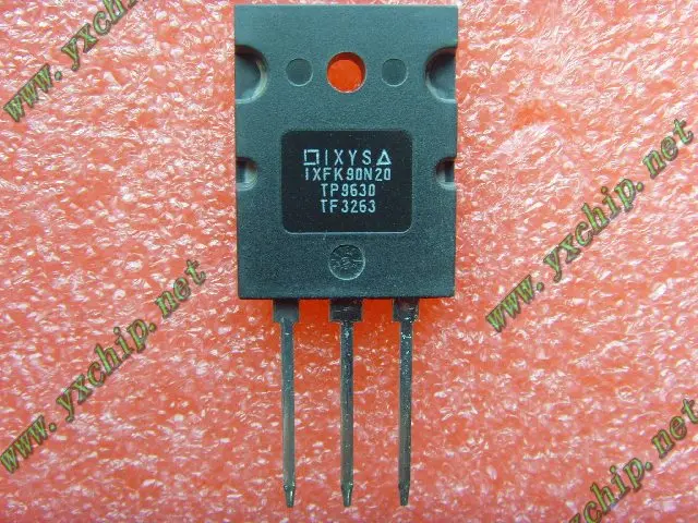

I have 4 of these TO-264 bad boy's, they're not logic level, but could his circuit be tweaked to double Vgs without mucking with the DAC?

Just measured my 4 IXFK90n20's at 24.5nF.. I think I'd need a costly PA to drive each one!! There's no free ticket is there?

using 4X 120A mosfet in a 5A dummy load is kinda nuts imho, its kinda mosfet-toss-phobic design. there will be only 1.25A max running through each mosfet and the 0.1ohm power resistor. that is 0.125V across each of the R22-25, i wish i could see those nodes probed to be certain they are not oscillating during step respond and steady state.. build a 10X or 100X amplifier if DSO is noisy.
Should not be that high. IXFK90N20Q-ND is rated 6800pF @ 25V
