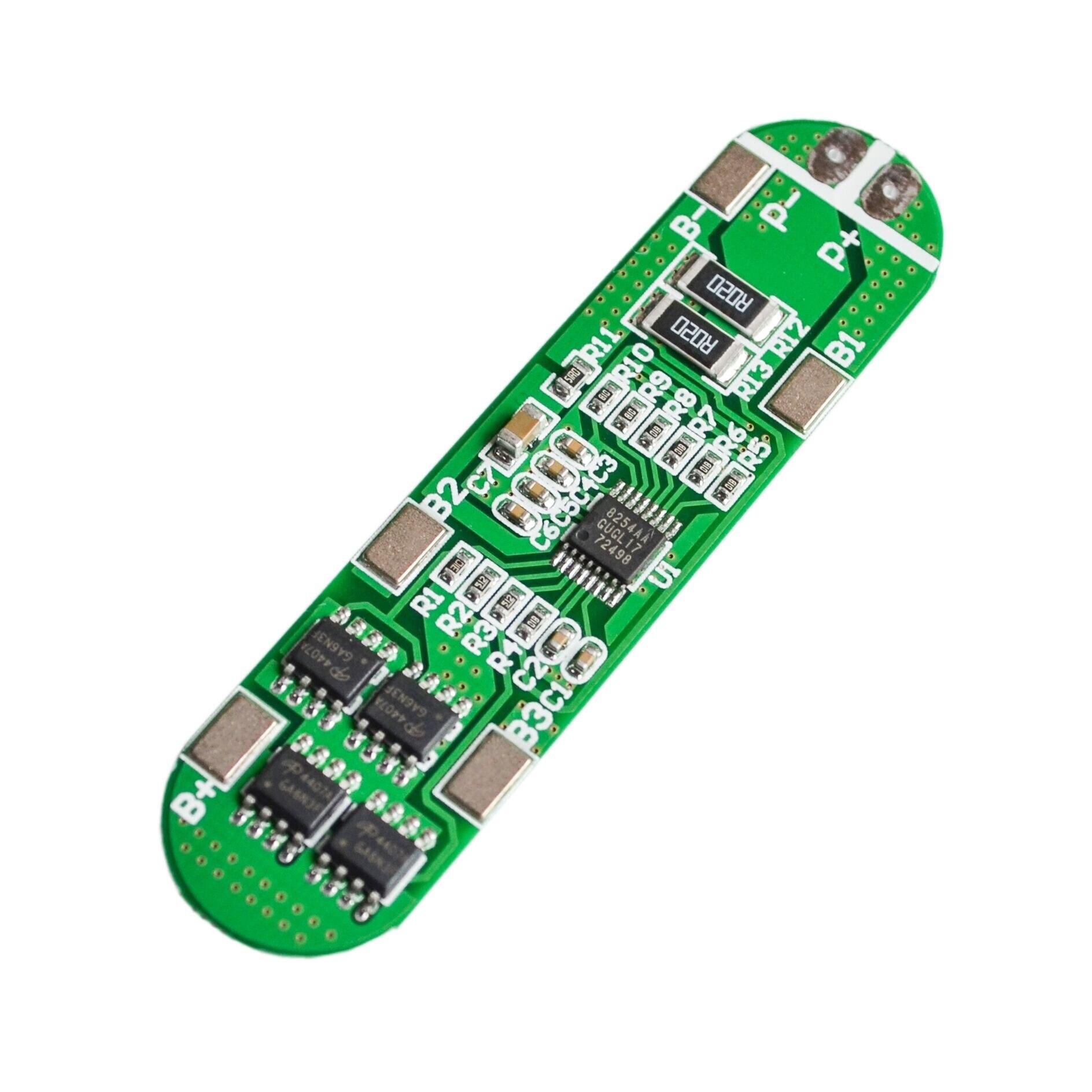

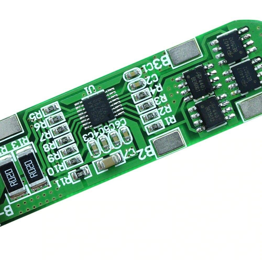

However, I hope you could help me to answer previous questions about how to determine discharge current since there is nothing in the datasheet (that i know of) that says that. I couldn't figure out how to choose and configure Rsense and so on.
I mean many BMS boards using the same 8254A IC but with different maximum current, how?
This boards may have different versions of 8254A, different Rsense and different MOSFETs. If you have some photos of this boards you might see used components. Rsense would be usually a large 2512 package or even 2 in parallel with clearly readable value on it (like R010 for 0.01 Ohm).
I wanted to know from the datasheet. I don't think mosfets are of any relation except to be powerful enough to handle the current but not to determine the maximum current itself.
See an example board here (10 amps): https://cbu01.alicdn.com/img/ibank/2017/294/031/4501130492_1344841943.jpg    -> it has 2 of R010 in parallel
another one (6 amps): https://my-live-01.slatic.net/p/af3bb4846bb0ecbb822f3087715dca0f.jpg        -> it has 2 of R020 in parallel
This one is 10 amps: https://img.joomcdn.net/5e2c6ead056818092e50dc2e871701ff131835f9_1024_1024.jpeg   --> only one R010
this one is very clear: https://images-na.ssl-images-amazon.com/images/I/71QhMB--BGL._SL1004_.jpg
it says 6 amps and has 2xR020 in parallel with 51R0 which is 51 ohms recommended value of Rvss.
thus maybe we could say this: I choose 100x2 in parallel = 50 ohms as Rvss and choose something like 0.01R as Rsense to allow 6 amps or 0.005R to allow 10 amps. both are more than enough but maybe i can go with 0.005R since it is used in the sepic pre-regulator.
^ How about this suggestion?
