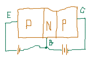

The purpose of this post is twofold.
Bipolar transistors are arguably the hardest transistor type a beginner has to study; with FETs and MOSFETs the carrier transport is unipolar and the 'pinched hose' model provides a reasonably intuitive simple model to explain how they can provide amplification. But BJTs are a little more complicated due to the interplay between drift and diffusion currents and the role played by both carrier types.
Is it possible to use the doubts a student is exposing in a seemingly naive question to teach them how a bipolar junction transistor actually works as an amplifier without delving too much (or at all, if possible) into semiconductor theory?
Here is the question:
In the following PNP transistor circuit, we know that due to forward biasing the resistance is low in the p−n part and high in n−p part due to reverse biasing. And I learnt that voltage drop in p−n part is low due to the low resistance and voltage drop in n−p part is high due to the high resistance.
https://i.postimg.cc/qvK6ZPq9/screenshot.png
(my note: a better looking picture can be found e.g. on Sedra Smith, or Millman Halkias, when they first introduce BJT)
But in the first p−n junction, the current IE is a high current and the voltage, let's say Rpn is low, so by ohm's law, voltage difference between E and B is V1=VE−VB = IE Rpn.
Similarly V2 = VE−VB = IC Rnp.
Now, how do we conclude V2 > V1?
Even though Rpn < Rnp, we have IE > IC. So there is the possibility of being V1 and V2 equal even.
Then how is it plausible to deduce V2>V1 and not the other way around?
Sorry for any misconceptions.

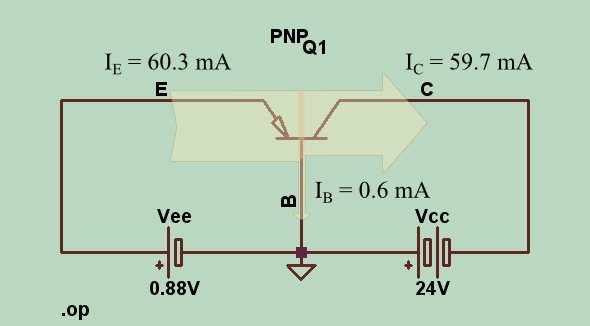

Here is the simulation of a fairly aggressive biasing using the simple default model of BJT in LTSpice. As you can see, even if  they are mathematically different due to the relation IE = IB + IC, the input current IE and the output current IC are nearly the same - the differ by roughly 1%. For this example we can infer a value of alpha = IC/IE = 59.7/60.3 = 0.99.
PNP BJT with ideal generators
The above explanation, though, is little more than a math trick because it does not actually explain why we can have basically the same current  in both the input and output meshes when the resistances encountered can be so different.

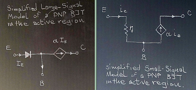

How is this 'coupling-decoupling' modeled?
The circuit under the characteristics is a large signal model for the PNP transistor drawn as a two-port: the input port sees a forward biased diode (the PN emitter junction), while the output port - with its horizontal characteristics at constant current (representing the reverse biased NP collector junction) - is modeled by a current controlled current generator.
To reiterate: the fundamental mechanism that makes it possible to have a 'transistor action' is the existence of a 'bridge phenomenon' (diffusion) that is not ordinary conduction and that allows us to disjoint the effects of conduction current in the input mesh from the effects of (roughly the same) conduction current in the output mesh.
The need for diffusion as the main transport phenomena in the middle of the transistor is also the reason why we cannot build a transistor by putting two discrete diodes back to back, but that's another story...
Similar 'bridge phenomena' can be identified in the workings of FETs and MOSFETs. In all cases it is this 'decoupling' that allows us to model a transistor (in this example for large signals, but a similar reasoning applies to the linearized small signal circuits) with controlled generators - usually in a T topology.
Large and small signal equivalent circuits of the transistor
We can turn this three terminal device into a two-port by putting one terminal in common, the base in this particular example.
And it is again the 'decoupling' between the input and output currents that allows us to either have amplification (in a CB configuration it is voltage amplification) or match impedances (the current that is paired with a large voltage in the output mesh is seen as a current paired with a small voltage in the input mesh).

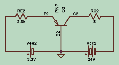

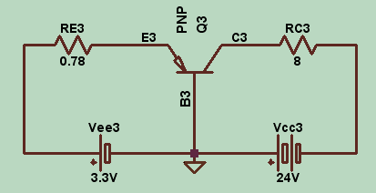

When the transistor is in active mode, the input mesh can sustain a maximum voltage,  across the transistor BE terminals, of less than 1V (typically, it's 0.7V) and the input current is strictly linked to that voltage. The output mesh, on the other hand, can sustain  the much higher voltages of a reverse biased junction, with a current that is essentially independent of that voltage.. Therefore, with an adequate supply, the output port can reach higher voltages than those provided in the input circuit. Since Ie = Ic + Ib, the current in the load will be roughly the same as that flowing in the input circuit. This simultaneous link between input and output current (they are basically the same) and decoupling of the voltages associated with such currents in the input and output meshes, is what makes amplification and impedance matching possible.
As a practical application of transistor action we can use an emitter resistor RE to 'program' the current in the input mesh, and then letting the transistor transfer it to the output where it can flow in another resistor, the load resistor RL.
How the voltage in the output mesh redistributes itself between CB junction and load resistor depends on how much voltage the current set by the input will develop across the load.
Two extreme examples are the following: in the first case we program a current of 3A in the input circuit by choosing RE = 0.78 ohm. The nearly 3A flowing in the load will result in almost all 24V of Vcc to drop across RL, and nearly nothing across the CB junction.
circuit 1: A load with big current and big voltage
Actual values for this circuit are
    VEB = 0.98 V
    VCB = - 0.45 V      IE = 2.973 A       Vload = 23.55 V
In this other circuit, where we program 1mA in the input circuit, only 8 mV will develop across the load resistor, and basically all of VCC will show up across the reverse biased CB junction.
circuit2: A load with small current and small voltage
    VEB = 0.773 V
    VCB = - 23.992 V      IE = 0.972 mA       Vload = 0.008 V @ 0.962 mA
The independence of the output current from the collector-base voltage can be easily shown by changing the value of the load resistor, without changing the 'programming' in the input mesh. For example, if in the above circuit we set RL = 10 kohm, we get nearly 10V across the load, 14V across the reverse biased collector junction,
    VEB = 0.773 V
    VCB = - 14.378 V      IE = 0.972 mA       Vload = 9.62 V @ 0.962 mA
and (with the idealized BJT model of LTSpice) the current did not even flinch.

Perhaps the common-base configuration (sketched in the question) is the easiest to explain in the hand-wavy department.
You inject current into the emitter from an outside source.
Giving the charge carriers free will, once in the base region they see a higher field attracting them to the collector region, and most decide to flow there instead of into the base contact.
The ratio IC/IE = "alpha" is slightly less than 1.  The usual current gain "beta" = IC/IB = [alpha]/(1 - [alpha]) and is reasonably large.
Transistors are actually voltage activated, but when forward-biasing the base-emitter junction by an appropriate voltage (like 0.6 to 0.7 V for silicon), the ratio of collector-lead current to base-lead current is high and roughly constant.
Although transistors are often treated as current amplifiers, the physical reality is that they are voltage-operated devices with substantial input (base) current.

Adding the B-C junction on top of the base region, and applying an appropriate voltage on the collector pin attracts most of that current to the collector pin.
That governs the collector current as a function of VBE.
From that, one calculates the transconductance dIC/dVBE
Making a less accurate assumption that the fraction of the emitter current that flows in the base lead instead of the collector lead gives the usual parameter (beta), which is not truly constant, and an estimate of the base current.
From that, one gets an estimate of the input resistance of the common-emitter circuit  dVBE/dIB.
We were taught how to reduce the dependence of our circuit on that base current, due to its wide variation.
You can get a lot of low-frequency bipolar transistor behavior from those simple assumptions.
