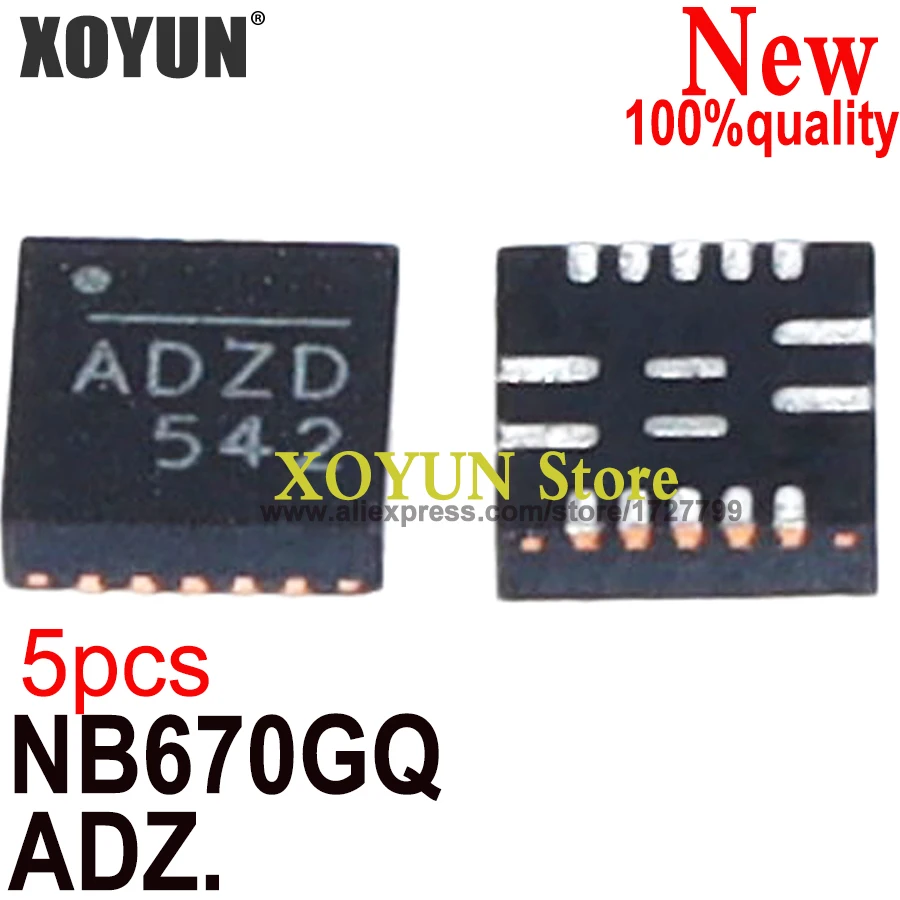

looking for information about this chip:
ADZK 949
package: QFN14 (14pins)
motherboard thomson A14-4SL64
or the motherboard schematic.

NB670, Monolithic Power, High Current Synchronous Buck Converter With LDO, 5V - 24Vin, 3.3V Fixed Vout, 6A, 3.3V 100mA LDO, marking ADZ, QFN-16:
https://www.monolithicpower.com/en/documentview/productdocument/index/version/2/document_type/Datasheet/lang/en/sku/NB670/?srsltid=AfmBOooJ_piGSpCds1OFydIhOfeYfzNCnW3Aicq3k7othW1eh3iZCoym
https://ae-pic-a1.aliexpress-media.com/kf/Sc943181d048d412aa90f511de3148206T.jpg
(photo)

Thank you for your answer.
how did you find it?
i looked everywhere....
according to the photo it's exactly that.
i'll check tomorrow....
thanks again.

If you had uploaded a photo, I would have immediately recognised the manufacturer as Monolithic Power (because of the horizontal line).
http://markingcodes.com/search/c/adz
http://markingcodes.com/search/c/adzx
https://www.google.com/search?q=filetype%3Apdf+%22absolute+maximum%22+adz+%22monolithic+power%22
Also, it helps to see a photo of the surrounding components, plus a photo of the whole PCB, to get an idea of the part's function.
