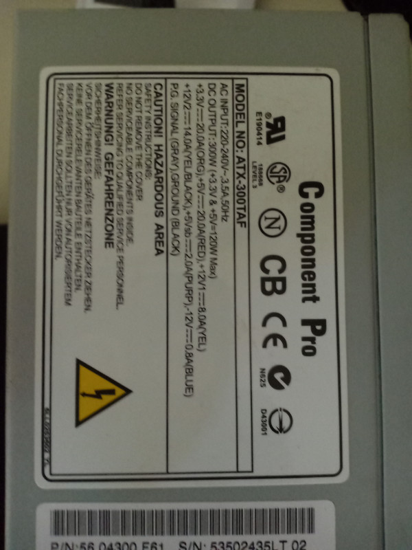

I'm currently trying to create bench power supply (for small projects) from an old ATX-PSU..
However, when I attach a load (I'm using a PS3-controller for testing purposes), I can see Voltage across it, but no current. At first I thought this was because I did not have a load-resistor across the 5V-rail. However, even after adding this resistor, I'm still not seeing any current.
I'm using a Component Pro ATX-300TAF 300W power supply that I pulled from an old PC.
Eventually (when I get it working), it's supposed to hook up to this front panel:
My current test-setup can be seen below. I've tried hooking up my USB-Port (female) to both the 5V StandBy-, and the 5V Active-Rails, to no avail.
Does anybody have any other ideas? (Or has my tinkering already destroyed this PSU?)

Update: So.. apparently I am getting current...
I can get a led to light: (Both on 5V active & 5V Sb)
(Although sometimes it seems to 'short out' & shutdown when I power it up with the led attached)
However, as soon as I attach something over USB, it doesn't actually power up.
I have tried re-soldering another USB-port (making sure to get the polarity correct, and checking that it's not shorted to the outer sleeve anywhere), to no avail.
I have tried attaching 3 different items:
- A PS3-controller. Apparently these will never charge without handshaking (see https://gaming.stackexchange.com/questions/73919/what-wall-plug-chargers-can-be-used-to-charge-ps3-controllers )
- A mobile phone (Oppo F7). As far as I know, these should charge at 500mA when not handshaking (or 1A when the datalines are shorted?)
- A cheap chinese battery charger. I'm not 100% sure, but I'd guess this doesn't require any handshaking. ( https://www.aliexpress.com/item/32957808873.html )
I currently do NOT have a load-resistor on the 5V-Line (accidentally stripped the leg off of my last 10W resistor, but I DO have one on the 12V line..
Does anybody have any idea as to what might be happening?
Do I require a handshaking-circuit to even power anything?
Edit: it appears to be shorting out sometimes even without anything attached, so I'm guessing it's at least partially broken (and I will be replacing it when I get everything up & running).. However, as I can get it to light a led, it should also be able to power the USB-charger, no? (charger runs at 2.1A max, but I was able to get it to power on a 1A usb wall-plug from a ChromeCast)

Tried a known good PSU (a Dell NPS-210AB I pulled from a NAS), and got the following results:
- Battery Charger: 0A
- Phone: 0A
- Load Resistor (10 Ohm 10W): .5A
- Go-Tcha (Pokemon Go Accessory): 150 mA
I'm guessing the top 2 REQUIRE handhaking?
Can I add a chip/circuit to do this handshaking? I'd love to be able to charge my phone at 1A+ (OEM charger is 2A) on the 5V Sb.

The "handshake" could be as simple as placing certain voltages on the data lines.
See this Stackoverflow answer, for instance:
https://electronics.stackexchange.com/a/177792/95488

So, I tried hooking up some voltage dividers to the D- and D+ -pins, according to the StackExchange-Link (2.0V on D+, 2.75 on D-), and still got nothing..
I'm done.. All other outputs (both fixed & variable voltage) work, so I'm just going to keep the USB's unplugged, I'll have to charge my devices another way.

I found this article, and it suggest something slightly different from the above SO answer:
https://www.quora.com/How-can-I-use-a-laboratory-power-supply-as-a-USB-charger
"... If your bench supply can output at least 1.5A, tie the white (D+) and green (D-) wires to either end of a small resistor, something in the 33–200 ohm range will be fine. This is the bus condition a USB device uses to detect Battery Charging mode. That specification delivers a minimum of 1.5A at 5Vdc, though a few devices can pull more. ..."
Another person replied with:
"... To signal to the device that it can draw up to 1.5A (maximum specified by the standard), short the other two wires together. Obviously make sure you set the current limit to 1.5A or above before you plug the device in. ...
I presume the D+ and D- leads should be shorted.
