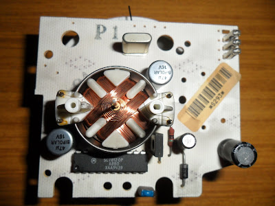

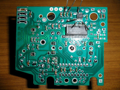

I need some help to try to calibrate a speedometer so i can change the face and put one with 260km/h.
Bigger pictures here: http://mk1tdi.blogspot.pt/2013/09/golf-mk1-gti-instrument-cluster.html
I have one from a 1.9 diesel ibiza 200km/h (1994) and one from a ibiza GTI 240 km/h (1995) found on ebay.
Both are K=3853 IMP/KM and both circuits have the same reference, only one letter and two different numbers on the vdo chip.
The 93S06 should be the chip to change the settings right?
The circuit only has 3 conections, +12v, signal and ground. The 4th is not conected on the cluster and the +12v has condensers in the circuit that i used on the new circuit and it works fine.

the same signal from the gearbox hall sensor drives odometer and speedometer, so if i modify the signal the odometer will register too much travel.
i'm a noob so all i know about electronics is by playing a little with this stuff.
the motorolla sc7812op chip is on the front
http://3.bp.blogspot.com/-gVovNBbvgkg/UjYQqt_vXlI/AAAAAAAAAsQ/ESSTZx34HTE/s1600/front_h.JPG
the 93s06 on the back maybe could have the info i need?
http://1.bp.blogspot.com/-c1a0S2ebO_A/UjYQpxwvpII/AAAAAAAAAsI/7bN2MVBChR0/s1600/back_h.JPG

Unless that eeprom stores the calibration factor i am not seeing any easy way for you to accomplish this with both the pointer and speedometer reading accuratly,
sometimes the air coil driver has a span adjustment, but i do not recognize this circuit, though i see no other purpose for that micro / eeprom on there other than that and possible an odometer reading mirror (to tell if it has been changed) read off the contents you may find the K in plain DEC,
