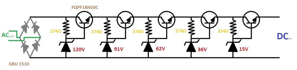

Hello everyone...
Small introduction: I am 32, i am from Greece (so English is not my primary language), i have had some very basic electronics training when i was young and my main profession is an engineer-mechanic.
I have a motorcycle (a TMracing 300EN if anyone is interested) and for the past 3 months i have been trying to build a rectifier/regulator that can handle up to 110VAC.
Long story short, after much searching and trying deferment methods (transistor Vgs limits claimed the life of many components until i found out what was going wrong) i ended up with this as a "solution":
and the actual prototype
Problem is that without load the circuit works and i get a steady DC of about 13,3V. But when i put a load on the output i get something like 1,3V but no overheating or magic smoke.
So again to make a long story short, what am i doing wrong? Are the resistances too low? Do i need to add some diodes somewhere? I am too lost to try and trouble shoot this on my own with my very limited knowledge.
p.s.
I am trying to make this first post short as short as possible. I can provide additional info about the circuit if needed.
The circuit has no capacitors, fuses, heat sinks etc, since it was build as a proof of concept and it is turned on just for a few seconds at a time.
The "DIY power supply" is crud but for the hight Voltage-power i needed (i can get about 89VDC and more than 2Aamps) is what i could afford or be able to build. Yes it can be dangerous and i DO NOT recommend someone trying.
Thank you for your time.

Looking at the pictures i noticed i had missed a line.
Now i am getting less than 10V without load... and almost nothing with one.
No overheating or sort circuit  though...
« Last Edit: July 10, 2015, 07:58:23 am by sonic22 »

You show NPN bipolar transistors in the schematic, but the part number is an N channel MOSFET and you mentioned Vgs, so are they MOSFETS or bipolars?
If they are MOSFETs then using them as a source follower in this manner (i.e. with no feedback) won't work very well.  Vgs increases with the Drain current demand, so your regulation will be extremely poor.  Vgs for a drain current of 250uA (i.e. virtualy nothing) is between 3 and 5 volts, but to get 10 Amps that's already up to ~6v and increases from that point.  There is also a strong temperature dependence.
Even if you modified the circuit to achieve reasonable regulation performance, you are quite likely to exceed the safe operating area for these devices.  Dropping around 30v on a FQPF18N50V2 means you can pass a maximum of just 1 amp continuously, and you'd be dissipating 30 Watts to do so.
Out of interest, what's wrong with the conventional SCR or MOSFET based shunt regulator that's fitted by the manufacturer?

They are N channel Mosfets (FQPF18N50)
Using only a single zener-mosfet i was able to get almost 2Amps (that is all i need) but when the input voltage got above 50V the mosfet would fry. There was a lot of energy-heat coming from the mosfet (about 130C) but with a big enough heat sink it worked.
The things i am trying to power up (a 35W incandescent headlight and some LEDs)  are not very picky about perfect regulation. Anything upwards or 11V and bellow 16V is good enough, no matter the ripple or voltage drop.
The bike is used 99% of the time during the day and off road. But i do want it to be perfectly functional without the need of batteries, especially if they need to be charged off the bike. For some unexplained reason the bikes generator (simple singlefaze, coils with a permanent magnetic rotor) is putting out too many volts (at full throttle i get above 80VAC). Normal rec/regs just get destroyed and then the entire electrical system is destroyed. MOV protection is a must, but first i need to have something that can handle the voltage. They original rec/reg costs about 90Euro and it is a joke. (i have pictures when i took them apart if anyone wants to see).
SCR circuits are my last hope but from what i have seen they are much more complicated for those voltages-power. Also i do not have a reliable ACgenerator (at least not for those voltages) and so experimenting is much more difficult.
p.s. The reason the bikes generator is suddenly putting out so much voltage (normally it should have 48VAC max) is inexplicable (i have asked professionals everywhere) and the only solution would be to change the entire electrical system witch is VERY expensive.

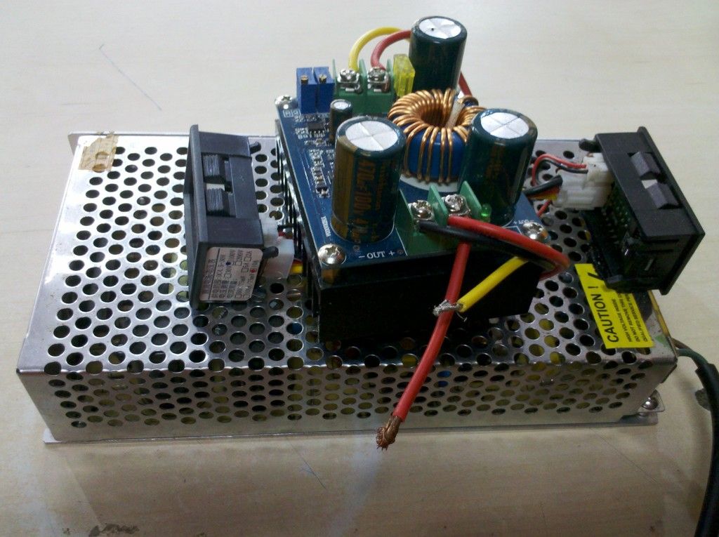

Here is my collection of " motorcycle rectifier-regulators"
3 on top are 3 phase and the 2 at the bottom are the original ones.
All of them fried immediately, all of them are zener-Thyristor (SCR) based.
That is why i am trying something different.

What is the actual input voltage under in your test conditions?  As others have mentioned these MOSFETS need a gate voltage of 6-10V to turn on fully  (looking at the data sheet Vgs=6V will get you 1 amp).   Since you have 5 of these in series you need at least 30V  in to get any output at all.   If you do have enough input voltage, with a 1 amp load the output voltage will be about 9V.  If you're trying to charge your 12V lead-acid battery you need about 14V.  I think if you measure each of the gate voltages you will get a clearer picture of what is happening.
If you had built the regulator from bi-polar transistors as it is drawn it would work better, but still have relatively poor regulation.  Either way you'd be better off with a single device and a bigger heatsink.
As others have mentioned this not the best way to accomplish this.

So i took some measurements today...
No load Vg for 60VDCinput
59,4V  16,7V   15,6V   14,4V   13,7V
with load
59,4V    4,3V     2,6V     1,1V     0,04V
Also did a diode check on the mosfets source-drain. They all conducted one way.
@mikerj nothing is conected to the stator. Only thing is that the stator has 2 single phase windings in it and i only use one of them. They are electrically isolated from each other and/or the frame. They also give out the same voltage.

So one of your first two stages isn't working as expected.  Did you measure the voltage at the connections between them?  My guess is incorrect wiring or you mixed up which zener was which.
What is your "load"?

Looking at the underside of the board, it's not obvious how the top of the first stage resistor and the MOSFET drain connect to the positive output of the bridge rectifier.  If the MOSFET gate was floating on the first stage it may explain things.

Forget MOSFET source followers with no global feedback. It will never work satisfactory.
With BJTs you can do this, when you use darlingtons you can just use one Zener and a resistor ladder.
Note: you get -2 mV/K tempco per stage, double that for darlingtons. Probably doesn't matter in this application.

You are right!
I had failed to connect the output of the bridge rec to the first mosfet Drain.
I did and now for a 89VDC input i get an output of 12,3VDC.
It is a bit lower than perfect but OK.
Voltage at the gates (@89Vdc) are now
87,6V   87,1V   68.7V   38,7V   14,8V.
Next big problem is that when i put a load on (like a 10Watt lamp) the power supply goes wanly (both current-voltage meters go out and there is a dziiit sound but nothing like when i short circuit it) and i measure about 8VDC output on the load.
The power supply can handle 10Amp @ 12V and the converter is capable of 600Watt.
Strange...
The mosfets now produce lots of heat, as expected.
Thank you everyone!
