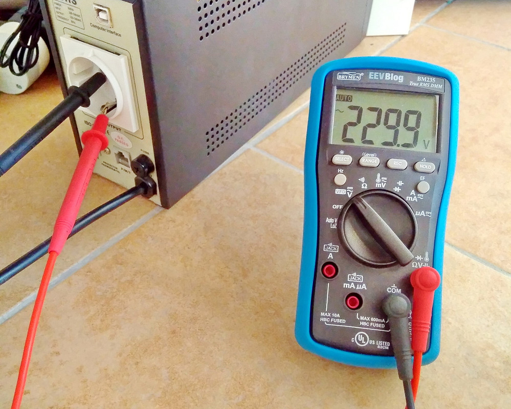

I have a Raspberry Pi plugged in a UPS which I switch off when not used.
Recently I've noticed that the power on led of the Raspberry blinks and fades
away every 5 seconds with the UPS switched off.
I measured ground to live and ground to neutral on the UPS output socket
and they show 229V!..
Is this normal?
Should I throw the UPS in the bin?
When I switch on the UPS the connected devices work normally.
I've tried to measure any leakage current to ground and the BM235 showed nothing, instead it
started showing 'DIODE' when I connect the leads..   I took off the 10A fuse and it shows no continuity!
Like its damaged. I doubt that more than 10A passed from live to ground on a switched off UPS.
The fuse looks new, no explosion were heard, no sparks were seen.   :)
How is this possible ?   :-//
Thanks.

Offline hggTopic starter
  • Posts: 960
  • Country: gr
"In other words, devices are meant to be plugged into it when it is switched on, not when it is switched off"
I understand.  The UPS has a switch off though and I have not read anywhere that you should not switch it off
with the devices plugged in.
"(Under no circumstances should you ever connect a DMM to a power output socket while the DMM is set to measure current.)"
Maybe you did not understand.
I connected the DMM between live and ground to see if there was any leakage current.
Is there a capacitor connected between live and ground inside the UPS?

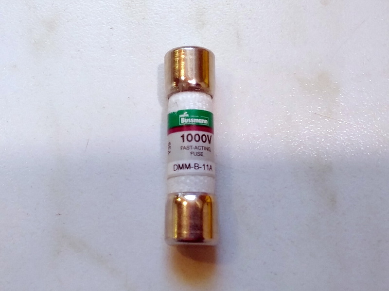

  • Posts: 960
  • Country: gr
I did not expect to be any current though with the UPS switched off.
That fuse is a beast.  I had a very hard time breaking it open with pliers!
Maybe that is why it was so quite.  The only thing I can see is some
black grains.
Is there any remote possibility that this would be genuine ?
https://www.ebay.com/itm/Bussmann-DMM-B-11A-1000V-DMM-11A-Multimeter-Fuse-for-Fluke-87-V-88-V-287-289-179/261536107575
« Last Edit: March 05, 2019, 04:35:21 pm by hgg »

  • Country: gr
UPS OFF
Ground - Live : 230V
Ground - Neutral : 230V
Live - Neutral : 0V
I've connected an incandescent bulb between live and ground and the house RCD tripped.
The UPS does not isolate mains when switched off but it cannot also power anything from
live to neutral.  I have two devices connected.  A 3D printer power supply which is earthed
and the Raspberry Pi with its power adapter which is not earthed.  The Raspberry power
ON LED switches on and fades off every 5 seconds, only when one of its USB ports is connected
to the grounded 3D printer.  So it looks like its a kind of grounding issue.
I think I will include a main power switch as well.

Offline Johnny B Good
  • Posts: 867
UPS OFF
Live - Neutral : 0V
 That sounds suspiciously like a Y cap issue with the wallwart providing 'half live' leakage current that slowly charges a smoothing cap on the RPi's 5 or 3.3 v rail until there's enough to trigger an on board voltage regulator (buck switching type?) into life to provide a pulse to drive the LED which then discharges the smoothing cap and the cycle repeats over and over (the classic relaxation oscillator effect).
 With most (likely all) line interactive UPSes, only the Live output is switched from the incoming mains across to the inverter output. The earth and neutral remain connected with the neutral side of the inverter output bonded to the incoming neutral (which is crossbonded in the mains supply wiring to the earth either at the consumer unit or even as far back as the sub-station (or pole transformer or whatever).
 There's normally a 'disable switch' on a UPS so that when the protected load(s) are switched off, you can still keep the battery pack float charged without risking a pointless discharge of the battery in the event of an outage during times when backup power isn't being called for (and also when you want to move the UPS from one location to another or even put it into temporary storage or transport it across town or county from one location to another - longer term storage requires removal/disconnection of the battery pack).
 Bearing the fact of the single pole changeover switching in the UPS, it's extremely important that you don't reverse the Live and Neutral connection to the mains supply. The better Line Interactive UPSes actually incorporate mains polarity connection fault detection LEDs to warn of such problems. If you have the Live/neutral reversed, this could readily account for the winking LED via the Y cap in the RPis's smpsu wallwart.
John
The following users thanked this post: hgg
Offline viperidae
  • Posts: 306
Could be the ups is only switching the neutral line. That would explain the voltages.
