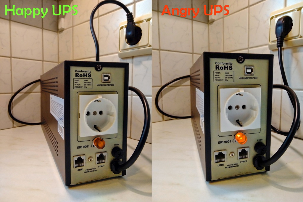

Offline hggTopic starter
  • Posts: 960
  • Country: gr
johnkenyon   Thank you for the idea.   :-+
The UPS already had a covered hole with the exact diameter of a mains neon indicator...  :)
This is how it was meant to be made...
