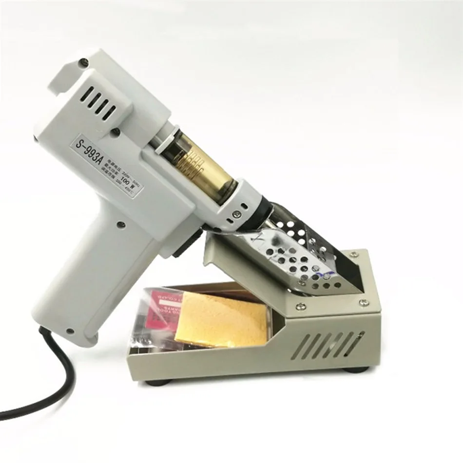

Hello,
i'm looking for advice for cheap and decent desoldering pump. currently looking at S993 and proskit SS-331H.
they are about the same price, proskit have dedicated station which should be easier to repair.
anyone have any experience with this ?
thank you

The first one looks like a re-hashed ZD985 and some say the other one sucks...  :-DD

For a really decent hand operated desolder pump, I'd suggest an Engineer SS-02 (when there aren't enough joints to crank up a powered unit).
Between the Pro's Kit SS-331H and the S993, I'd opt for the Pro's Kit as it's handle is separate from the pump (much easier to manipulate). Or a Zhongdi ZD-985 or equivalent unit (FWIW, I suspect the Pro's Kit unit is better built).
Now if you're doing a lot of desoldering, I'd suggest saving up and getting a proper desoldering station from a known brand such as Pace (they invented desoldering stations, and still reign in that arena IMHO). Seriously, there'd be a huge difference between one of their stations and say the Pro's Kit. Less clogging and much easier to use (= drastically better user experience).

I bought 2nd one in your pictures about 3 years back and its still working good for me, I never had any experience with some branded/expensive one that's why not sure about difference.

$100 for 3 years and still working is a good investment.
well, i might go for proskit, also look nicer on the bench  :-+
will i need extra glass tube ? it seems they offer variety of parts ( tips, filter, tube, heating element)

I have a S-993A that I got very cheap from Aliexpress using some discount coupons and although I don't use it very often, it does the job well. I like it because it's compact and don't take to much space on my workbench and the metal stand is very sturdy too. I can't say much about its durability as mine is relatively new, but one problem I see with this model is the lack of replacement parts, there's only a few sellers offering it on ebay or aliexpress and they are kind of expensive comparing with the price of the whole unit.
But it's definitely an improvement from the use of a manual pump and I don't regret that I bought one. Here in Brazil is very common to use a peace of silicone tube attached to tip of the sucking pump, it helps improve the suction, (here we call it a "tip protector" or as it is popularly known "condom" and it is sold in electronics parts shops and costs just a few cents). You could try it and see if it solves your problem, but if you decide go for the S-993a I would recommend that you get the full kit with the spare tips and heating element.
