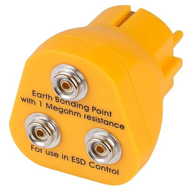

  • Earth bounding point - The plug type are the ones I prefer because of their portability, but some people don't recommend such kinds and I would like to understand the reason.
    I found two types. The first one is the more common and expensive while the second one is half the price (can't understand the differences):
    Or (even better?), a direct connection with the grounding cable:
    I also found this adapter in many setups, but I suppose the only difference is the ability to use more wrist straps and keep the pluggability below the table, right?

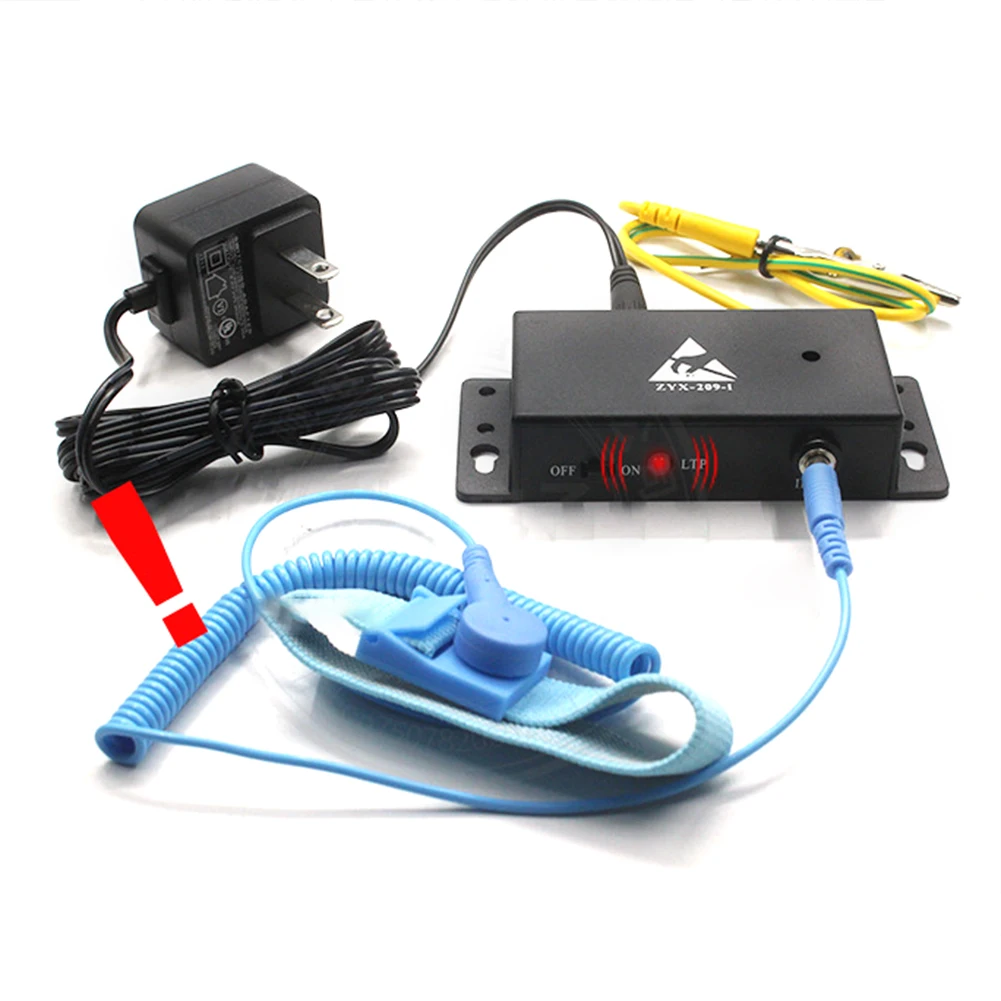

  • Continuous monitor (or whatever they call it) - To control the antistatic wristband in real time and monitor the whole grounding system in real time. It detect and warn where there is an abnormal status in the ESD area. Such devices are expensive, but there are also cheaper alternatives.
    This can be found on AE for less than $10 while there is another one sold from hisco for $36 (to me they both seems to do the same):

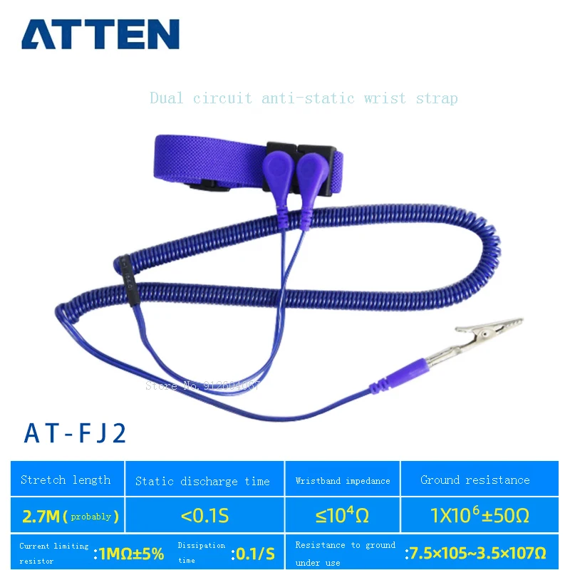

  • Antistatic gloves? - I saw most of the people with similar ESD workstations working with bare hands. So, I'm wondering if their usage is useless.

If it helps to make a decision, I use the yellow style earth bonding plug at home (the same sources will sell those if you need that too), although the version I have got has one snap fastener location, and two banana sockets, which was a convenient mix for me.
Regarding wrist strap, I have no recommendation. I have tried a few, and the all-metal ones bite on arm-hairs : ( so usually end up using the fabric ones.
The two banana sockets are only needed to connect two mats, right? There's a thing that made me confused: they are available with or without resistance. I'm correct to assume that the ones with resistance are only for the wrist straps that does not have the built in 1MΩ resistance? Because at this point any cheap adapter could be fine if I just cut the right and left pins, right?
Yes, the all-metal ones bite on arm-hairs and they are useless. The regular ones can be just put on and taken off with the same speed once they are regulated to the size of the wrist.

Regarding the plug, all the connections do not need to be used, some can be left spare. Some soldering stations will also provide an earthing banana socket. Personally, I just trust the earth connection is good. In other countries/locations/electrical systems perhaps that is not the case (consult an electrician if you're unsure for your location), and in offices/labs it would be tested regularly I'm sure.
If I have understood well, you're saying that whether I use an adapter (with or without built in 1M resistance) or not, the only needed thing is the wrist strap end point attached to the pin ground of the wall socket.
When you say "I just trust the earth connection is good" you mean the electrical system of your house and not the ESD mat system, right? If so, I should be in the same boat since the electrical system has been renewed less than 10 years ago. However I still don't feel safe. What if something breaks in the home electrical system (or in the ESD system)? Or another device discharge to the ground while I'm connected to the mat? You don't have such concerns?

If your home electrical system is good, it's over-worrying if you think the ground connection will cause an electric shock risk. You'd feel it first with any metal appliance, e.g., a kettle. Even if there was a fault, you're protected to a degree through a 1 Megohm resistor inside the earth bonding plug.
The bare minimum you need is a mat, wrist strap, earth bonding plug (if your soldering station doesn't have an earthing point built-in), and that's it (those things should come with cables, I believe; otherwise, purchase a cable, too). You could add other things, such as ESD floor mats, etc., but I don't, so I have no comment/opinion either way on that.

Monitoring seems like massive overkill to me unless you're building man rated flight hardware, high reliability medical devices, etc. Not sure what the first is doing but the second more expensive device appears to be a $5 outlet tester (which are far from infallible) with an added earth jack, run right between live and neutral?
I don't think Eleshop's kit has that 1 Mohm extra resistor. The mat itself should have quite a lot of resistance (1 Mohm - 1 Gohm), and should discharge any potential quite slowly, avoiding any spark and damage. But if you want to have it, please feel free to do so.
I rather prefer having that connector under the table, next to me, than where the guy in the video puts it, near the wall. I think that way a)it will impair their movements too much, and b) it will be sweeping his work surface with each movement of his right hand. I have the connector on my left. No way I'm going to connect it to my ankle, I would have to fold my back each time I need to go far from the ESD place and then again when I come back. But, probably his backbone is in better condition than mine.

OK! No cable directly connected to a plug in the wall, but a member of the community does not recommends socket adapters because banana plugs do not fit securely in AC outlets and I suppose he refers to the yellow ones (the most diffused). How I can avoid such risk? I will try to find the adapter below, it should be much cheaper, but I doubt it has a resistor. The yellow ones are very expensive.
So, adding an extra resistor could not be needed if the mat is "1 Mohm - 1 Gohm" (I will ensure that). If not, adding another one is recommended as an extra level of protection (for my body and the system itself). Is it safe multiple resistors? The values will become altered, is still safe?
If I will end up buying an extra resistor separately, I have the option to choose a larger one (and I suppose would be better). What is the maximum range I should stay within?
Yes, BrokenYugo, a monitoring system may sound overkill, but without it I'm still unable to identify failures or abnormal ESD status (unless I continuosly check with a DMM). The only reason for which I decided it's worth is because I found one very cheap.
Eleshop's ESD starting kit was good enough for me. It has all you'll need for ESD, and for 40 € it seemed good enough to me. It doesn't have the intermediate banana station, but it has a plug with conector. That plug gets into a jack strip screwed under the table. In turn, that jack strip -and others- get plugged into the surge protection strip. YMMV.

However, correct me if I'm wrong, unlike the continuos monitor I'm going to buy, I see at least 2 flaws:
  • You have to constantly keep your eyes on the ground LED to detect in time any abnormal status. The CM emits a sound alarm when this happens
  • To me seems it only checks the ground generically without taking into account ESD parameters (the CM also allows parameter customization)

You show a consistent 1 megaohm resistance.  Think that might be its because it is intended?
Absolutely! I just posted the pictures to show people what not to do!! Yes JustMeHere, I was not sure on the material of the two objects, so I wanted to test the connection with the wrist strap.
That, and the Eleshop ESD starter kit previously linked, is all I have. The yellow plug takes the cable connection from your arm/wrist, and another one from the ESD mat, and there is still a spare one for some other connection. Live/neutral plugs are plastic, only the grounding part is for real. You'll not be attached to any mains-connected plug and very little to no at all possibility to have your gronding cable getting loose and suddenly touching anything live.
if the ground LED on that socket strip turns on, it means ground connection has < 10 ohm resistance. No one of these contraptions will get less resistance than that.
BTW guys, you don't want a low resistance to ground.  You want something that can bleed off any extra electrons but that's it.  If the wrist strap is directly connect to ground with low resistance, then you become a conductor.  Touch something charged with your other hand and zap.  You just passed a current across your chest
Would you hold an AC radio in your hands while standing in a bath tub?  Well, when you connect yourself directly to ground without any resistance, you're basically doing the same thing.
Just to make it clear, I didn't mean having a < 10 ohm connection between your body and earth. Wrist wrap and mat will have much more resistance than that. What I did meant is a good electrical installation ground / protective earth should have < 10 ohm, or at least I think it is what the law says here, and what will cause the ground LED on that socket strip to turn on, IIRC. I trust that LED because, otherwise, Ubiquiti antennas die so easily.
Ok guys, let me see if I have interpreted well all of your recommendations. These are all the items I found and how the final puzzle should look:
My concerns:
  • In such configuration the only resistor is the one inside the wrist strap (1 megaohm), so I want to add another one. I found two types (SMD and regular). I'm a little confused. They are sold as a kit of 100 pcs with selectable resistance. I'm not sure if I'll receive 100 identical resistors with the selected resistance value or a combination. What should I buy?
  • Where I'm supposed to solder the extra resistor?
  • The yellow ground wire seems to be a banana plug and I'm not sure fits the white socket adapter. To the left you can see the front side, to the right how looks the ground wire sold separately.
Thanks again
Offline shabaz
  • Posts: 942
That link that tatel provided contains an earth bonding plug with built-in 1 Mohm resistor, according to the description there.
No need to add another 1 Mohm resistor.
The antistat website has an instruction sheet, I've attached a screenshot, showing how things get assembled. Nice and simple. You could insert your checking device but if it were me, I don't see the need for it (it's up to you).
The following users thanked this post: YouCanDoIt

Such earth bounding plug does not have a resistor, so I must add one, but I have no idea on the correct value and where should be soldered.
Anyway, the above part is the easiest one. At worst I will just need an adapter for the banana jack and I can't certainly consider a problem the soldering of a resistor.

My wrist strap is different from the one I see in your diagram. Mine it is the same of my diagram (the blue one). The one in your diagram is connected to the mat through a 10 mm stud. The bundled wire of my bracelet starts with one 10 mm stud (which goes on the top of the bracelet) and ends with an alligator clip (which can be detached to expose its internal banana jack). May be I need a dual circuit wrist strap?
