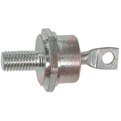

what components are you using that are rated for 100 amps and dont come with a stud bolt mount?
even diode bridges past 50 amps come with screw mount studs. If you have components that use screws, get a bus bar, properly attach it to a thick wire, put a thermostat into the bus bar (screw it on) and use that I guess. And put touch safety stuff.
And like someone already said you might want to get 2 power supplies like the guy said, a lower current one (say a 10A one) to catch obvious failures without explosions or worry that a circuit safety will malfunction to increase your safety factor. Ramp that one slowly to 10A then ramp the big one slowly to 100A
